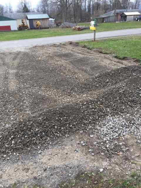

It was a balmy 63* here today...
so we fixed our driveway. Added a lane making it three cars wide. 6 cars, 5 drivers and winter is coming...

6 cars !!! :o That’s not a driveway , it’s a Dealership ..... hahahaha 8)
