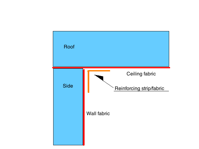

Its just a little more difficult to do upright ... One suggestion might be a light spray of a foam safe contact cement instead of the T2 to adhere the ceiling fabric... Just a light spray on both surfaces , give it a few minutes and stick it up ..Thats the way headliners in cars are done... Paint will secure it better once applied...
Gluing fabric overhead with the T2, you'll have to keep checking that the material adheres evenly and doesn't sag , a small roller may help!!! Now I tried T3 and it "grabs" Very quickly ... another ceiling option...

Postby GPW » Wed Mar 30, 2011 8:12 am
Eagle I plan on covering the inside of all the parts before assembly ... Here's a drawing with the fabric extended full width and then glued ... The Foam won't care if there's a piece of fabric between the joins...
Postby eaglesdare » Wed Mar 30, 2011 8:27 am
exactly gpw!
that is the way to do it. i just did not have the time, nor the proper weather. and i think it would make an even better hold. i mentioned earlier about the hot glue on canvas to canvas. same idea with t2 canvas to t2 canvas, or gorilla glue. but i think the hold will be stronger.
i highly recommend doing it like that.
my second build will be done like that. and the good thing about doing it like that, you can work in the house, modular. then assemble all pieces outside.
