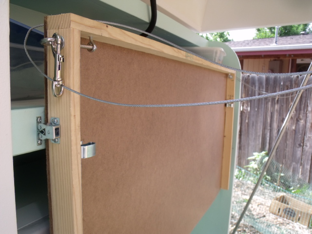

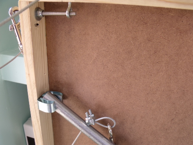

I installed door latchs to keep the shelf up for transit.
door latch
And then I installed broom handle clamps to hold the prop rods in place during transit.
Broom handle clamp
George.

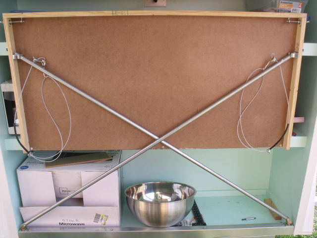

Postby ghcoe » Tue Jun 06, 2017 8:25 pm
Shelf up, prop rods stowed....
Shelf stowed
Ready to go :thumbsup:
Ready to go
George.

For a little finishing detail that will extend the life of your wire cables, consider adding wire rope thimbles. They help maintain a minimum radius and keep the cable rope from kinking at the bend point in the eyelet loop.
For light duty applications such as yours, I sometimes prefer the crimp style sleeve instead of the cable clamps. The small ones for 1/16 dia wire can be crimped with a std set of wire crimpers intended for non-insulated terminals (the kind with a dimpling die on one side). Trim the tag end with a small cut off wheel in the Dremel and sheath with electrical shrink wrap.
Thanks KC, I looked at those, but was not sure if this was even going to work yet or not. Might redo it this way. Probably would look better for sure.

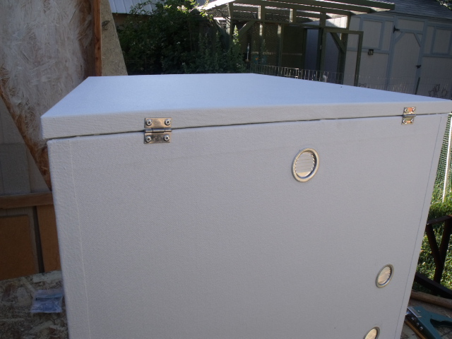

Been a very busy last few weeks. I have not even had time to post up some pictures so figured since I have a little time now I'll post some up.
I finished painting the battery box. Next was hinges and reinstalling the vents.
Battery box
Next was mounting it back onto the trailer tongue. I was able to get most of the wiring redone too.
Battery box mounted
George.
