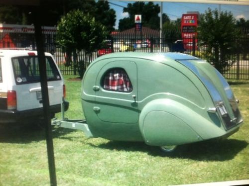

OK, adjust your drool cups ..... Check this out , it’s a fiberglass kit on Flea bay , but I’d bet it would be possible to make one from foam too ... :o

GPW wrote:OK, adjust your drool cups ..... Check this out , it’s a fiberglass kit on Flea bay , but I’d bet it would be possible to make one from foam too ... :o
A bill block of foam and a sureform file.

The Link ... http://www.ebay.com/itm/AEROLUX-ART-DEC ... 2268298592
Wolf , yeah , that’s what I was thinking , or even doing like Rowerwet does and glue sections together and sand ... Sure is a Cute trailer huh !!! JMHO FWIW ... :roll:

From the seller's blog page (http://aeroluxtrailer.blogspot.com/) - "A note to copycats, The Aerolux trailer name and the body design are intellectually protected.
Infringements will be vigilantly prosecuted."
But it wouldn't take much to come up with your own variation on a similarly shapely shape. I don't think anyone can lay claim to the concept of a body kit, or rounded shapes.
Just saying for the record.
Although there appear to have been at least three of these built, the blog provides surprisingly little details, and shows big gaps between inception and following entries.
Still, it makes a very neat looking 8 ft camper (maybe 8ft 5inch... blog states 8ft but states that the profile hangs off of the back of the chassis by 3inches, then the chassis sketch shows 98inches long, not 96).
Thanks for sharing.

Yes , I only liked the shape ( pretty picture ) ... Thought that would be able to be done with Foam ... ( sorta’ ‘ish ) Just a thought for some new ideas , as we tend to produce nice “Boxes “ around here ... :roll:
Sorry , I’m not much for Kits ... More fun building from scratch , and since we’re not in a business , who cares , but us anyway ... :D
