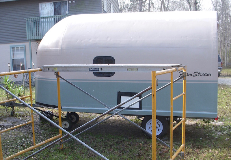

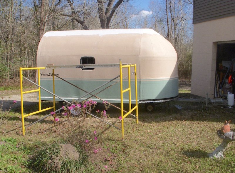

Postby GPW » Mon Jan 30, 2017 7:55 am
Dear Folks, One of the only problem that plagues my foamie is that nasty green mold that grows on the surface , and your really have to scrub to get it off ... Today ,I’m going to try something else we saw on the ‘net .... Hydrogen Peroxide.... It’s supposed to actually Kill the mold , bleach only makes it clear and invisible , cleans it but doesn’t kill it ... So we’re going to buy some , put it in a spray bottle and see how that works ... Worse comes to worse , we can always use bleach to make it look good again and then the Peroxide to kill the remaining mold which may come back .... it sure does in our warm Humid climate ... :duh:
We tried the other mold remediation products , but they are expensive and you still have to use bleach , as stated on the labels .... AARGH !!! :frightened:
You guys and ladies of course, have any secrets ???

Postby GPW » Tue Jan 31, 2017 7:37 am
Thanks for the warnings !!! We only mix it with water to use in the pump sprayer ...
We did get some Hydrogen Peroxide ( it was cheap ) , and tried a sample sprayed on the FS...
Re: Thrifty Alternatives ..Building Foam Campers
Postby GPW » Wed Feb 01, 2017 12:03 pm
Cleaning Report : Well, the Hydrogen Peroxide was a bit disappointing in the cleaning dept... it wouldn’t get the mold stains off, yet removed the green part of the mold .. So we resorted to the old 50-50 Clorox and water to take everythig off .... Now that it’s really clean, I see we won’t have to re- paint the whole thing again .... the paint is still in good shape underneath ... Just the roof part and a few touch up areas need to be done .... PLus adding some small patches where the Fire ants ate through the bottom ( ants visible in my Azaleas ... grrrrr!!!!) The makeshift drip edge on the front is still working like a Champ ...The Gorilla tape still stuck fast and the trailer bottom is dry ... :thumbsup: And the funny thing is the side that’s sat in the Sun has all but healed the dents my helper put in there working on the roof .... on the shadow side ... still dented ... we’ll fix that by turning it around for a while .... And it’s not even Summer yet ... ;) Once that summer sun/heat happens it’ll all be nice and tight again ... :beer:
