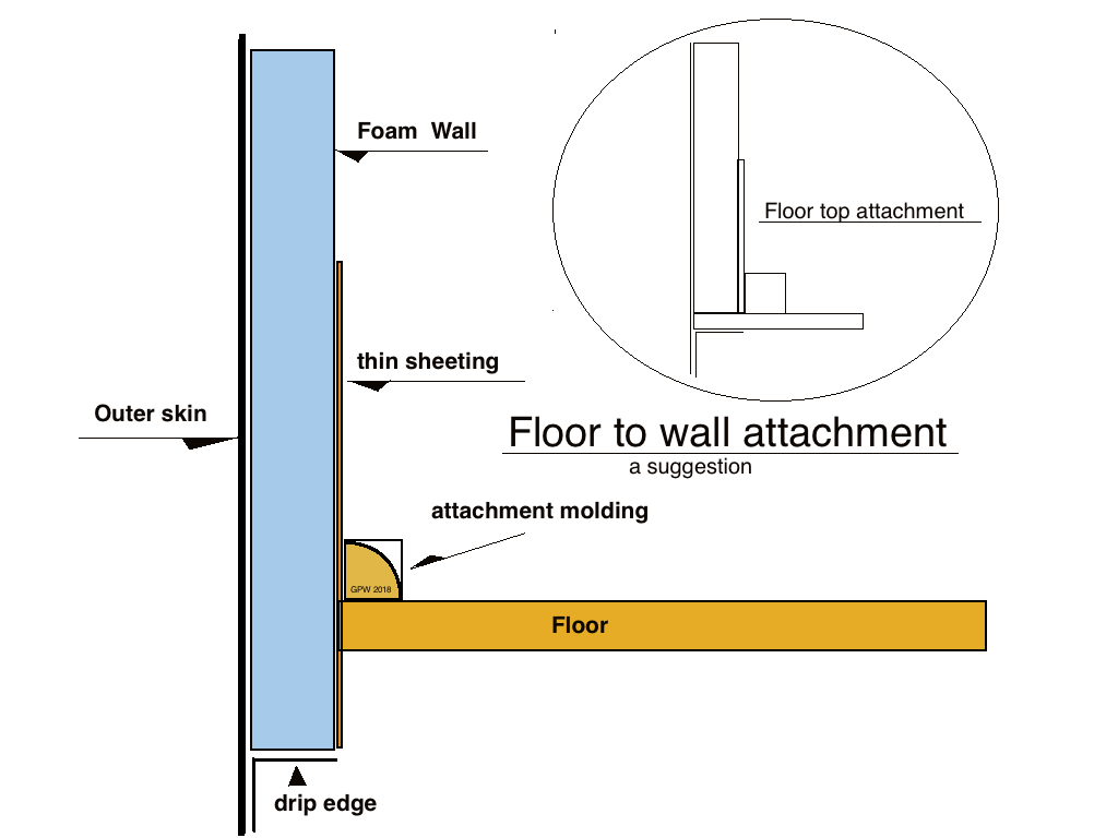

“ I really like the idea of wrapping the side canvas around and under the floor as a way to keep the sides attached to the floor. “ One little point , as we found from experience , if you do wrap the canvas around under the floor , make darn sure it’s Completely WATERPROOF … or provide some sort of drip edge to keep any moisture off the underside . Just the morning dew alone will drip down and find it’s way into the smallest of spaces that are not completely protected … ( ask me how I know ) :duh:
And while we’re attaching things , you know to date there hasn’t been even one incident of a Foam cabin separating from a trailer floor …. not without a Sawzall… ;) Just sayin’ …
If we’re looking for a better way to attach the wall to the floor , I’m sure we can find a way that doesn’t depend on any outer covering for attachment strength … Since we all now accept some lightweight framing inside , it becomes easy to add some inner wall to floor attachment structure …
Not being able to resist making a drawing , here’s just one idea ...
Floor to wall .png (50.61 KiB) Viewed 1759 times
Re: Thrifty Alternatives ..Building Foam Campers
Postby GPW » Tue Nov 13, 2018 6:38 am
… and then you could even work out some slots and tabs for “interlocking” assembly ... :thinking:

Postby Pmullen503 » Tue Nov 13, 2018 2:24 pm
GPW wrote:… and then you could even work out some slots and tabs for “interlocking” assembly ... :thinking:
I like the "thin sheeting", something like 1/8" plywood glued to the foam to spread out the forces. Add some biscuits or splines to tie it into the floor and I think that would be a very strong system.
RE: drip edge, I need to do that on mine as water crawls around the edge and it sits between the frame and floor. I was thinking wood triangle stock around the perimeter with another piece of PMF wrapped around it going about a foot up the wall. Then just a paint line to camoflage the joint.
