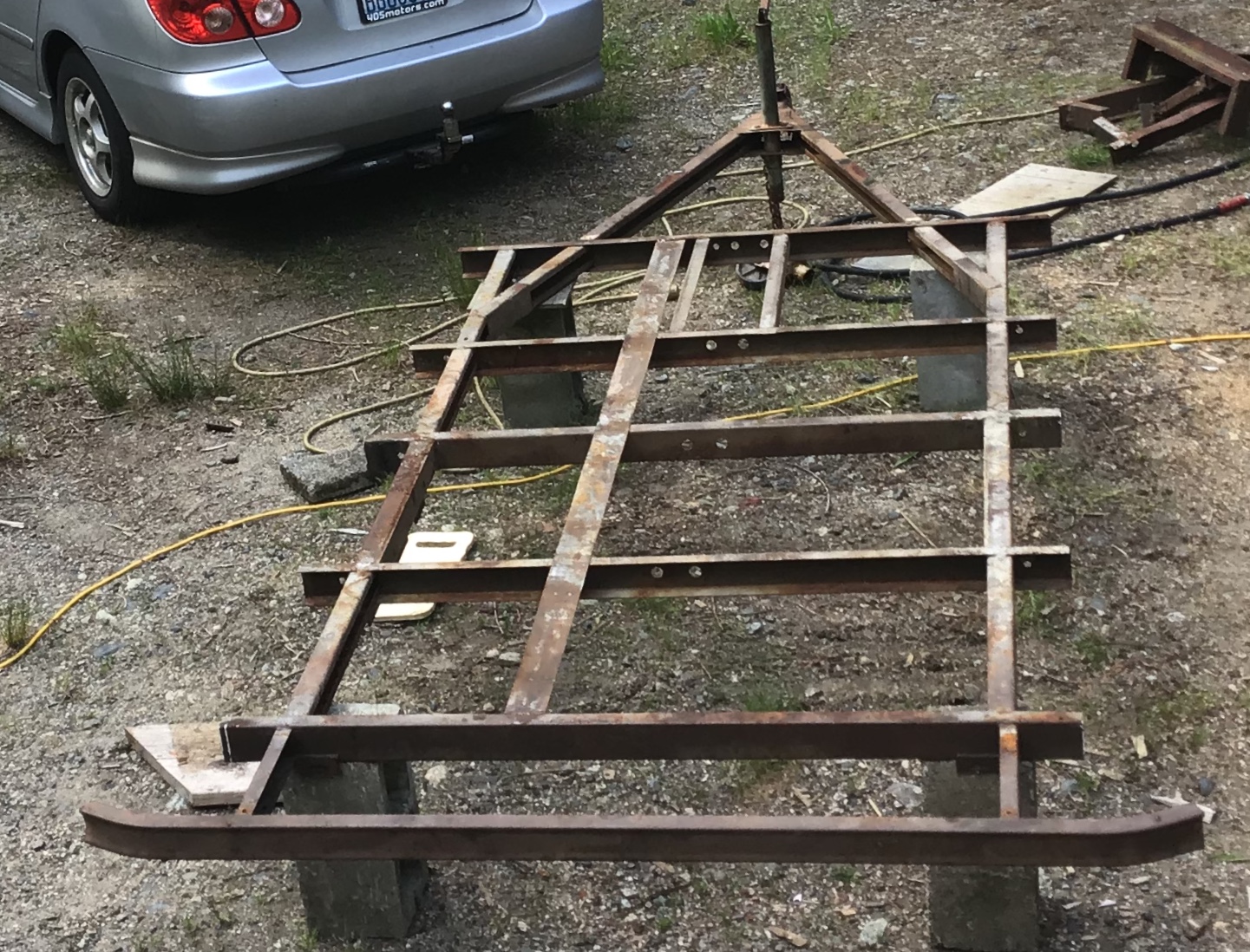

Well, the stripped Jayco seems to be about 330 lbs. with 20% on the tongue. Heavier than I'd hoped, but less than it could be. There's a LONG way to go.

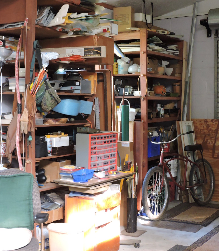

330 lbs. That’s not that bad at all !!! And JMHO , I don’t believe anybody needs a 3/4” plywood floor … We recently installed a wooden Board floor on the FoamStream , and I like it a lot … I was considering some Cedar fence boards for a lightweight floor … especially if attached to all that metal trailer frame … That is unless you’re going to dance and jump up and down on it … :o
I recently ( last week) bought some cheap 3/4” ply for a shelf project ( on the right) and I swear it must have been~ 80 lbs… I could barely move a sheet around by myself ... :R I still don’t like plywood for floors … Just me ...

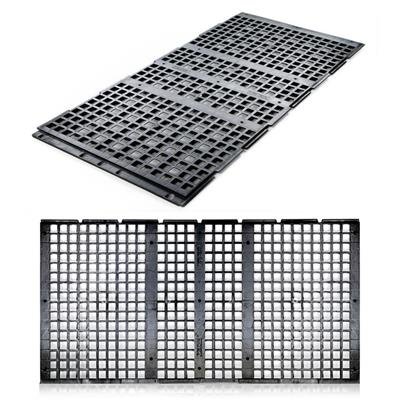

Want to try one day, greenhouse plastic bench panels.
Can be filled with pourable 2-part foam for insulation and canvassed foamie-style for greater rigidity (tensile), protect the plastic from chipping.
Underside maybe epoxied, and/or a sheet of luan?
Needs cross beams on 18" or 24" centers depending on brand, design so the aluminum profiles supporting do not protrude higher than the top surface of the bench material.
Super light for load-bearing strength, which will be spread also by the mattress above, maybe also a lino layer?

That plastic grid looks interesting.

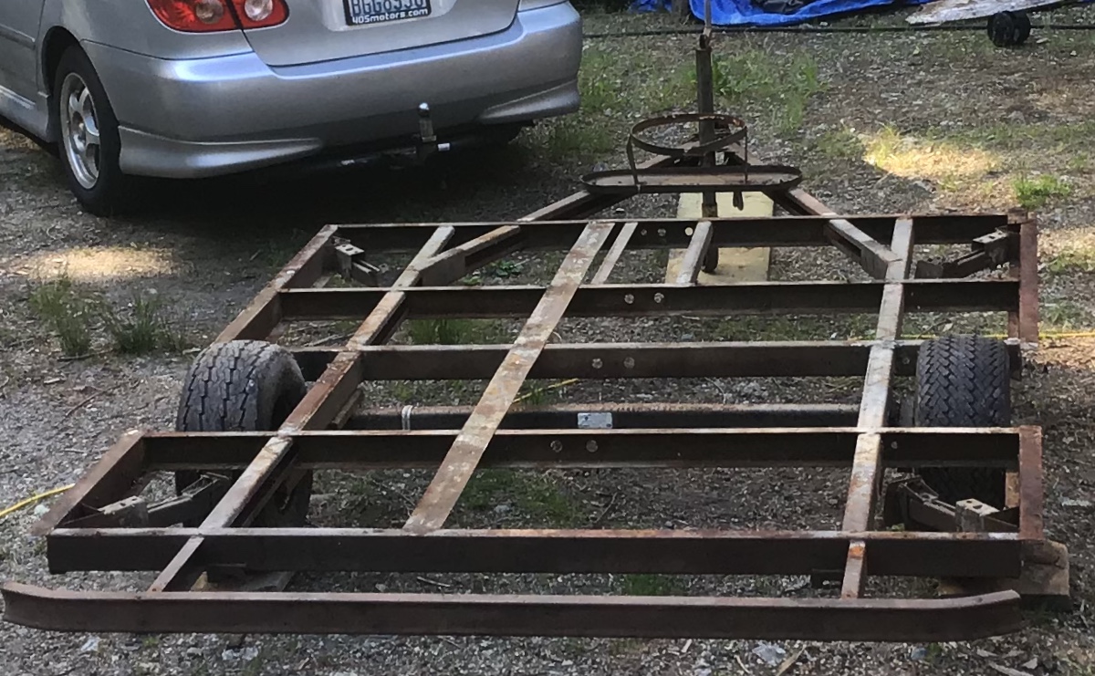

Looking at that Jayco frame, I'm not sure how skimpy I can go, and still be able to safely haul a riding mower or similar load. There are some pretty good gaps. BTW, that off center flat strip running the length of the frame is not structural. It's just Jayco's joining point for standard width pieces of plywood floor.

Ham , With all thst crossbracing I’d think a foam and thin ply floor would work … There is the wall to floor attachment issue …. I’m sure we’ll get to that shortly … :thinking:

I’m narrowing the frame to match the foamie I plan, will lengthen a bit before I’m done. New axle will go where the old one was, but wheels will be farther apart. Tonight I confirmed that the foamie “pod” I plan will fit into my F250, if the tailgate is down and I support it higher than the fender wells in the bed.
