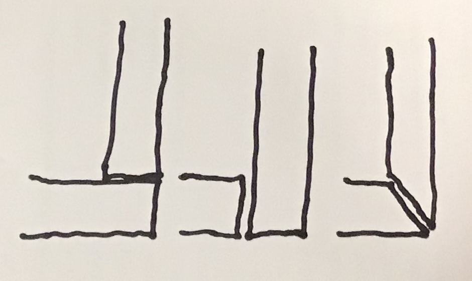

Postby pchast » Sat Jun 29, 2019 9:24 pm
I would suggest that you avoid a miter for the wall to floor joint.
Although there is more surface to glue, the tendency to slide out
of place and possible greater pressure on a point are undesirable.

Postby Hamilton Felix » Sun Jun 30, 2019 6:05 pm
Good point. That would be overkill. I like to keep things simple.

Postby Tyrtill » Sun Jun 30, 2019 8:30 pm
My semi v nose trailer makes me agree with don't do miter joints. Keep it to 90 degree angles and try to keep in mind which way the force is generally going to be applied to the joint. Try to design it so that force will keep the joint together rather than try to shear it.
On my semi V nose when you push on the front it forces the side walls out which is not ideal. If it were a square front the force would be transferred into the sidewalls much better.

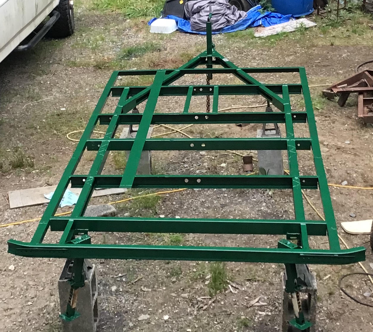

I just realized: I’m modding this trailer to be a flatbed, the exact size to set the foamie on. The perimeter steel is placed to easily bolt down the plywood deck - but the foamie will be 2” thick, so any bolt down points will be inboard of the perimeter and not likely to have metal under them. Well, I will just plan about 8 or 10 bolt down points, set 3/4” plywood into the foam at these points, and figure bolting to the trailer deck will do.

Finally got the old Jayco frame modded to the dimensions I want. My welding is horrible. I never was a Welder, just use one now and then for about half a century, and I’m sadly out of practice. One of these days when I’m retired, maybe I’ll take a class. Oh well, an angle grinder and heavy paint can cover a multitude of sins. :NC
Got it primed Thursday, painted Friday. Doing it with a 2-1/2” trim brush takes time, and it definitely “looks fine from 30 feet,” but the cost was right and the metal is protected.
The Jayco had four leveling jacks. I figured a way to mount two on the rear after my mods. With the tongue jack, that should be adequate, and not too much of a weight penalty. I think I’ll salvage the other two jacks before the metal I cut off goes into the scrap heap. Might want ‘em for another project.
