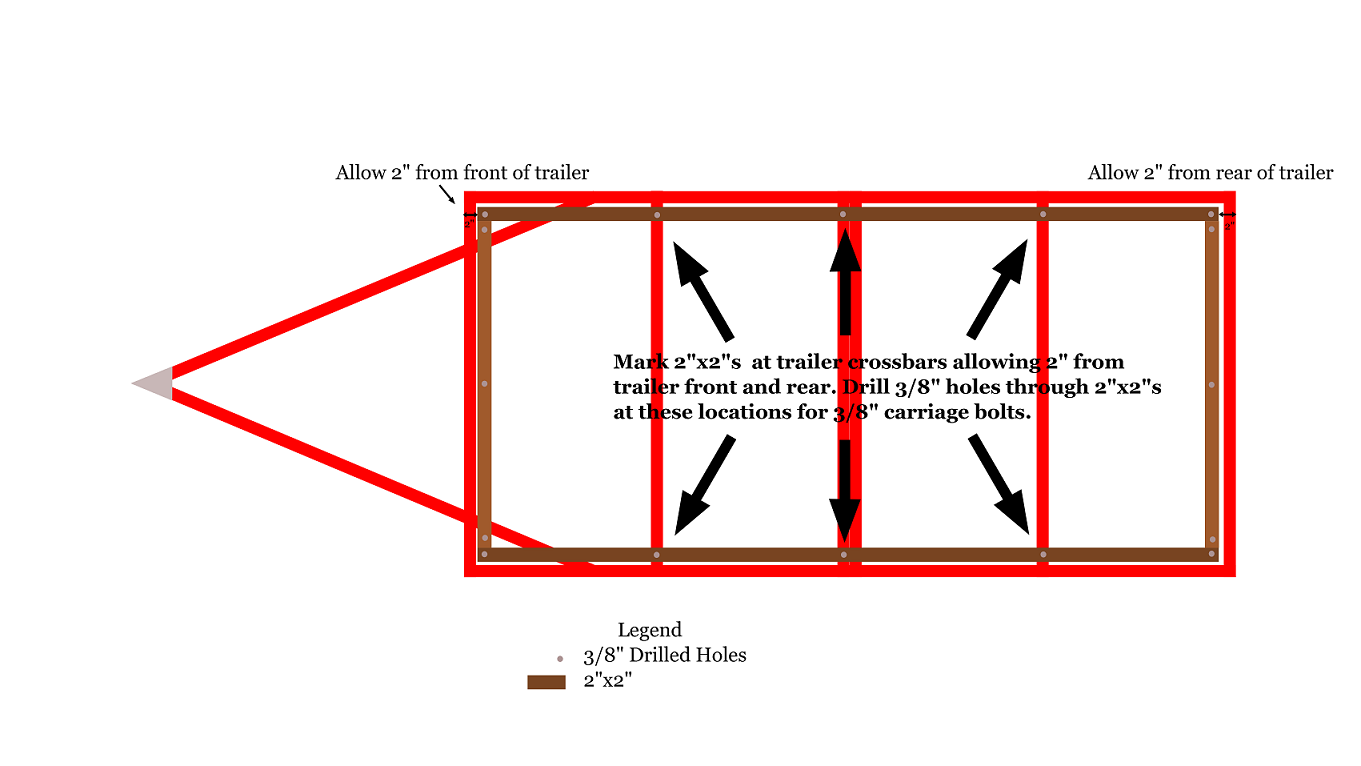

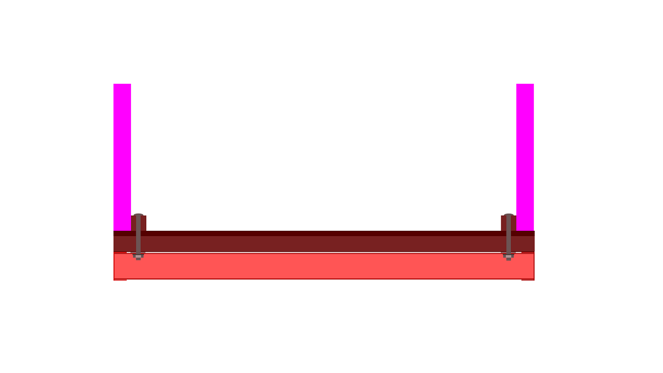

I bolted my Bug Out trailer to the trailer cross members. I also use what I call interior frame rails. 1x2's or 2x2's that run alongside the interior walls. This spreads the forces from the tie down points from flexing the floor, ask me how I know. :roll:
Of course this means that the ends will not have a tie down point since the trailer end cross members are still under the foam wall. I used a 2x2 and spacers the same thickness as the frame material. I cut the 2x2's to fit exactly between the trailer frame so that it could not move side to side. Then I added a spacer and bolted through my interior frame rail, floor, spacer washer and 2x2 fit snuggly between the trailer frame.
Later I did ad 1x2's to lift the body from the frame so I could put a drip edge on the body. Having the body sitting directly on the frame was a bad idea. Movement of the frame and body quickly sanded through the trailer paint. With time it would have worn through the canvas and caused bigger problems. Here are a couple of diagrams I did for my YouTube channel.

I would not just use a screw from the bottom to hold the trailer on the frame. :thumbdown:

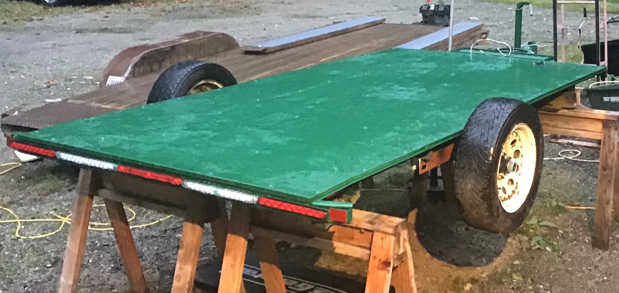

Thanks, that looks like a good idea. I did take to heart the advice to put some rub strips on the bottom of the foamie. I agree that setting the Poor Man’s Fiberglass directly on the plywood trailer deck (which is not going to be sanded super smooth, because I don’t want a slick trailer when not hauling the foamie) would result in vibration induced scuffing.
I was just going to put 1/4” plywood on top of the PMF floor so our knees wouldn’t dent it. Then, planning ahead, I was going to have some pieces of 3/4” plywood let into the foam wherever I wanted a strong point. But putting a 1x2 strip on top of that, next to the walls, should not be intrusive into the interior, and it gives some stiffening for my anchor bolts.

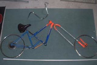

We were taught it's just “stacking dimes “ , and getting the heat right …. Yeah Practice !!! :thumbsup: … We used to salvage discarded bicycles on trash piles the day after Christmas ( last years bicycle ) and cut them up and re weld them together into more interesting bicycles … Great practice on tricky thin metal …

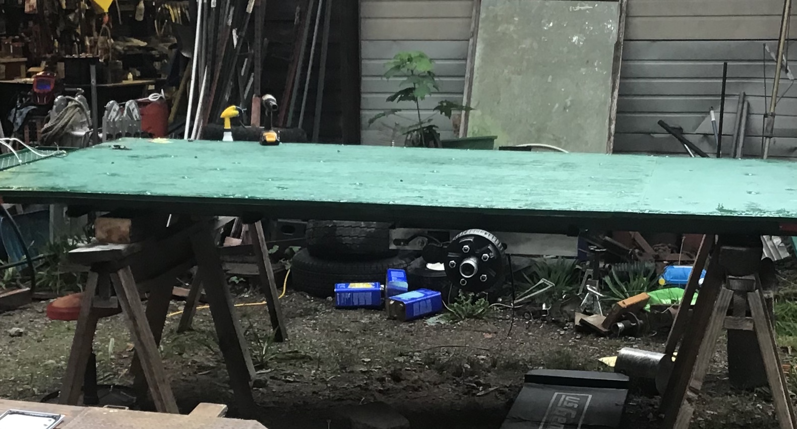

I got my new axle in the other day.
Someone gave me four trailer wheels some years ago. I couldn’t resist throwing a couple of extra Corolla tires onto two of them, then bolting them on. Trailer wheels are usually zero offset. Corolla wheels have positive offset, but the adapters I’ll be using are an inch thick, so I think the tires are pretty close to where they will be when we are on the road. At least it looks like a trailer now.
The trailer axle was our biggest expense. I’ve been putting effort into the trailer, with the idea we will use it for other things, and possibly learn enough from our first venture to eventually build another foamie body after experience teaches us what we really want. Now, other than a couple of marker lights and the brake wiring, the trailer is done (just as the weather turns wet). Time to clear out the shop and get busy on the foamie!
