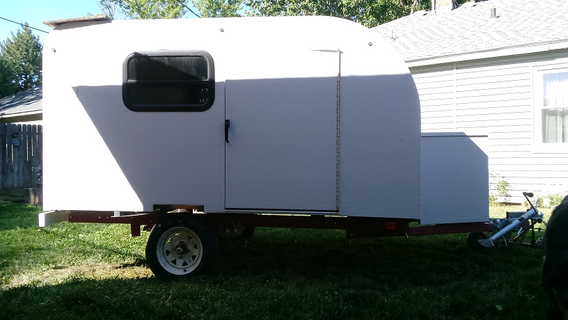

So here is #1 ready for some cosmetic surgery. Yes, she looks great, but we can make her look better by adding a skirt.
before skirts
20190825_103226 s.jpg (262.69 KiB) Viewed 5004 times

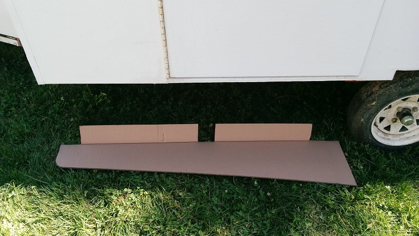

first we needed a pattern. This is easy to do with a piece of cardboard. I usually do not throw out big cardboard boxes for just such use. I also use cardboard to lay on when working on cars, trailers or anything else that requires me to sit or lay on the ground. Works great!
pattern
20190825_121004 s.jpg (293.58 KiB) Viewed 5004 times

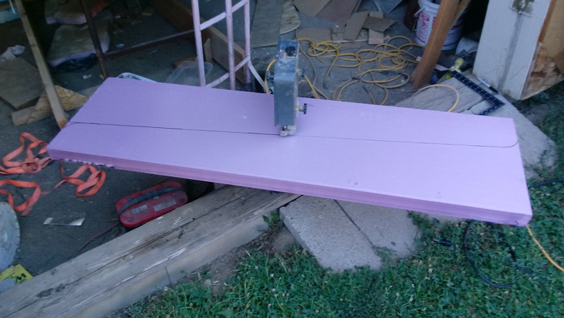

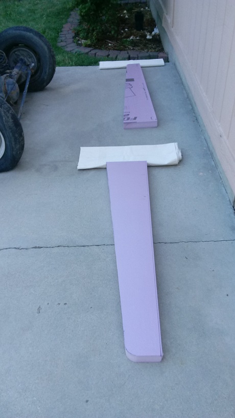

Once I trace out the pattern onto the foam it is time to cut it out. I find that band saws work fantastic to cut out small pieces of foam. They make a real clean cut, almost as good as a hot wire, but a lot easier set up.
cutting the foam
20190830_085404 s.jpg (286.28 KiB) Viewed 5004 times

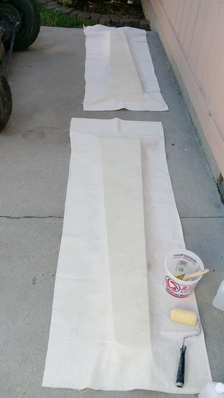

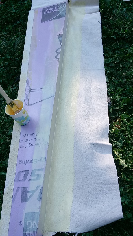

Once I cut the foam it is time to canvas. I had forgotten just how long canvasing small parts with lots of angles took.
canvasing
20190830_095842 s.jpg (248.46 KiB) Viewed 5003 times

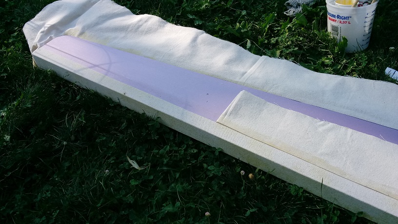

with small parts you have to wait for each surface to dry completely before moving on to the next angle. Takes hours and hours of waiting.... Here the first surface is drying.
canvasing #2
20190830_104412 s.jpg (265.63 KiB) Viewed 5003 times
Here is a in process shot of gluing up another angle of the part. In this build up I used 50/50 TBII and water on the large surface and then switch to the edges and back side with full strength TBII.
canvasing #3
20190830_180931 s.jpg (312.07 KiB) Viewed 5003 times

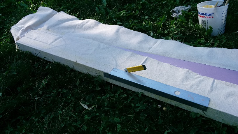

Once the glue dries I cut the edges using a piece of flashing for a straight edge and a box cutter. The box cutter will only cut a shallow cut into the foam, but it makes a nice and clean cut in the canvas.
edging and box cutter
20190830_174714 s.jpg (302.34 KiB) Viewed 4997 times
Once I make the cut I peel back the excess canvas on itself as to not lift up on the canvas that I want to keep bonded to the foam.
removing excess canvas
20190830_174742 s.jpg (299.48 KiB) Viewed 4997 times

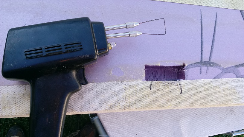

Once I get all the canvas work done I want to add attachment points to the skirt. In this case I want to attach the skirt to the 2"x2" cross members I installed under the floor. I marked where the 2"x2" would be located on the back side of the skirt. I then used a hot wire to cut out a 1 1/2" deep pocket to accept a 1"x2"x7" piece of lumber.
hot wire
20190901_100143 s.jpg (289.76 KiB) Viewed 4997 times

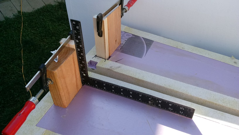

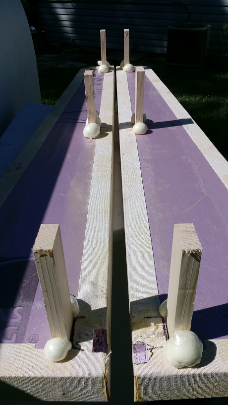

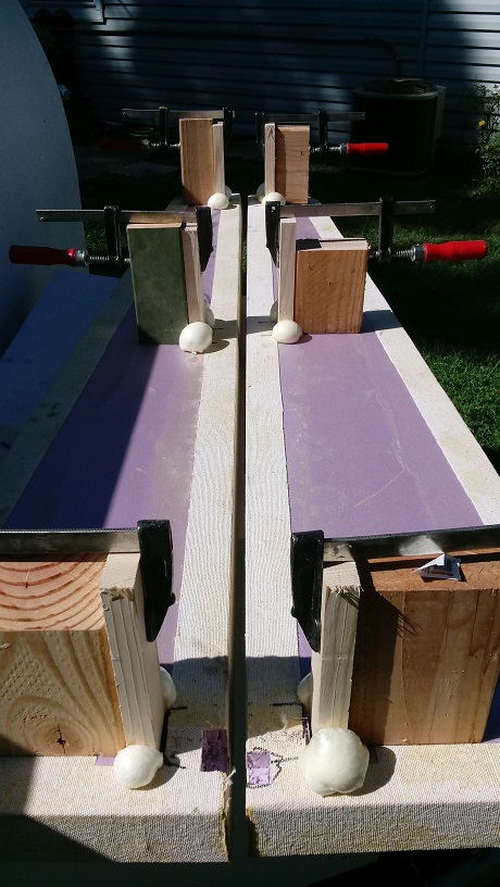

Now it is time to prep for glueing the 1"x2"x7" piece of lumber into the back of the skirt. I placed the 1"x2"x7" piece of lumber into the hole and then clamped them to a block of wood that was cut true to 90 degrees. I then used a square to verify 90 degrees from the sides. Since I placed the 1"x2"x7" pieces of lumber all the way down into the pockets I am not expecting to much, if any, hydraulic lift from the glue . I am going to use Great Stuff to glue them in with. The blocks of wood and clamps I used to hold the 1"x2"x7" pieces straight for glue up will also add a bit of weight to help with hydraulic lift too.
glue prep
20190901_101903 s.jpg (267.56 KiB) Viewed 4980 times
I then used Great Stuff to fill the pockets. This glues in the 1"x2"x7" supports.
Glue installed
20190901_114006 s.jpg (296.3 KiB) Viewed 4980 times
Once the Great Stuff dried I took off the support blocks and now I have my first skirts ready to install once I remove the excess glue. :thumbsup:
Ready to install
20190901_114205 s.jpg (283.23 KiB) Viewed 4980 times

Re: #1
Postby pchast » Mon Sep 02, 2019 9:12 pm
What kind of wire are you using in the solder gun for a cutter?
How thick is it? I haven't found anything that won't bend when
heated yet.........
:thinking:
Thanks for the info.
pchast
Posts: 2065
Images: 97
Location: Athens, NY
Re: #1
Postby ghcoe » Tue Sep 03, 2019 6:41 am
pchast wrote:What kind of wire are you using in the solder gun for a cutter?
heated yet.........
:thinking:
I believe it is .030 flux core welding wire for all my hot wire needs.
George.
ghcoe
Posts: 1982
Location: SW Idaho
Re: #1
Postby pchast » Tue Sep 03, 2019 10:17 pm
Thanks, I'l try that. :D
pchast
