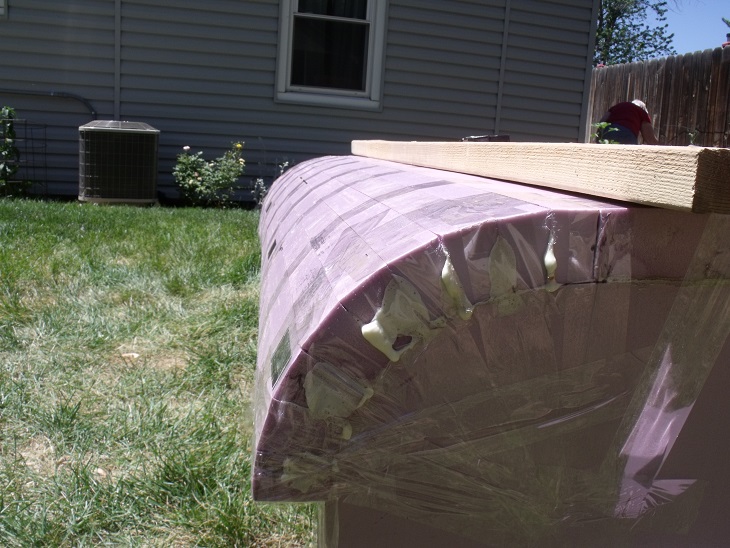

I did my rear radius in segments. I had to do it because the radius was too tight for a kerf bend. The segment method is a pain over the kerf. Sanding the edges down and making even across the radius was difficult.
Segments
DSCF1993 small.jpg (184.81 KiB) Viewed 9771 times

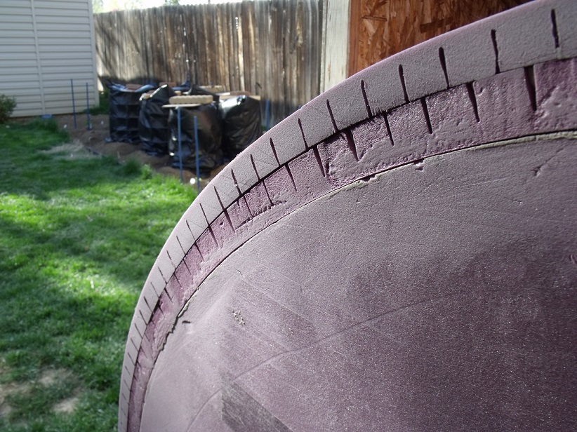

I found using 1" foam and kerfing the inside of the exterior piece and kerfing the outside of the interior piece and then gluing them together was the easiest. No sanding required except along the edges :thumbsup:
Inside kerfs
DSCF1888 s.jpg (255.65 KiB) Viewed 9771 times

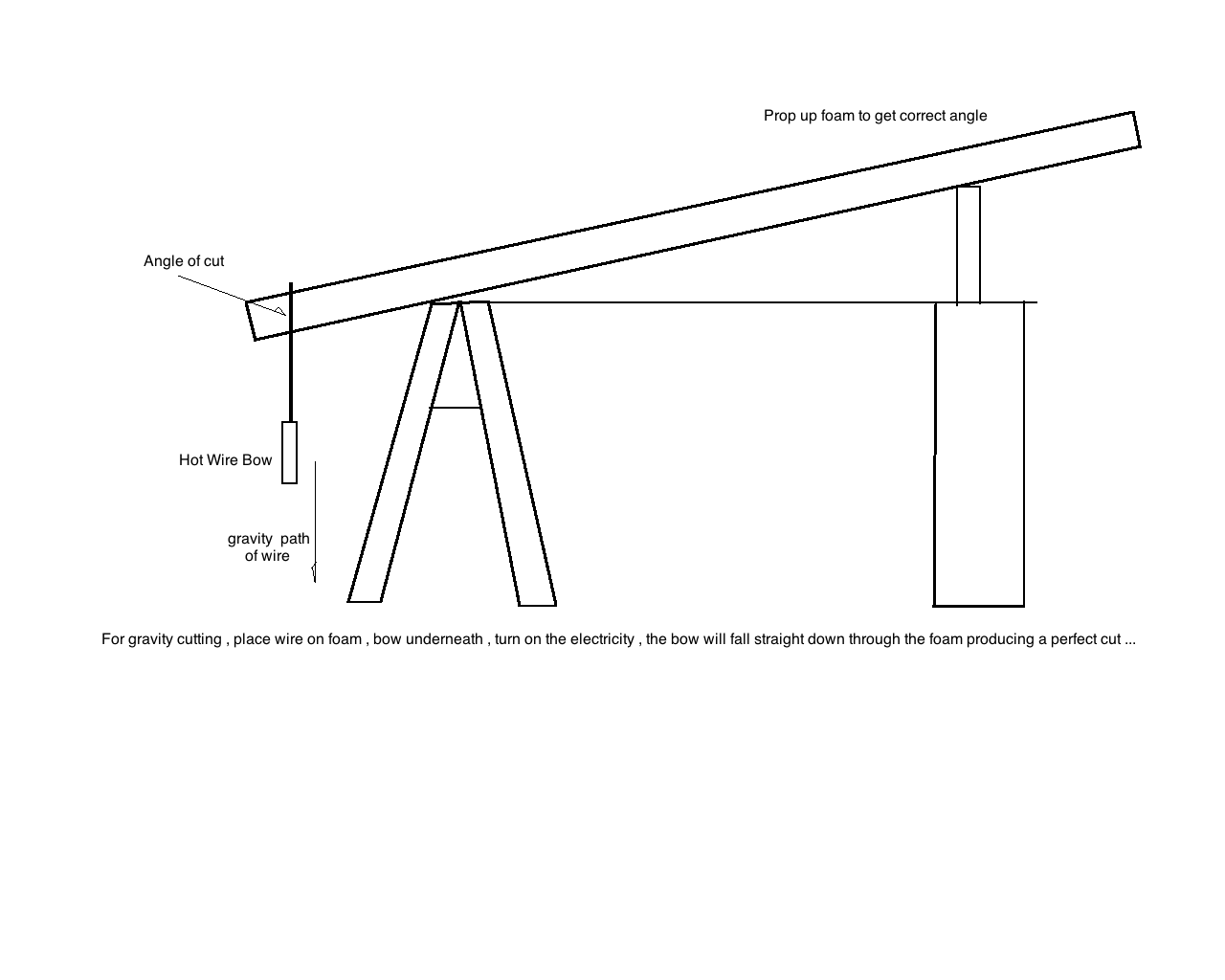

I was thinking of larger segments and leaving the segmented look , which would not be a problem ... :thinking:
Ps. whilst cutting , DO NOT touch the bow .... let gravity do the work ... ;)
Gravity cut .png (51.34 KiB) Viewed 9858 times

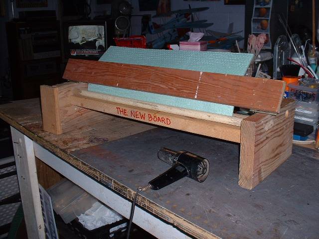

OP, That seems like another thing to try .. but anything we do to bend large pieces of foam is going to take something bigger than the average trailer builder is willing to commit ...  I’m still thinking about the easiest method so far , a small bending jig and a couple cheap harbor freight heat guns ... Same thing we’ve used for years to form the model foam (1/4” - 1/2” Blucor ) ... just Bigger ... The only thing is the curve is made by bending small areas at a time (gradually curved) rather than all at once ...
new board.jpg (48.63 KiB) Viewed 9691 times
