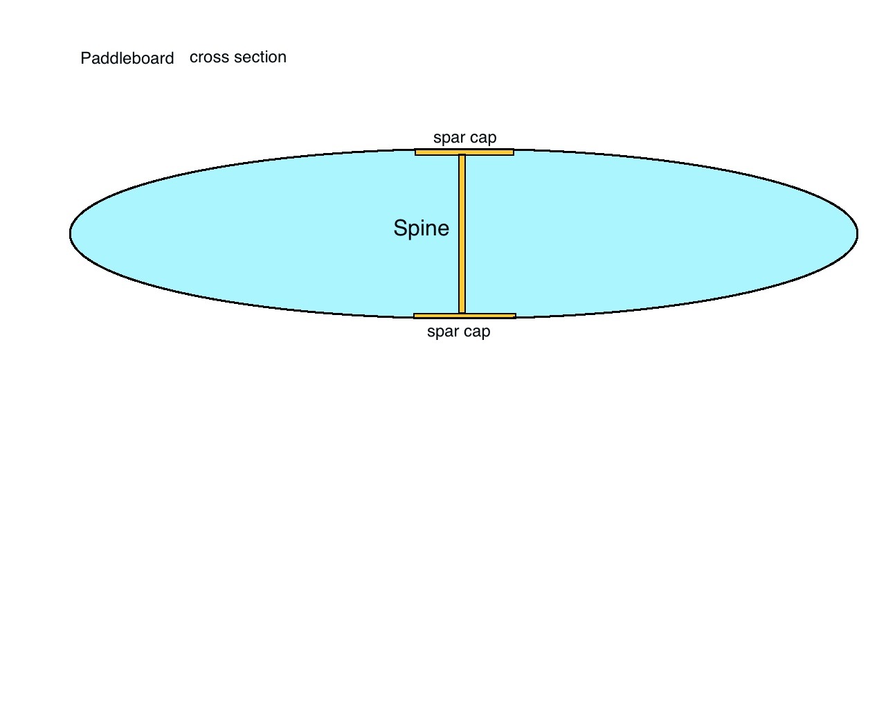

Row , I haven’t heard back from the paddleboard couple , (since we fired them from the band :roll: ) But I’m Sure if you made it Thick enough , it would be fine ... or you could insert a plywood “spine" down the middle for even more strength (surfboard style ) .. Or even a plywood "I beam" for max strength ... :thinking:
