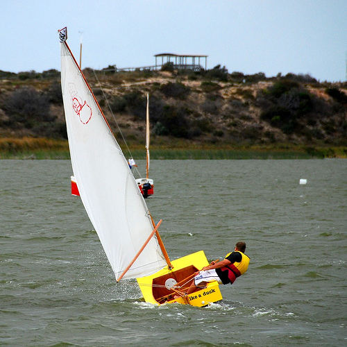

Bonnie:
I can attest to the fact that the Puddle Duck's are loads of fun. Have been sailing mine for over 1.5 yrs. Easy to build, can be made out of foam (light), can be rowed, sailed or motored.

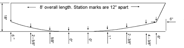

GPW:
There are similarities in both the PD Racer and Foamie Barge. All depends on your needs. I believe the cockpit area of the PD Racer may be larger. Many times I bring along my three grandchildren and the extra space is nice to have.
The foamie barge would probably be lighter and would be easier to haul around.
The PD Racer has a nice rocker style hull that allows the boat to sail well. The bow and stern rides nice above the water when you are sailing or rowing.
