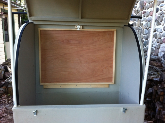

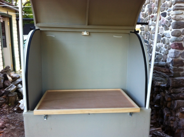

Here's a few shots of the fold down table I added to the front compartment.
The primary use will be to put batteries and chargers for my RC planes. The table is a simple 1x2 frame with a dado to accept the 1/4" ply top. It's hinged to another 1x2 that's screwed to the foam with drywall anchors. It folds flat against the back wall when closed. A couple pieces of thin foam weatherstriping keep it from rattling around on the road. A simple slide bolt latch keeps it in place when stowed. The front edge rests on the sill of the hatch opening when it's down. It's designed to catch any spills of liquid and is sloped towards the front. I'll drill a couple holes in the front corners for drains.
I made it so that the hatch can be closed on it, leaving a gap but still hopefully keeping any rain off it. I'm thinking of putting a window behind the table to replace the ventilation I'll lose from the rear window when I replace the back door. I still have to round over the corners and polyurethane it. I may add a center rib as it sags a bit when I put my 5 gallon water jug on it.
I still need to add something to hold the hatch up. Gas lift pistons or maybe shock corded tent pole materials. I found a kit here:http://www.questoutfitters.com/tent_poles.htm cheap, and I wouldn't have to worry about calculating the right pressure and stroke for gas pistons.

Nice BIG front compartment ... :thumbsup: 8)
