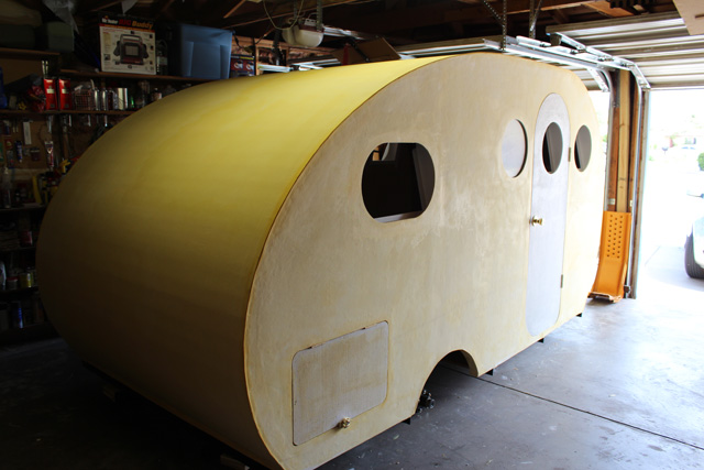

Postby NMMarauder » Tue Apr 21, 2015 4:43 pm
GPW wrote:Having worked with painted canvas all my life , we always start with a ‘sizing’ , which is a highly thinned “glue" (rabbit skin glue in my case) which encapsulates the canvas fibers and protects them from decomposition from air and water and oils (Rot) ... :thumbsup:
And as we found out , unsized canvas cannot be completely protected (saturated/encapsulated) with normal painting without the sizing . Even modern primers cannot completely protect the canvas fibers without the sizing step ... all well tested ... ;)
I never thought about the glue encapsulating the fibers. After gluing the canvas on, I applied a thinned coat of glue and squished it into the fibers to get full penetration of the glue in the canvas. I was really just looking to get a good bond. I'm glad to hear that I accidentally did something that was positive (encapsulating the fibers).
The down side to doing this, is causes irregularities in the surface underneath the canvas to show more. I squished the fully saturated canvas into every nook and cranny and the defects of the surface underneath show more. My thought is to add a subtle texture to the surface to help hide those defects. They are pretty slight and most people wouldn't even notice but I'm afraid that I'll notice and it will bug me. I used really nice canvas from Big Duck canvas and it has zero defects so any defect underneath shows. The HF drop cloths that I have used for the interior has enough texture (a polite word for flaws) that they hide some defects. I've gotten good enough at seams now that I think in the future I might stick to the cheaper (in every sense of the word) drop cloths and just deal with the seams. The Big Duck canvas is nice but for a foamie they may not contribute much.
I thought about using a long nap roller or even one of the 'Restore' rollers that is used for applying deck coating. Does anyone have suggestions for applying a subtle texture?
Maybe a texture is a bad idea. Thoughts?

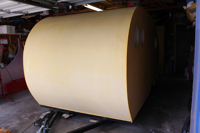

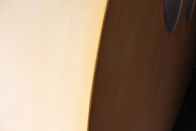

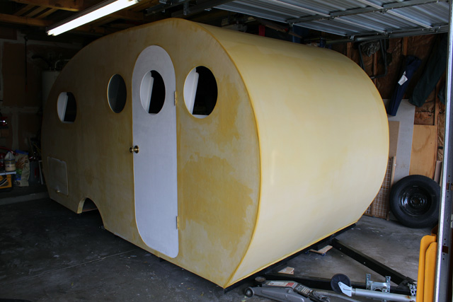

Postby NMMarauder » Tue Apr 21, 2015 4:49 pm
More pictures of progress....
Here are the seams from wrapping the side canvas onto the curved roof. It took an entire day to get those cut and glued down well.
Here it is all covered in canvas.
The darker yellow areas are where I had to really work to get the wrinkles out of the canvas as I was smoothing. So they ended up with more glue in that area. This was the side that I didn't hang the sheet beside it. Letting the sheet of canvas hang beside when you glue resolved some of these issues.
I'm very pleased with how the roof seam came out. The walls overlap 3 inches onto the roof and the roof canvas runs right to the edge of the roof. Not sure if it shows in the picture very well.
