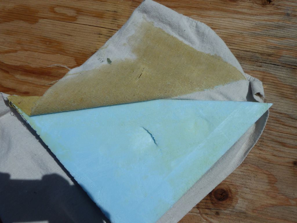

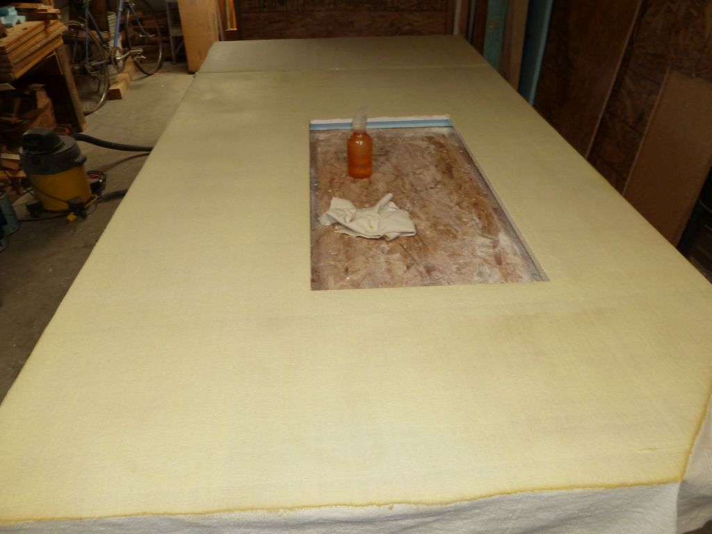

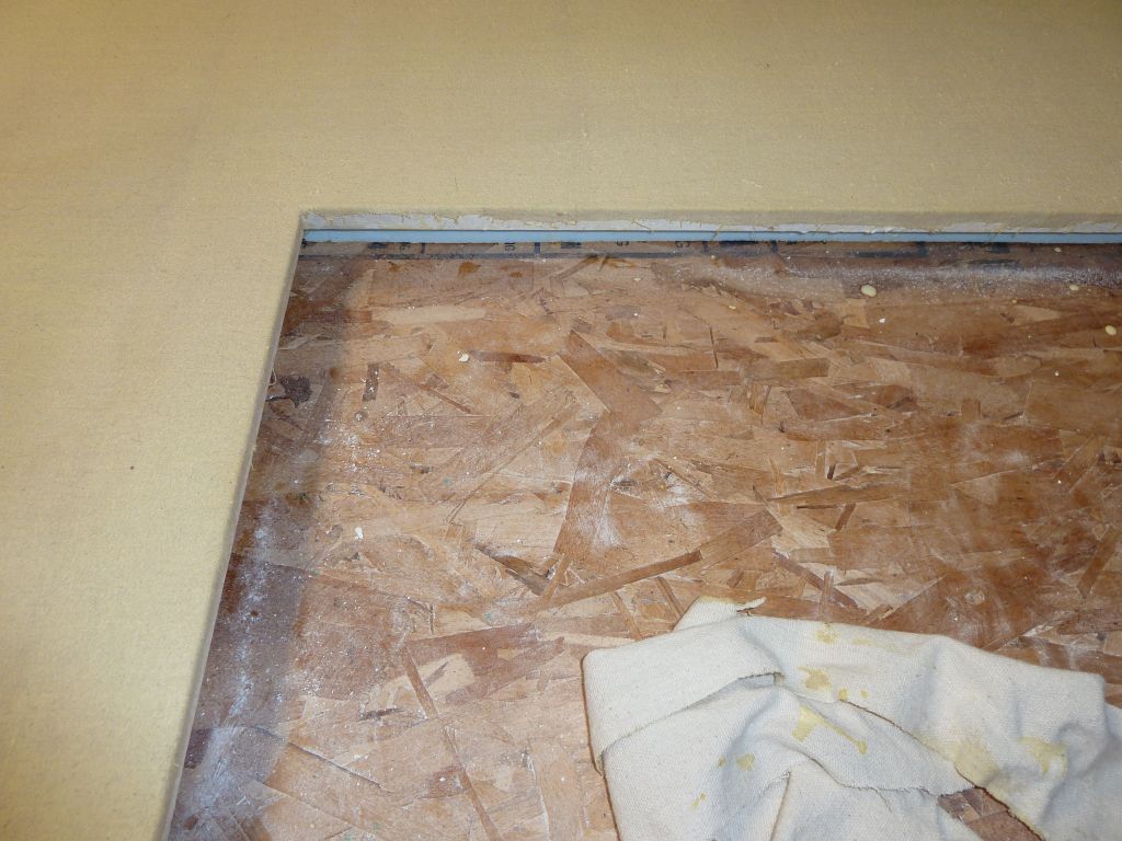

Finished the canvas glue-job on the other inside of the TD. Still wet but came out smooth, about as good as the other side. Still uses a lot of TBII, so the paint alternative would be nice but see below. Did some overlap while wet - messy but very easy to get it sticking. Getting the margin even is difficult - seems like that would be easier if you could get close to see what you are doing. Mine came out all crooked because that's just what we do here at rancho rapido muy bueno :?
One note of caution - when I lifted the canvas to stretch out bubbles, some small bits of spackle came with it :thumbdown:
OK, test of TB II vs Latex Paint - my conclusion is that the differences are very minor. TBII sticks a little better, is a little stiffer but you can decide from the pix below as well as I can. Not scientific but seems to me paint works "good enough". Hammer blow was one moderate, one strong blow with a framing hammer.

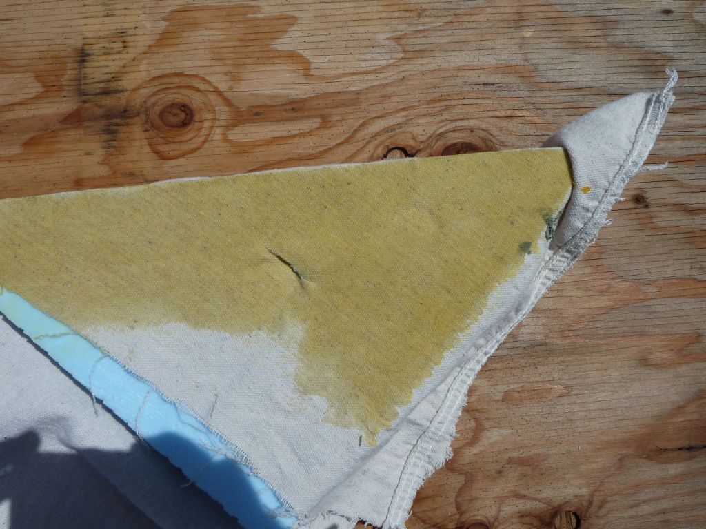

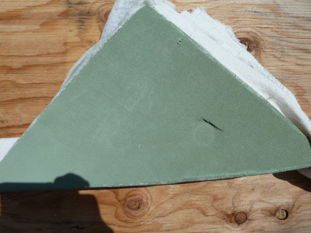

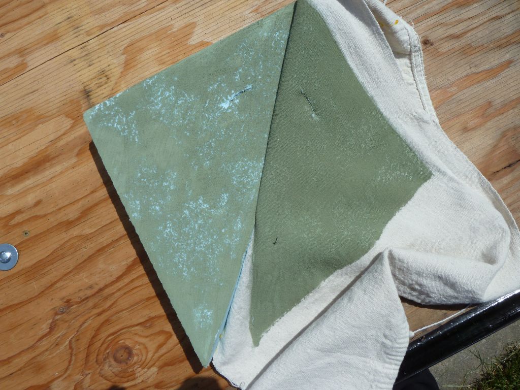

Continuing the test, I tried to peel back the canvas - this really is more about "micro"-adhesion - when you consider the size of the glue surface, nothing is going to break all the glue surface like this, but it was not hard to peel back either treatment.

Going by your pictures it looks like the TBII peeled back from the foam. The paint looks like it stuck good to the foam, but was weaker in holding the canvas. Maybe paint on the foam and then TBII will be a good combo...

ghcoe wrote:Going by your pictures it looks like the TBII peeled back from the foam. The paint looks like it stuck good to the foam, but was weaker in holding the canvas. Maybe paint on the foam and then TBII will be a good combo...
George, I think that may be because I did not give the TB II enough curing time (the rancho muy rapido effect) - only waited 20 hours or so for that versus about 12 hours longer for the paint. Actually, the TB II was much harder to pull off and alot more foam stuck to it but it was all small particles. Only patches of the paint pulled up foam. The both stuck, but the TB II was much stiffer as you can see from the lack of complete hammer impressions.
All in all, 5 bux for canvas sticky is cheaper. I think a thinned coat of TB II on top days after the paint cures on both sides would be good for that bump resistance and not be so expensive, so I will try that and call it good. Will be putting on a coat of foundation sealer on top of that, then sand it smooth, then my final latex enamel exterior type paint color of choice. I want the road dust to be easy to clean off cuz I plan to put plenty on it :beer:

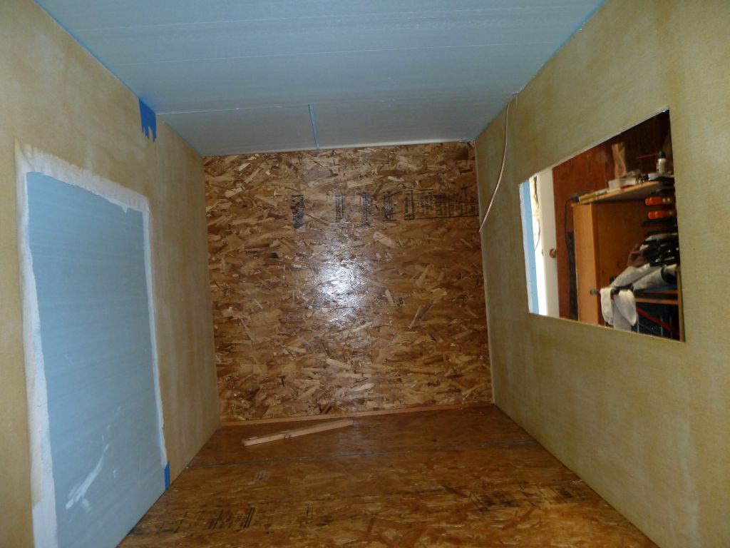

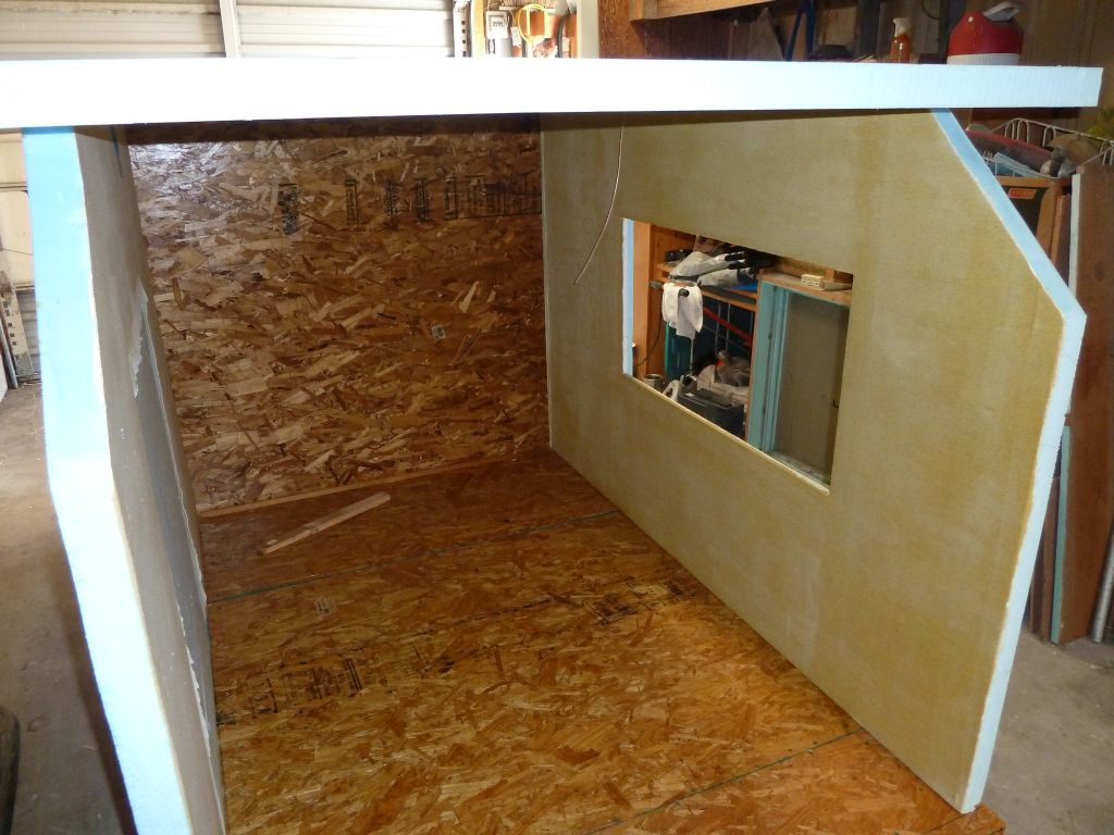

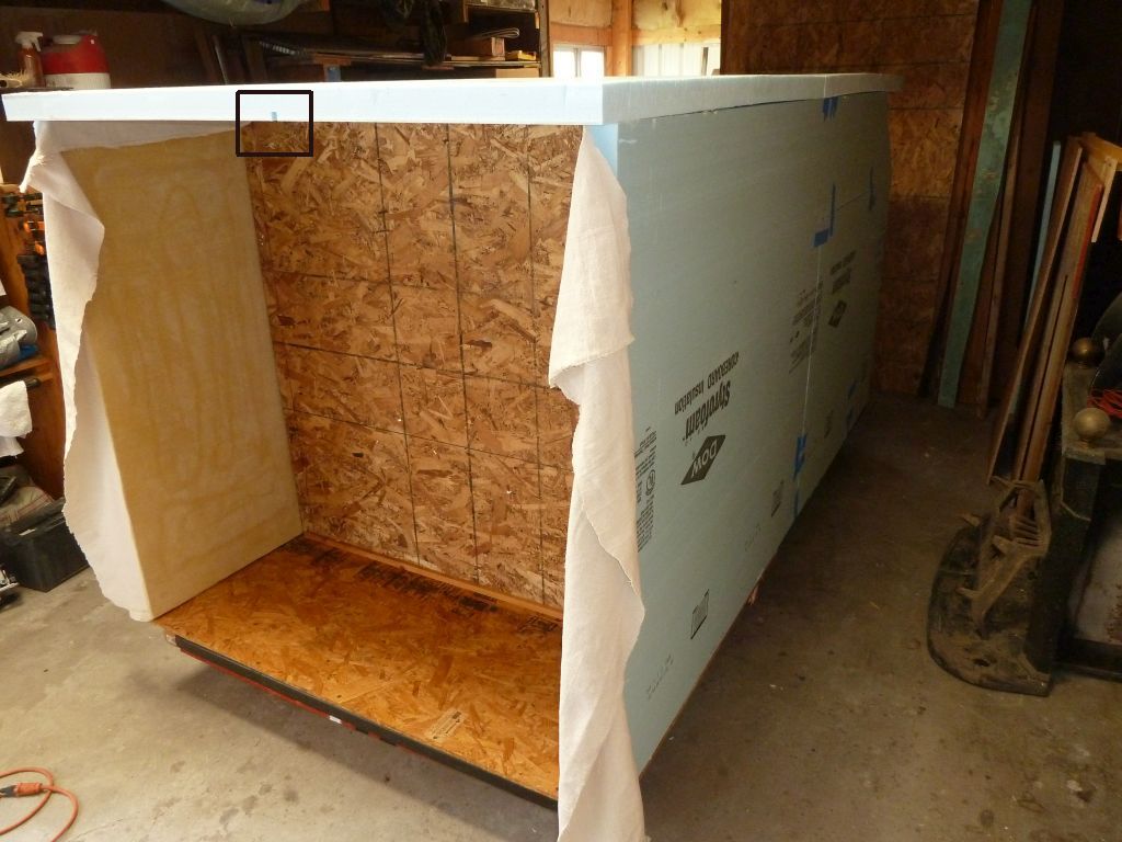

Yay ! Got the peices temporarily assembled. Boo ! made one of my typical errors - routed the slot for the bulkhead the wrong way. Yay ! It's foam, so I can fix it with great stuff and sand paper :beer:

Postby Fred Trout » Thu Jun 04, 2015 11:18 pm
Just concluded that I can use the mistaken router dado to run the wiring for the fantastic fan & interior LED light fixture, also the galley light fixture. Serendipity :shock:
Battery will reside in bottom of galley compartment.

Postby Fred Trout » Fri Jun 05, 2015 7:22 pm
It's always exciting when the walls of the build go up. Makes you visually focus on where the TD is going. :thumbsup:
I found it so useful to do the temp assembly that I plan to do it again soon and sit in contemplation of possible build pathways. Navel gazing I suppose.
Today I got the foam mattress cut with an electric knife into it's folding pieces (see GrassHopper pic above). Crooked cuts, of course, but hey, it's foam so we can buff that out :R
