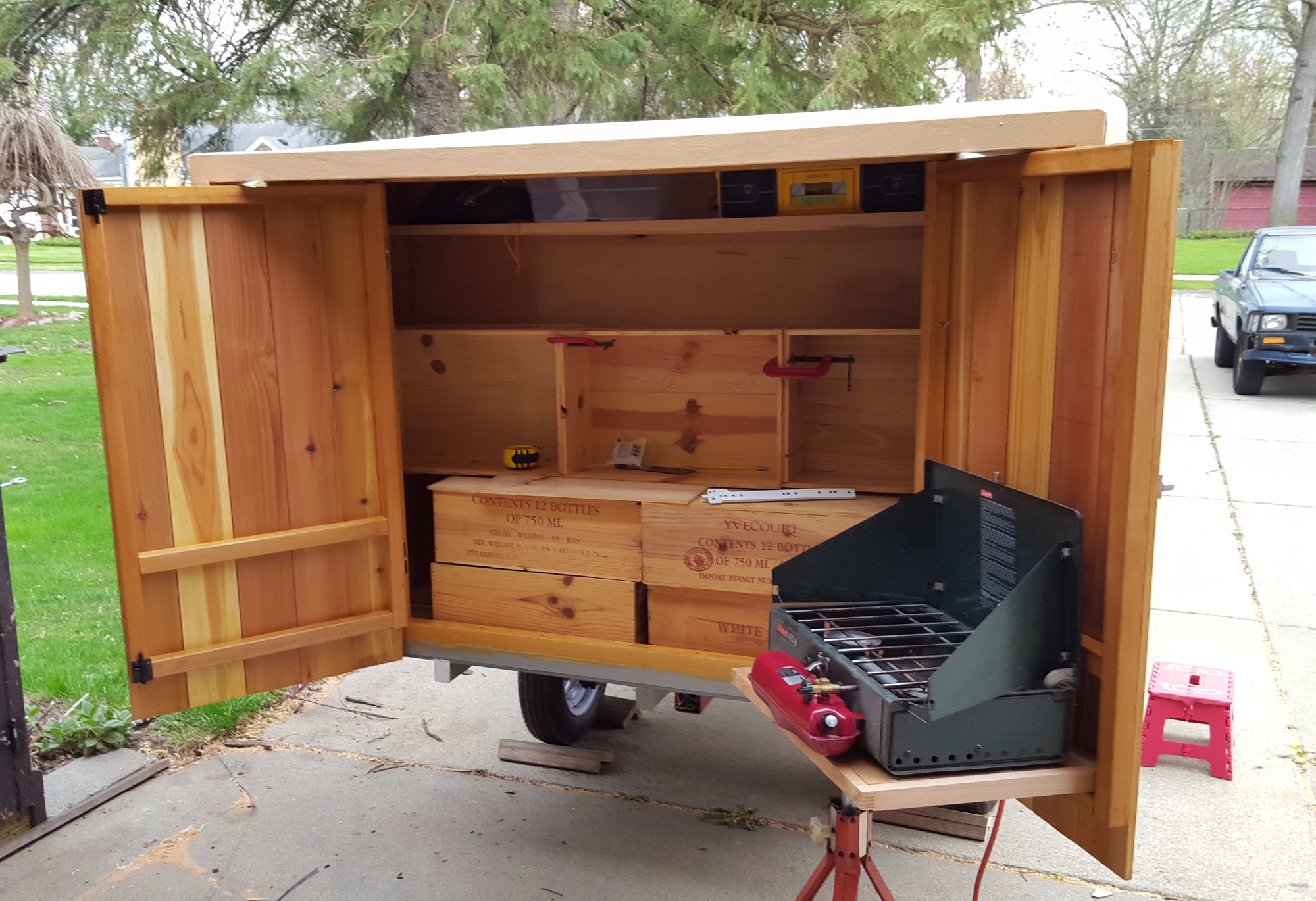

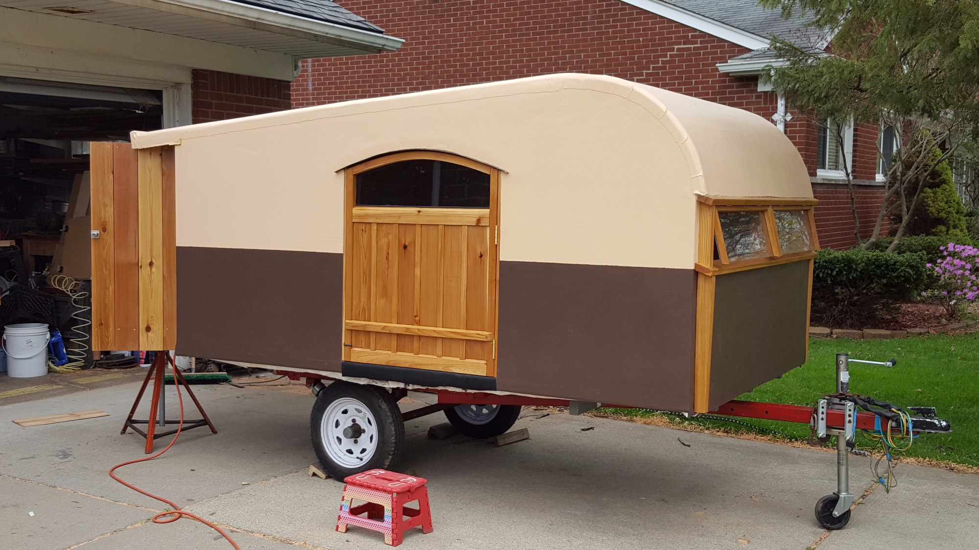

Postby Bob Hammond » Mon May 01, 2017 4:39 pm
The Nutmeg (now so named) spent the winter in a pvc tent-shed and did very well. I'm now fitting out the galley and finishing up a few other things, but I thought I'd post a pic or two for you. It has been through several very heavy and windy rainstorms, and does not leak, and the front windows keep out rain even when cracked open as in the pictures. I tried heating it with a small electric Pelonis ceramic disc heater, and with 30F outside it got up to 70F inside within 20 minutes. It has excellent ventilation and so stays comfortable in the sun when it's hot as well.
Here's a pic while fitting out the galley with wine crates that I picked up for $3 ea. The Coleman stove is sitting on a shelf that attaches with a cleat to the door (a brass chain will suspend the outboard side of the shelf). Inside on the right, are two drawers (19W x 7H x 13D) that are mounted on $5 glides, and the stove fits perfectly inside one of the drawers. On the left, it's a false front made up from the sides of a crate, and it serves to cover a microwave, and it also is a cutting/prep board when it will be attached to the door as the Coleman stove is. There is also a small drawer above the microwave. The cedar counter surface will be varnished to harden the surface. The upper cabinets (also crates) will be removable, so that they can be stowed inside the cabin for proper weight distribution while on the road.
On the side view, I'm looking for self-adhesive rub/trim strips for the belt line (and maybe for the seam at the top), but haven't found any in auto stores. Does anybody have a suggestion?

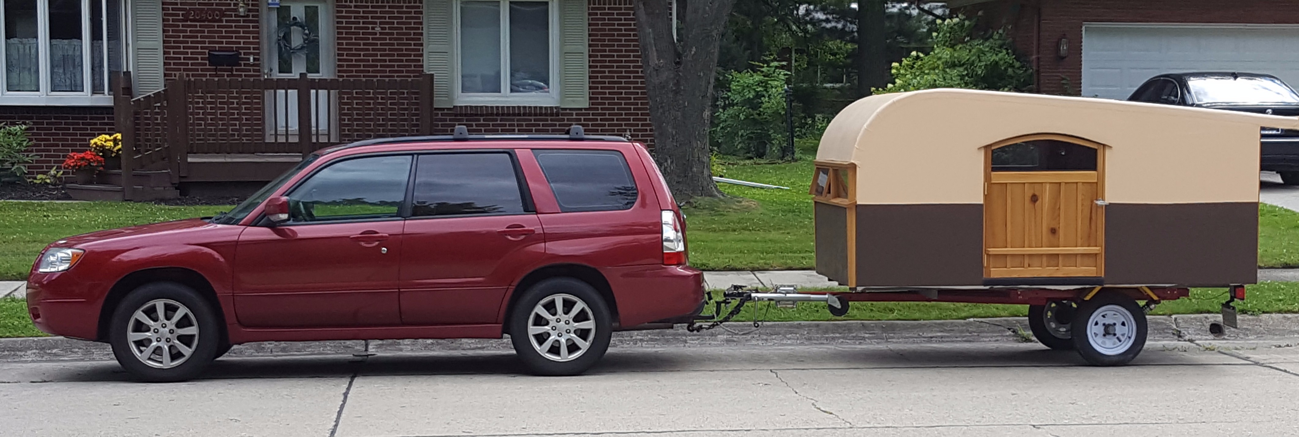

Postby Bob Hammond » Mon Jul 24, 2017 3:26 pm
Today, I hitched it up and took it on a shakedown cruise down a badly potholed street. Everything stayed together, but I think I'll come up with a more secure method of latching the barn doors in back. The attachment of the hasp & staple lock might be a bit weak, and so maybe a strategically placed bolt or two would be a good idea for traveling.
The tare weight (i.e. less clothes & food) is <750 pounds with about 325 pounds on each wheel and 100 on the tongue. I've inflated the tires to 36psi initially. It is quite dry in heavy rain, even with the front awning windows open and the wylie door windows opened. The warm-white LED lighting is perfect. The only thing that concerns me now is the narrow track of 50" with the body with of 66". I'm considering a sway bar.

Postby Bob Hammond » Sun Aug 05, 2018 12:54 pm
Hello, it's been awhile, but I thought I'd post something about traveling with the Nutmeg.
It has been a great success. It tows perfectly behind my Subaru Forester, with little or no sensation that it's there even at 65-70 mph. Passing tractor-trailers, either overtaking beside it, or coming in the opposite direction on a two-lane road, do not disturb it because it rides in the 'wind' shadow of the car. I made it the same width of the Forester (66"), and it's just a little higher. There are two major considerations for moving it. 1) The design of the suspension works extremely well going in the forward direction, but there is little or no shock absorb in the reverse direction (well hey! go slow!). 2. Since the trailer is so short, when it comes time to orient it on the campsite, it's much easier to unhitch it and use the T-bar and wheeled jack to scoot it around the site with 'Armstrong Power'. Since it's lightweight (~825lbs loaded) and balanced, it's not so difficult to drag around.
At the campground, it's easy to set up. During travel, the galley winecrate cabinets are placed into the cabin over the axle to maintain balance, and when parked they are set in the galley. It has proven to be perfectly stormproof when in camp, even with the window screens in the 'Wylie' doors and the front windows wide open.
One other thing, is that it's an eyecatcher, and everybody in the campground wants a tour. Some are interested in commisioning one, but I don't think I want the hassle of being a manufacturer.
