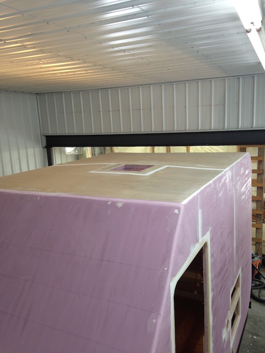

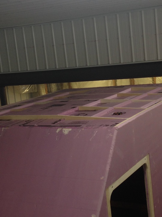

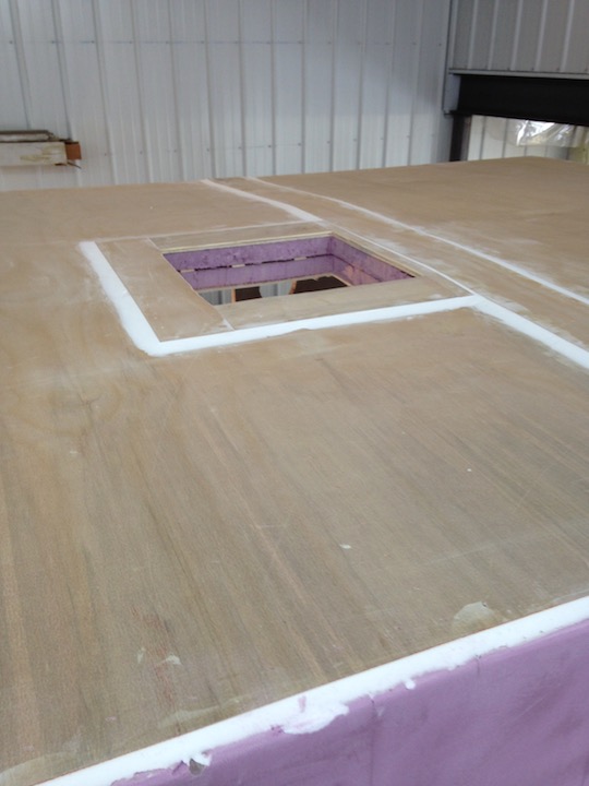

Here are some photos of my roof. One pic shows the roof without the 1/4 plywood skin. Another pic shows with the 1/4 plywood skin. The last picture shows the roof vent opening a little closer. Around the roof vent I doubled up the 1/4 ply to raise the profile and to provide more "wood" for the roof mounting screws to grab. The interior of the vent hole is rounded over with a router bit. The white stuff is lightweight spackle. I also spackled around the edge to blend it down to the foam wall panels. It's all ready fro canvas now.

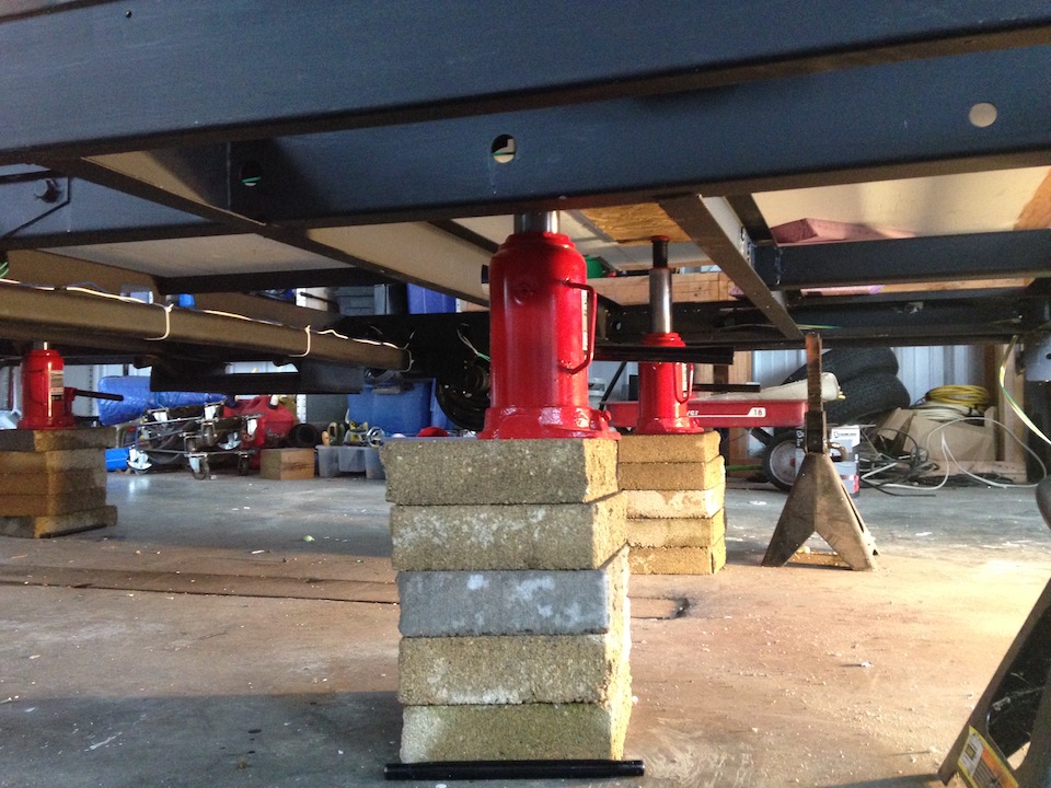

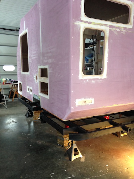

Here are some photos of jacking my camper off the frame. They are self explanatory.

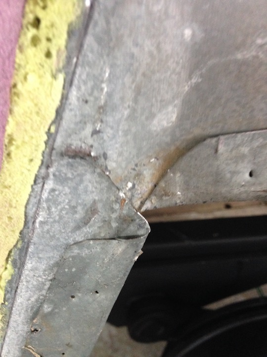

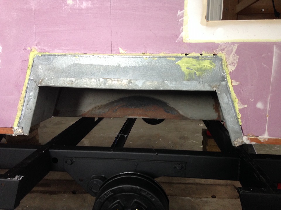

Here are two pictures of my salvaged wheel wells. My wheel wells need a little help. They have sharp edges, I'm afraid they will cut the canvas either right away or over time. So I picked up a little fiberglass resin and cloth today. I'm going to fiberglass right around the edges of these wheel wells, cover all the cracks and build up a little bead right around the edge.
My wife teases me, says she hopes we're not driving down 101 with pieces of our camper flying behind us. I told her she'll have to get out and clean it up. She already did that once, we both did, the day we destroyed our pop up camper. LOL
This camper is already rock solid. I'm surprised by the structural integrity. The box didn't even flex when I jacked it up. If you thump the side it resonates like a drum. I can't wait to hear it in rain.
Friday will start with fiberglassing and will move into canvassing. Once the canvas is on this thing is going to fly.

Postby KCStudly » Thu Apr 19, 2018 2:39 pm
Trailer work looks great!
I realize that your cabin probably doesn't weigh very much, that we all make our own judgements about safety everyday, and your jack feet have nice flat wide bases on them; but I feel compelled to comment for the sake of onlookers that have never been made aware.
It is considered to be unsafe to use concrete blocks, pavers or clay bricks as cribbing. Although a good material for taking widely applied structural loads in compression, when point loaded they tend to crack and/or crumble. Just saying. :)
Re: A Tiny Travel Trailer for a Family of Four
Postby Bruue1 » Thu Apr 19, 2018 7:37 pm
You are probably right. Just as a disclaimer: I would never tell somebody else that anything I do is how to do something. I am only showing how I do it.

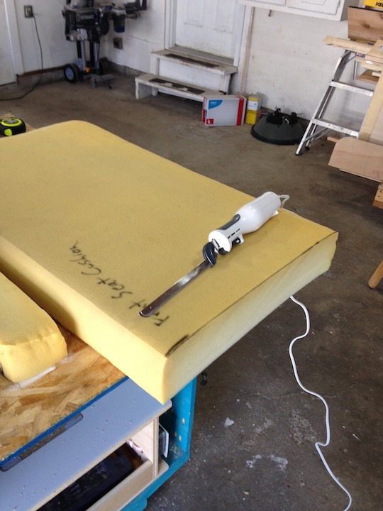

All the foam is cut to shape. I used and electric carving knife from Walmart ($13). I couldn't believe how well that knife cut the foam. No tearing, clean and straight cuts.
We have 7 more seat cushions and 3 more mattresses to go.

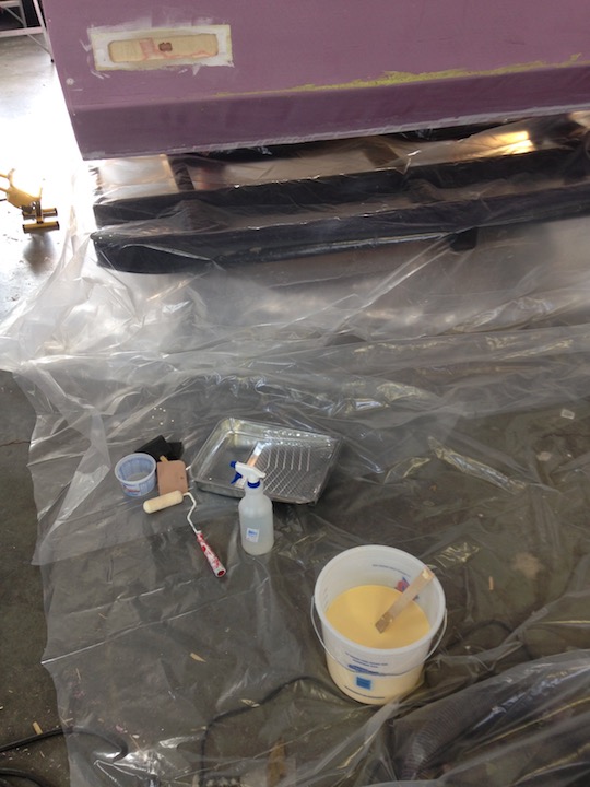

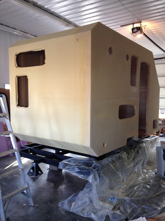

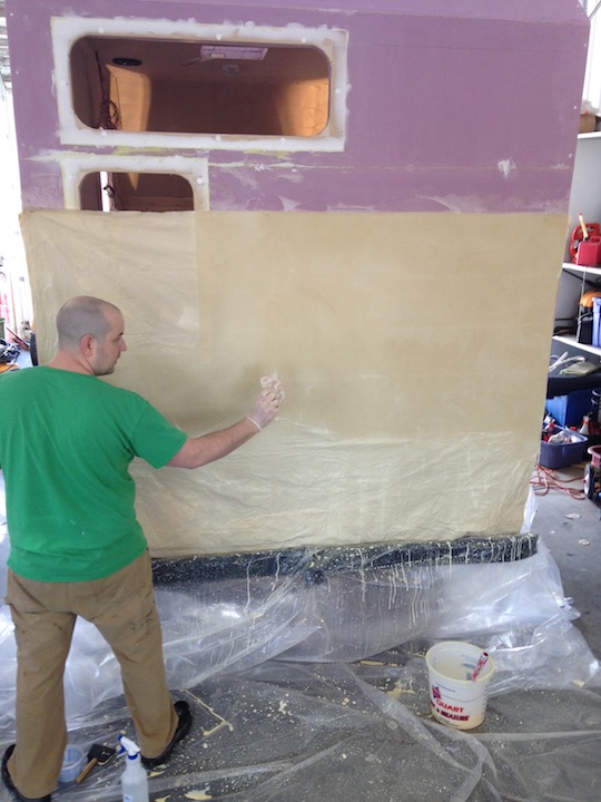

Two sides of the trailer have canvas! Two more will get covered today. Then let it dry. Then paint the bottom, Then drop the box back down onto the frame. Drill some holes and bolt that sucker to the frame. Then drop the frame to the ground to lower the camper as much as possible. Then canvas the roof. Then paint, windows, doors, interior etc...
Putting this canvas on is a mess. I end up covered in glue. When I was looking at my first batch of Titebond 2 and water mixed 50/50 I was skeptical. I thought it looked very thin. I watched a couple videos and re read some blogs on this site. I then went ahead with it mixed 50/50. I'm really pleased with the results.
For tools I am using a bondo spreader, a small foam roller, a few 8D finishing nails, a razor bade, a five gallon measure bucket and an air powered stapler. Its a cheap tool shop stapler ($20 years ago, I'm glad because it is now covered in glue).
The wall canvas has been going on in two courses:
The Bottom Course I am hanging it with finishing nails pressed into the foam walls like tacks. Then I use the bondo spreader to smooth it down and out to the sides. This little squeegie works awesome.
The Top Course begins on the roof, I have enough of an overlap to hold the canvas in place once pressed in the middle with the bondo spreader. Then the same, work from the top middle, working down and out. It is not an exact science the way I am doing it. I'm happy with how the seams are laying down but they are not perfectly straight. I can live with what I am getting. I'm just excited to use this thing.
I have huge overlaps from the top section to the bottom. I am on the roof 12 inches and at least 12 inches over the bottom piece. I figured bigger is better in this case and there is no reason to be cutting off 14-18 inch strips of canvas, I wouldn't use them anywhere else.
The very first piece I cut for the rear 82 inch span was 88 inches long figuring on a 3 inch overlap each side. I thought if it shrinks a little 2 inches will still be fine. I ended up getting no overlap at all. In fact it was an inch or two short. I still used it, I am patching the corners before applying the side pieces which will overlap the other way. The second piece for the back I cut 95 inches. I ended up with about 2.5 inches of overlap on each side. So this canvas shrinks when you soak it in glue and water all crinkled up.
I cut out the windows and doors with the razor blade leaving about an inch of overlap, I use the staple gun to wrap the canvas into the windows and door frames. The canvas does overlap the underside of the camper a minimum of 4 inches, I am also using staples here in addition to spreading the canvas with the spreader.
These huge sheets of canvas are a mess and a pain the ass. That said, application is pretty easy and goes pretty fast. With the squeegie it lays down pretty flat. It hides the imperfections in the body pretty good. I'd take this canvas over fiberglass. If I had wanted to spend more money or if money wasn't an object I may have preferred to fiberglass the roof and put aluminum on the sides. Looking at these two sides done I do think this canvas is going to work great! As long as I get a good paint finish on it and seal up the seams.
I'm going to paint this whole thing with roll on Rustoleum oil paint. I'll probably thin the paint 10% with some mineral spirits. We'll use primer underneath and put a roll on clear coat on top of the color. We were thinking about different paint schemes, I wouldn't be surprised if we just end up one solid color. Maybe try to match our tow vehicle. Maybe one lighter base color and one stripe to match the tow vehicle.
Maybe name it Box of The Wild and paint a Master Sword, Hylian Shield and a Triforce on it. Thats my son's vote.
