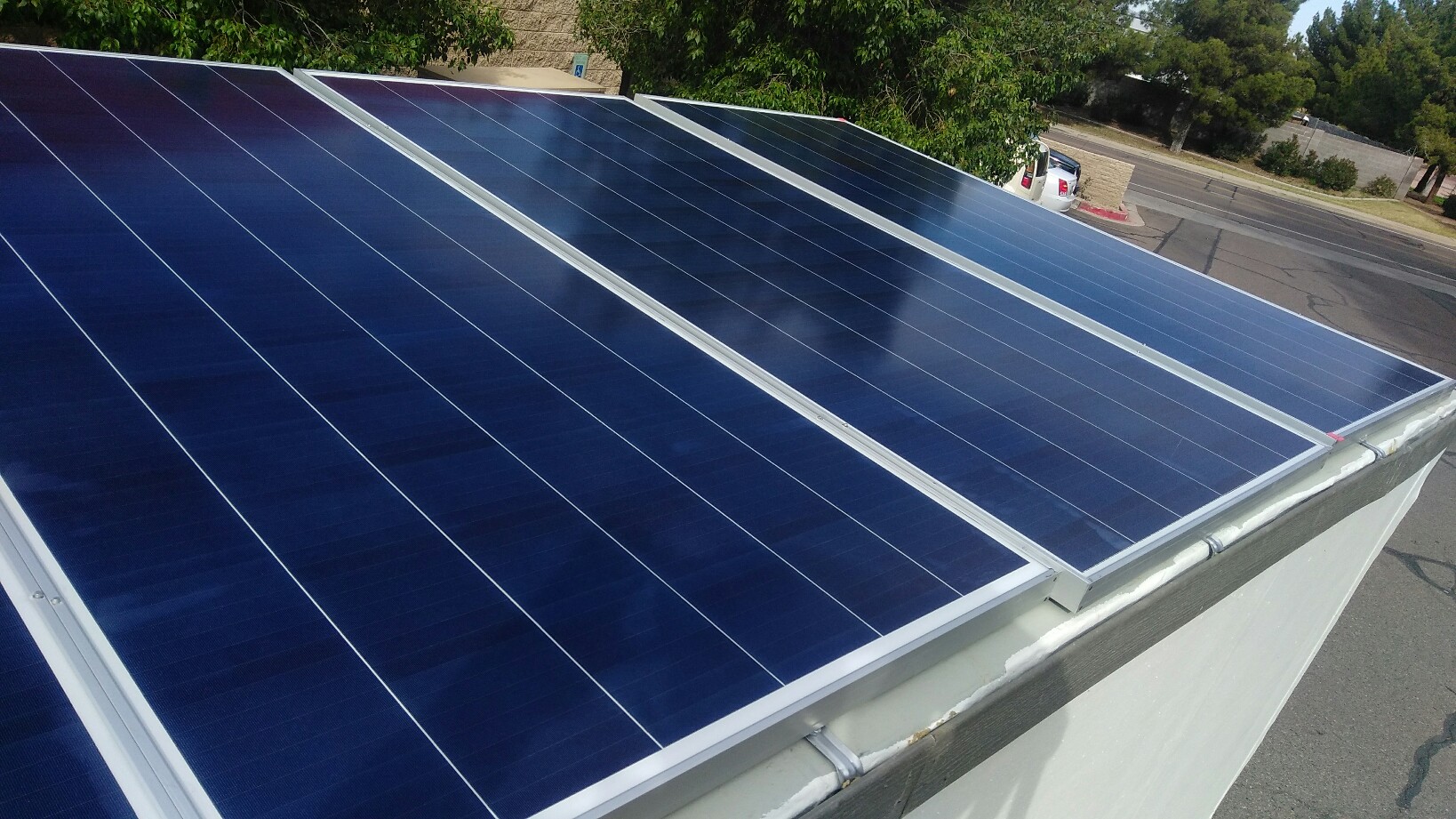

Ok, walls done, box framed sufficiently for strength, outside corners protected, but the roof.
The roof.
What to do for the roof for damage protection?
I was thinking about all the options and the costs, seeking out cover solutions. Galvanized steel was about the most resistant and cheap. Trying to find with the least amount of seams to minimize water infiltration. Had a quote of $200 for the metal and $350 preformed and bent to fit.
Found a supplier on Craig's that would just about cover the entire roof. And give me electric power as well for about $450.
This was great!
:D
So I went with solar panels to protect the roof and give me 1360 watts of power at the same time. Win win.
I was considering solar anyway, so why not use it to cover and protect the roof? The tempered glass is incredibly strong on these and made to be resistant and durable.
Would never have to worry about having to recoat the roof.
Turns out that I could get 80" panels to cover my 84" wide roof which would attach perfectly to my inset boards on the roof. Perfect, what a stroke of luck. Place as many would fit up there and I had solar energy to boot. Managed to get 4 up there, cover all of the roof except for about 14", and only cost $115 per panel.
They weren't too heavy and from my test, believe that the roof could withstand the 50lbs per panel.
Ideally, hopefully, maybe. You know what I do.

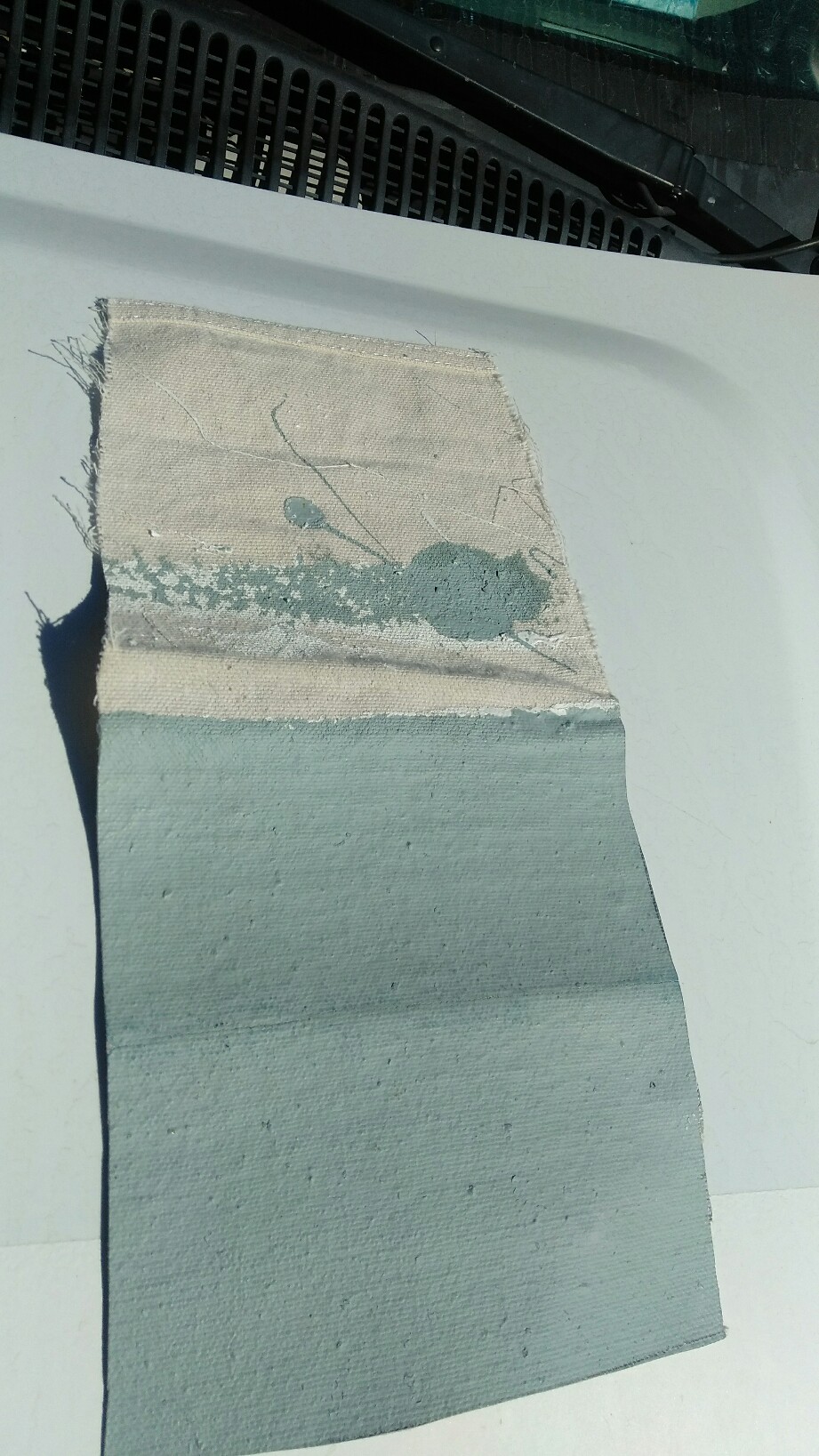

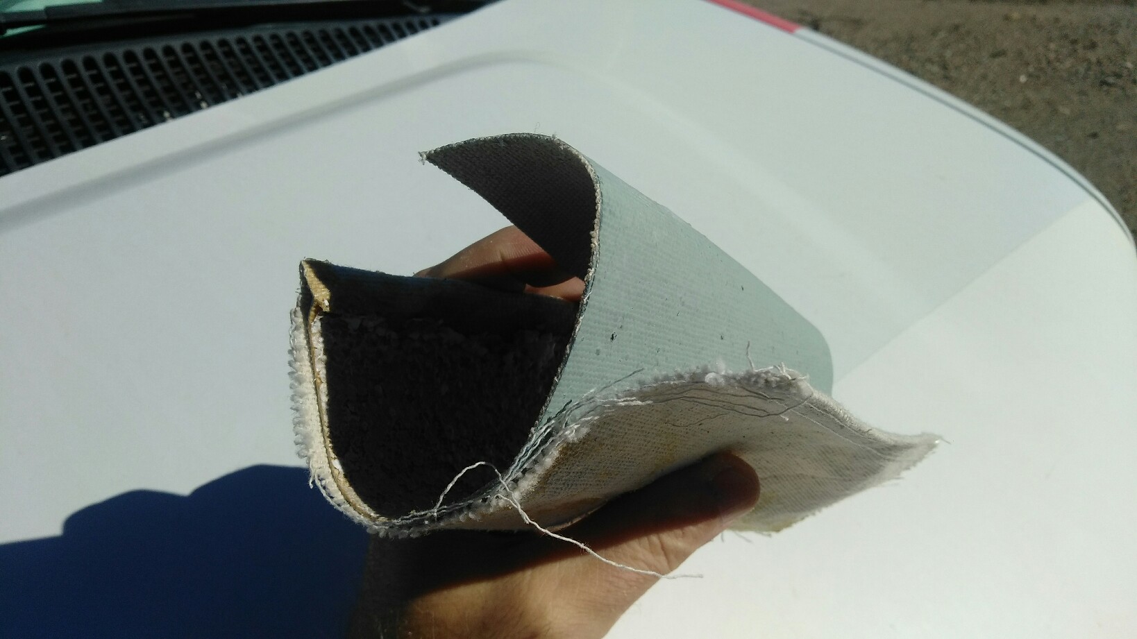

So here's a pic of my PMF that was on the wheelwell section that I cut out. It has stayed flexible and pliable.
Think that with TB2 50/50 mix, would be hard and rigid.

Another pic of before and after paint.

“ I had accidentally impacted and penetrated my PMF skin when a board fell against it, creating a 2*3" L shaped gash. Damn. Easy to repair, just caulked and painted but not impressive in the least.”
You really need to give yourself time to enjoy the best part of a Foamie , the “Self Healing” … Put it out in the Sun a few days , and most any comprsssion based deformity will fill back in … ( this also works with damp towels and Ironing the foam , just not too hot ot you’ll deform the surface … “ ) For small dents , just ignore them and they’ll go away …
If you rush in and fill the dents , when the foam underneath decompresses , you’ll have a slight bulge … :o

Yes, I read this in your thread. Didn't work for my Polystyrene. Notice that circular dent that I mentioned in the driver's sidewall?
It was there over a week for sure, in full AZ sun and didn't go away, unfortunately. Actually, now that I think more about it, it wasn't going away after weeks of being formed.
Appears that this doesn't happen with my foam. :(
So I've filled it in weeks later, on separate occasions and it hasn't popped out yet. It better not.
But then, it isn't the 100+F we get in the summer either, only cooler 70s.
And the gash that I mentioned, it penetrated and cut through the fabric. That wasn't going to self heal.
That's the only thing that has disappointed me so far. Maybe because of my glue dilution as stated earlier.
But then I used about 10 gallons diluted. If I used undiluted, would have required 15 gallons which at ~$30/ gal for TB3, would have been almost $500 in glue. It would still have been$300 with TB2 undiluted. If I didn't get my materials at great prices, would have seriously questioned the validity of the whole approach. For a bit more money, would have built it with more durable materials or bolted on the used box and retained better value.

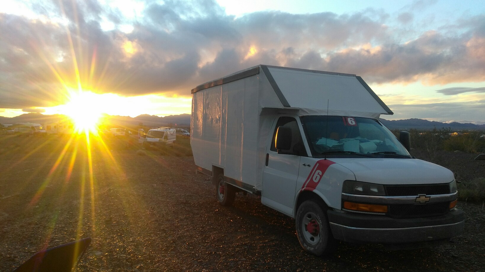

Approx. 5 weeks after I started, I pulled out of the kind owners yard and hit the road with a completed box and unfinished interior. The outside will do for now, a bed, shelves, counter and seating only on the inside. I will make do with battery powered LED for now, had lots of batteries.
The interior needed doing, solar hooked up, interior build and finish were all on the agenda.
First trip, about 2 hours highway. No issues, set cruise for 65 mph all the way. No noise, vibrations or weird handling issues. But then I drive carefully, or so I'd like to think.
Stopped for supplies, new propane tank, and hit Lowe's for some plywood to finish the counter doors. The parking lot is a great place to work, cause if you need anything, just run back inside. I did, for screws, boards and trim. Even stayed overnight and continued the next day. Mighty helpful and friendly folks at Lowe's.
The next day was major highway, 75 mph and lots of trucks.

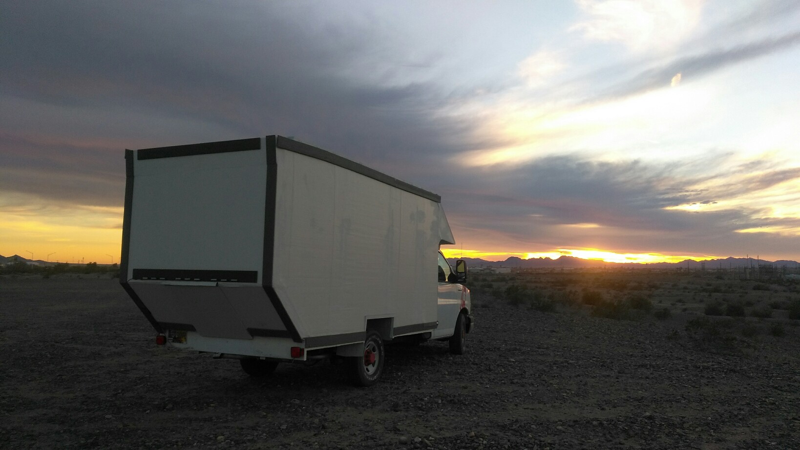

Headed out on the highway, looking for adventure, in whatever comes my way....

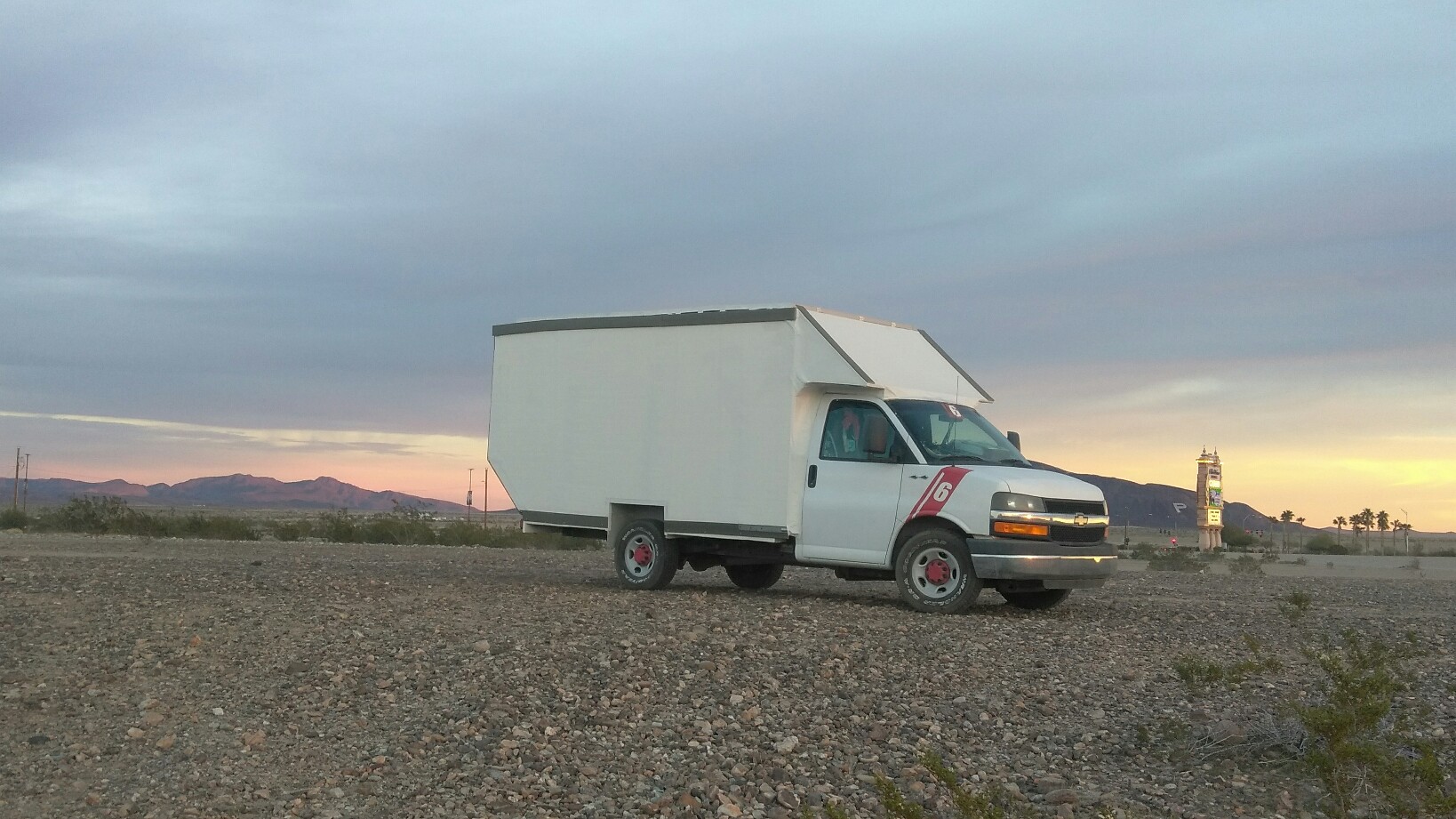

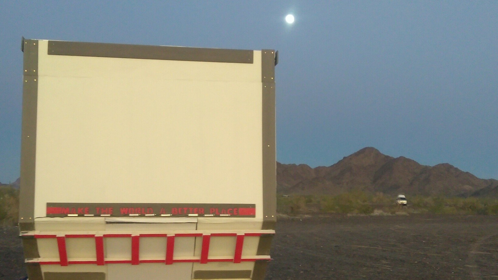

And the sun sets, on TERRA6.
Make it so.
Projector

Postby Projector » Tue Jan 29, 2019 11:30 pm
Even managed to attend a very popular, local get together. Camped among my fellow enthusiasts.
Golden sunset blessing us all.

Postby Projector » Tue Jan 29, 2019 11:33 pm
Inspirational words, to motivate us all.
Instead of a bumper sticker, I stencil painted my own.
To all who pass me, as I slowly trundle along.

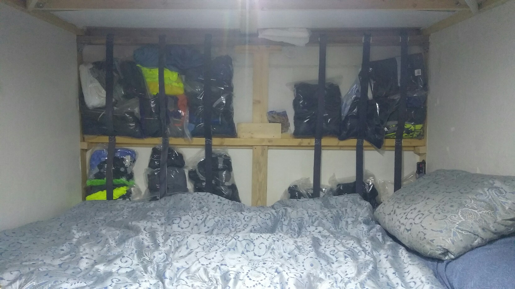

That stuff stored along the wall is clothing.
Thought this would be a great utilization of wasted space, leaving other space available. As well, quick and easy access when you get up in the morning. Roll over, pick today's clothes, get dressed, put up bed, and your off to start your day.
Clothes rolled and stored in large plastic ziplock. Compress, save space and also importantly, keep the dust from driving dirt roads embedding your fresh, clean clothes.
Used old tie down straps that I knew I was keeping for some future purpose. :thumbsup:
