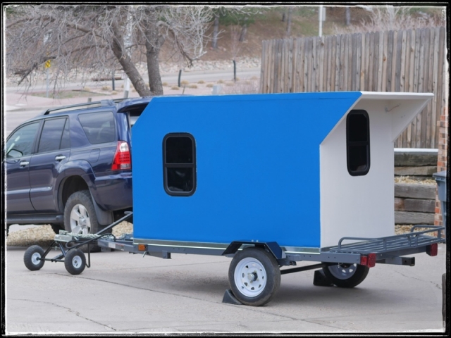

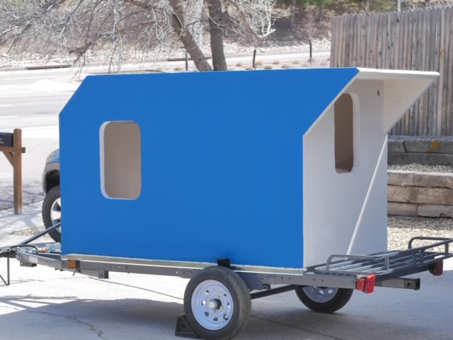

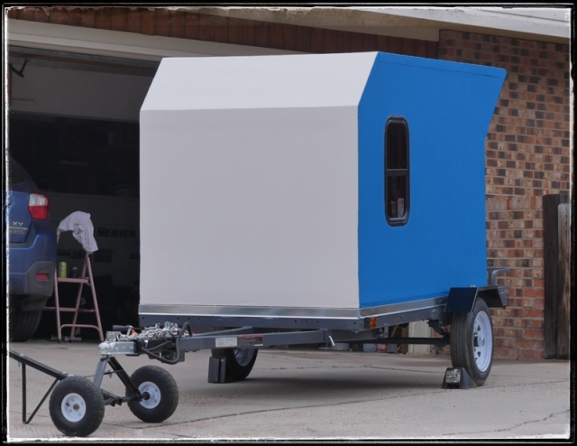

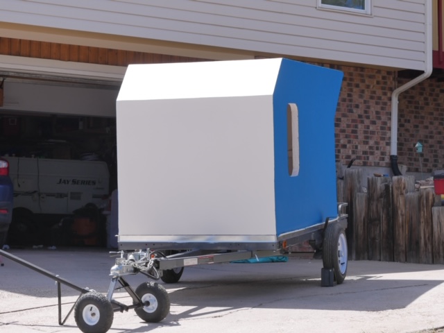

Got out and painted today...
Deep Blue sides and "Oyster" front back and top. The "Oyster" white has just a tiny hint of blue in it, is not apparent in the photos:

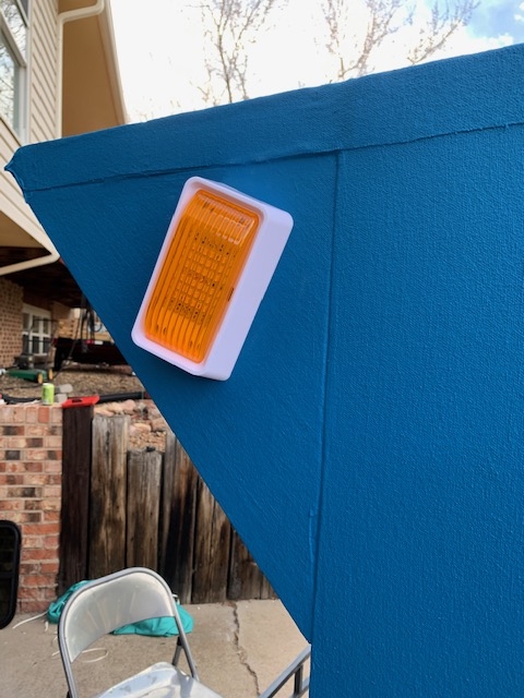

Installed the porch light:

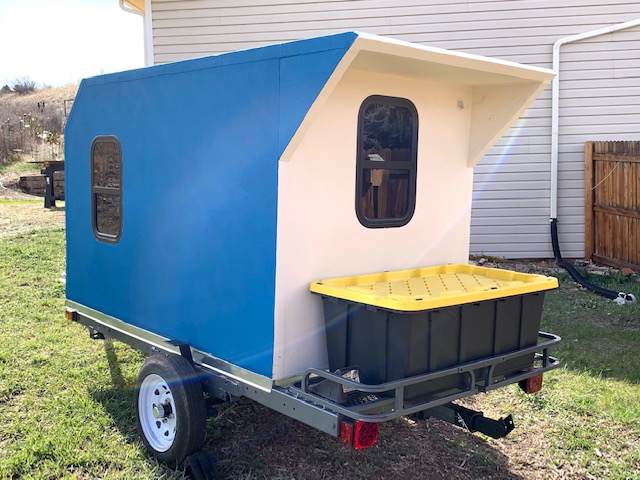

And we managed after GREAT effort to install the rear window (was very very difficult,many words unsuitable for mixed company were uttered):
I sure hope the door and other window are not _this_ hard to install...!!!!

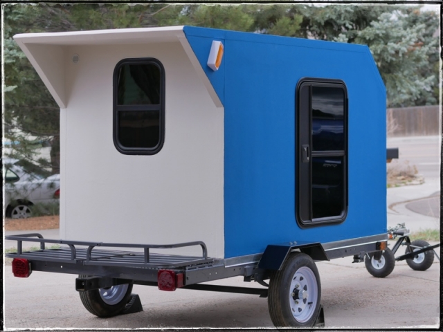

Postby JazzVinyl » Wed Apr 15, 2020 5:59 pm
Hello Foam-ites!
Got my other window and door in!

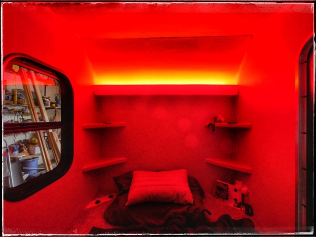

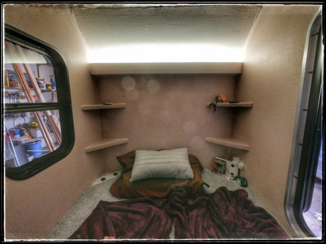

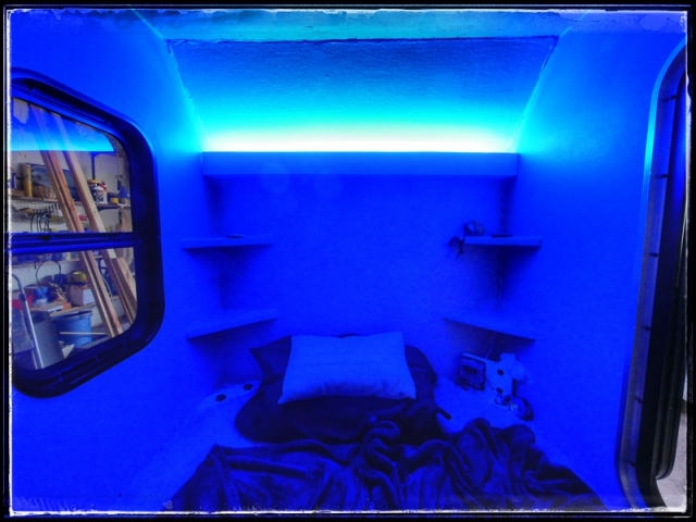

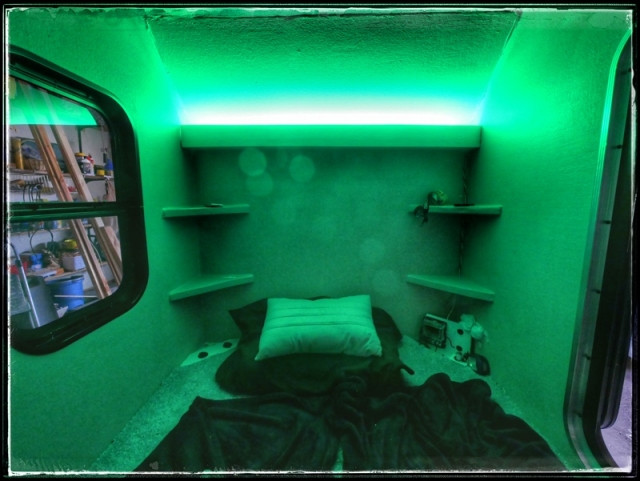

Also added a 12v color LED strip light - made a foam "L" so that it would be indirect, bounces off the ceiling 45 degree panel:
This is "mode normal":
But can be adjusted to be any shade or brightness lever of 4,096 colors:
also does "dancing colors" from slow/mild to fast/wild :-)
Has a "night light" mode that is orange...and turns off automatically after 30 minutes:

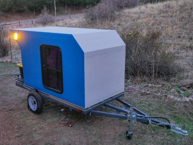

Postby JazzVinyl » Mon Apr 20, 2020 8:56 pm

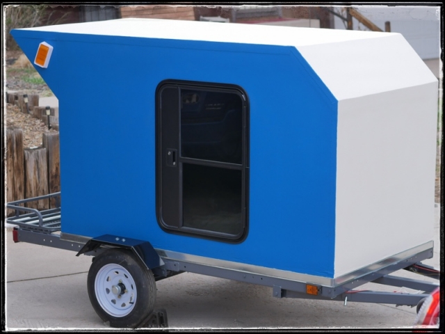

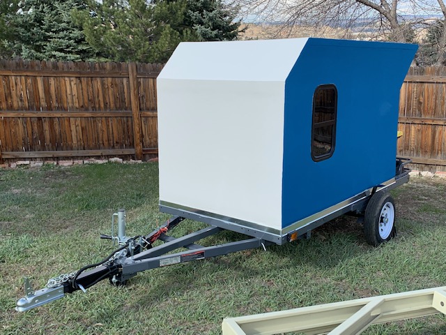

Camper has been moved out of the garage and into the back yard. let's see how she takes the weather!
Here is the "porch light", working:

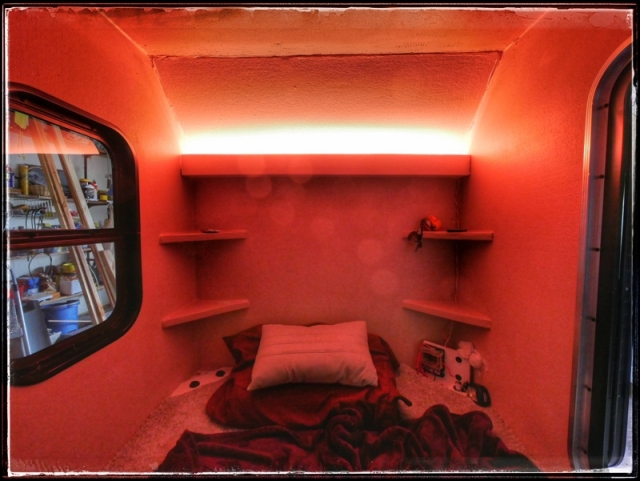

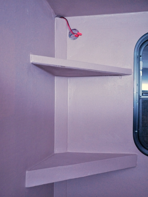

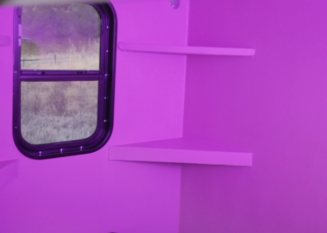

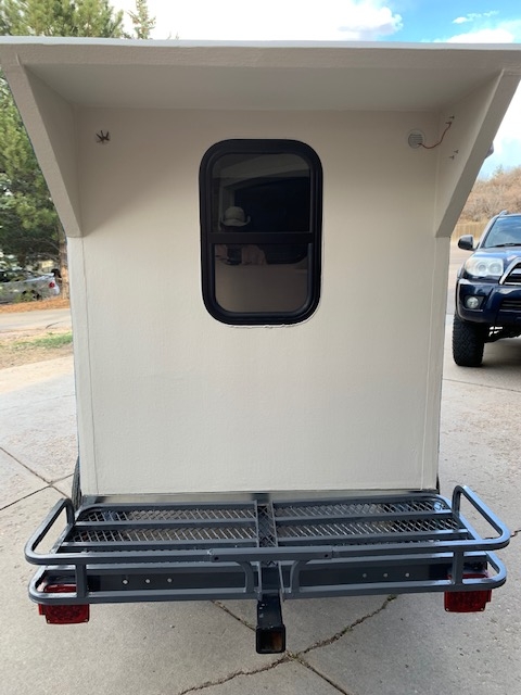

I added a second rear triangle corner shelf (innards are not this color, this is from my LED light):
I found that while there is room for me and my 30lb dog...there is not room to store anything on the floor area, that is why I added the extra set of corner shelves in the rear. I also modified one corner to hide the wire that gives the porch light its 12v. I used a little triangle of foam and removed the corner peak to allow for the wire to be behind, and run up and out the vent to the porch light. Wire shows at the top and that was intentional, in case it ever needs servicing (color is from the "many color" LED light):

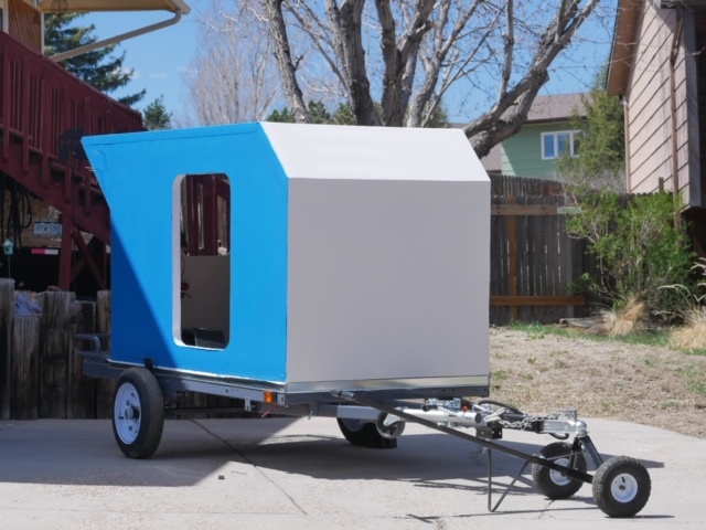

And took her for a little test drive today. definitely pulls like nothin' there....stopped and made this photo today, at approx 10 AM (04/20/20):

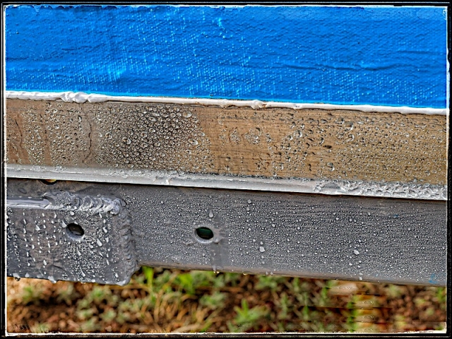

We had a little rain last night and happy to report that it appears the drip edge - works:
Watched water come down the canvas hit the caulk, and continue on down the drip edge.
