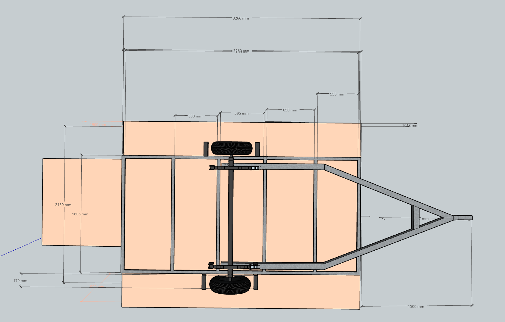

tony.latham wrote:Is the axle in the middle of the chassis frame? It looks like it needs to be moved a bit aft?
Does this look ok?

The axel position is representative in the Sketchup drawing but the way the axel is mounted to the frame and how the frame looks is approximated

Does this look ok?
As long as you get greater than 50% of the weight ahead of the axle.

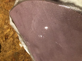

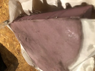

Here’s the back side of my test piece. No surface prep, yes the basement is dirty and no, I’m not concerned with the appearance because this is for compression testing, not final surface. Don’t judge me. I applied a layer of epoxy smoothed with a stick then 'soaked' the 6oz glass into it. I smoothed it with the same stick, then put it up in a vertical position to cure.
This is the previously applied side, I took my leftover epoxy and smoothed it out over the glass with an old brass hinge. I said don’t judge me. You can’t really see it well but the surface is very smooth, but there are raised and lowered areas. If I had created a tape dam around the edges and poured on the epoxy I’m confident it would have flowed out and formed a uniform surface suitable for interior work. I realize this application will not provide any durability as the base layer of epoxy had already cured, but again I’m going for effect here, not utility.
I have two more days for full cure, then put a bolt and washer through it and see how much I can crush the foam.

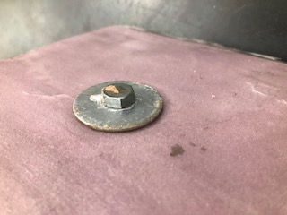

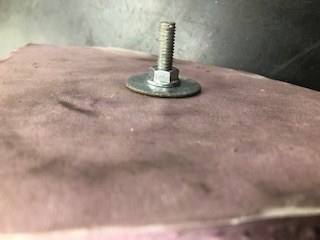

Postby kstills » Fri Jan 27, 2023 7:03 am
Pics of the compression test. The bolt might be a tad bigger than required for the intended application, however it did allow me to tighten it with a socket wrench. Front and back sides (clear epoxy on front) and you can just make out from the picks that the washer was compressing the XPS as it was tightened. I could very easily have tightened the bolt so that the XPS would have been substantially thinner in this area.
