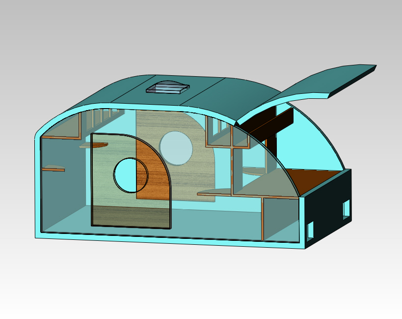

Hi, new here but I've been following with great interest. I'm looking at maybe someday building an ultra-lite 5x8 TD and I like the foam/Tightbond/fabric (FTF?) concept. Once, a long time ago I worked for a prop builder in Seattle and this thread reminded me that I help build a costume using this technique. It was a truffle costume for some poor schmuk to wear on a street corner and hand out promo materials for a local chocolate shop. It was a foam box, sculpted to look like a piece of chocolate, with arm, head and leg holes. It was covered with an adhesive and fabric and paint. It was very real looking and very strong (and warm).
Anyway, here is a design concept I've drawn up for a 2" foam skin. Still working on it:

Postby eaglesdare » Wed Apr 13, 2011 10:53 am
the only thing i would be concerned about in your sketch is the shelving. i would add some support posts, and these could be alined in with the walls. i would worry just slightly over time about the pull of the wood on the foam. just my 2 cents for what ever that is worth. :lol:
my td is almost like your drawing. i have that 1/2 wall in the back with that wider flat piece on top. that will make a good bunk bed for a kid. and your flat out bottom piece i have that, but mine flips out and up for a counter, inside makes for a nice storage area. but if you cut out a breathing hole, could make for a nice 4th person kid sleeping area also.
mine td is also a 5x8. i believe it to be slightly wider than the five feet though.
i think the 2" foam for the roof is going to be a bit harder also, unless you can bend it. we had to score the 1" foam for mine and it came out nice. not sure about the 2" but we did not try it.
good luck on your build. and keep those wooden doors! :lol:

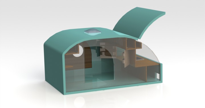

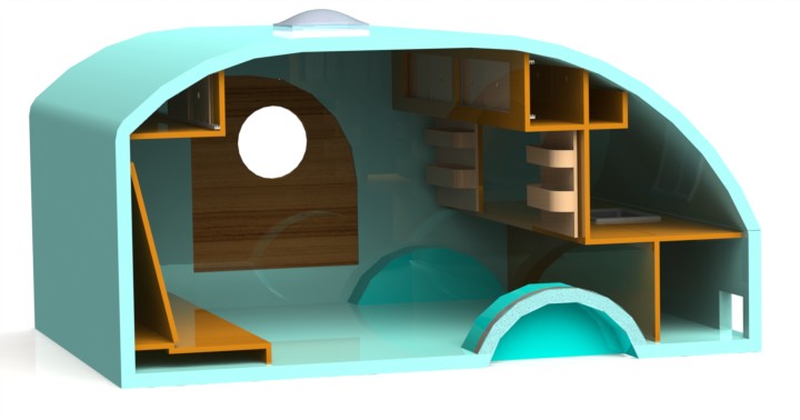

Postby HandyAtLeast » Wed Apr 13, 2011 12:14 pm
Thanks all. Eagle- right about the shelf supports, I just didn't bother modeling them. Uploaded two new renderings. Added: sliding doors to the cabin cubbys, sink and storage hatches, and interior storage doors for access to galley from the cabin. Sink and cooler access from the cabin is a must for me, but I want them in the galley.

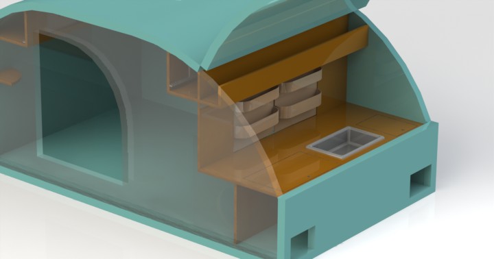

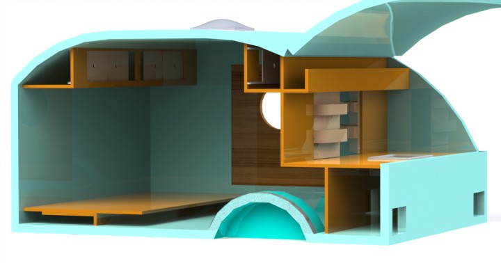

Postby HandyAtLeast » Wed Apr 13, 2011 1:54 pm
Thanks GPW! I've made some more changes and increased the width to 72" and added wheel wells. I added a bunk that folds up into a couch across the front of the cabin. The cubbies over the couch might not leave enough headroom for comfort, so those will probably get smaller or go away.
