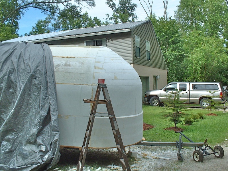

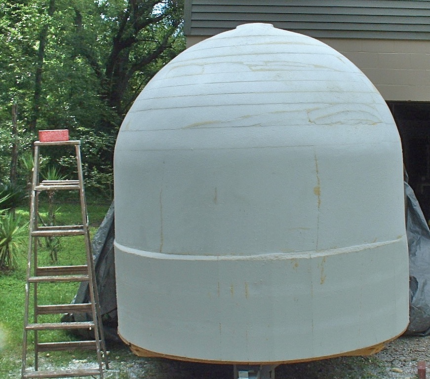

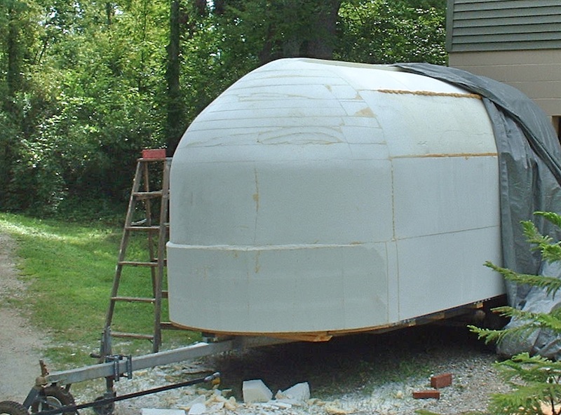

Curious ... On the top where the “keystone" joins the nose , was thinking of just blending it into the top of the nose and leaving that ridge along the top (a trolley top... sorta’ ‘ish ? ) .. That way I wouldn’t have to cut sand all that foam off the top all the way to the back ... would be a tiny bit stronger too .. :thinking:
Small as this trailer is :roll: , it’s still difficult to work on the top with just a ladder... A “bridge" over the top would make things easier for “production” purposes.. might have to mention that at the upcoming Foamie’ brainstorming seminar (The wife’s idea !!! :NC ) ... :thinking:

More sanding .... getting Close now :D .... and you can see that top thingie' ... just a little more adjusting the shape and we should be pretty much done with that ... Hopefully ... and it looks like Rain ... :rainy:
Ps. got a note , canvas will be here Friday ... :o

Did More sanding ... about as good as it’s going to get on my watch .... It’s not perfect , but will serve the purpose ... fairly streamline so should tow pretty easy ... especially with that long tongue ... :D Minor difference now , not worth an extra picture ... Still need a ‘filler” for leveling ..... GS doesn’t sand worth a hoot ... grrrrr!!!
W2 , I thought about that , but could run the skin up to the bottom edge of the “ridge” and then put a central strip overlapping all that on top ... There will be a seam at the top anyway ... my canvas is only 60” wide ... two seams really ... No worries ...I’ll just paint some fake rivets on the seam edges ... :lol:
And now , to the back end ... door framing first ... Got some nice #1 clear Pine 1” X 4” ... that should do ... :thinking: Then I need to get More foam ... may go Blu or Pink in the back , just for convenience... couple sheets probably ...
