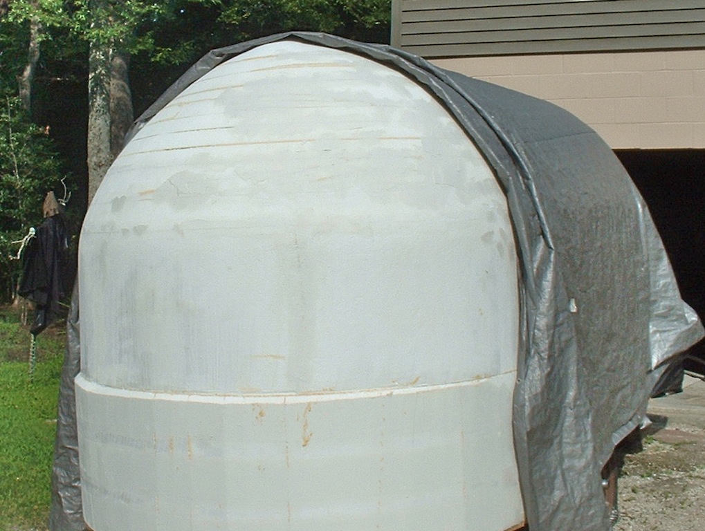

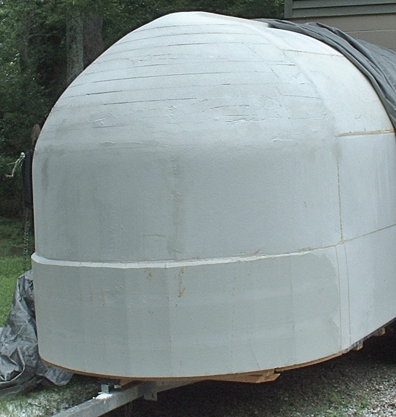

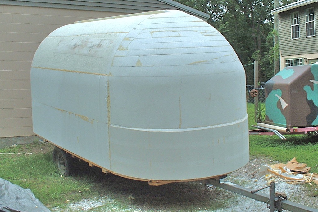

Here’s what I showed the wife this morning ... cleaned it up a bit more before the preview ... She Liked it !!! :P
I was carrying on about filling the seams and making everything really smooth ... and she said ... “ That’s not necessary, it doesn’t have to be Perfect ! “ :o She’s more into what the Inside looks and “feels” like rather than having a Beauty exterior ... and the Comfort ... so for now we’ll have a functional exterior and a Comfortable interior ... or so the High Commander decrees... Works for me ... :beer:

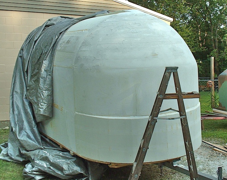

Ps. going to give the nose a coat of gripper to better determine those last remaining high spots ... easier to tell with all one color ... :thumbsup:

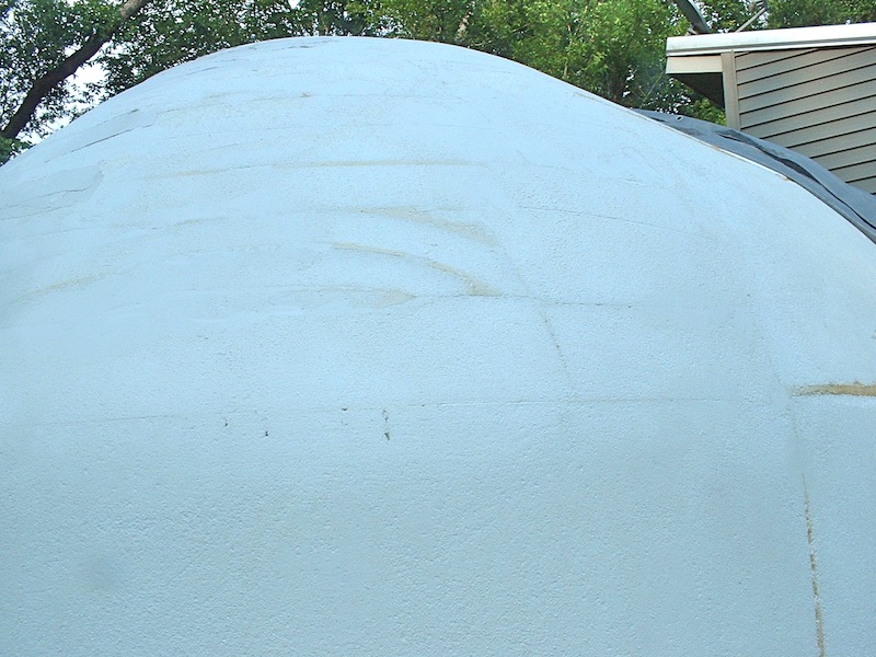

Just as I got all the Gripper on .... it rained ... :rainy: But did get a good enough look at things to see all the places that need to be filled ...lots of places ... :frightened:
Now then .... time for a coffee break ... :D

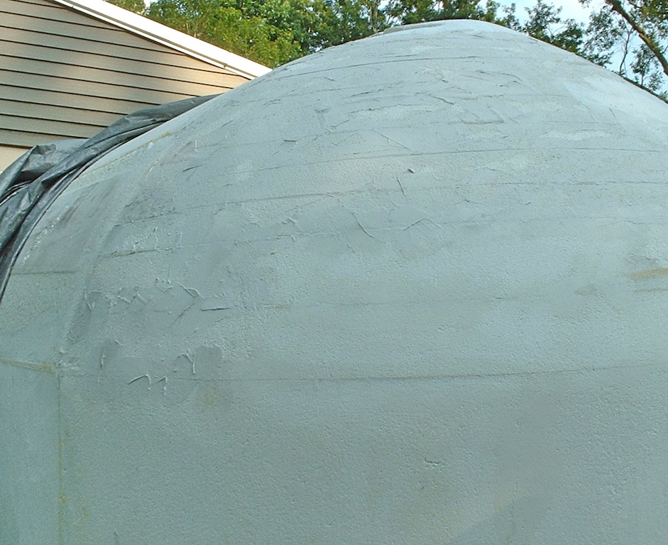

 Snuck out for a quick pic , pause in the rain ... yet another test ...Gripper in the rain ... :roll:

Rain stopped briefly , ran outside , and surprisingly the Gripper didn’t go runny ... :o Still looks like I just put it on ... somewhat tacky still , as to be expected ... tried some drywall joint compound as a filler , that stayed too ... 8)

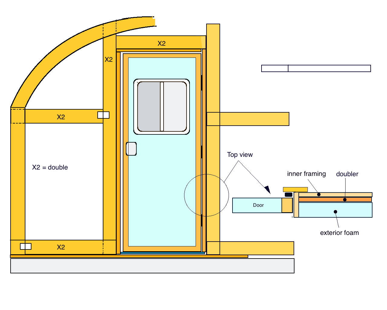

Today (if it doesn’t rain , which it is supposed to do) we start on the rear framing ... a little woodworking ... here is a drawing I was working on to help me understand what I wanted to do ... Still a little complicated for my taste , but I’m sure it’ll all come together once we start the actual building ... hopefully !!!

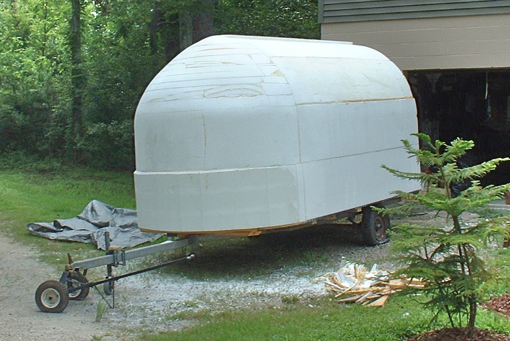

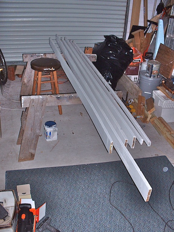

More pics ... the mud applied and drying , the mud sanded (up close) and the back -priming of the door/wall framing wood ... also got the passenger side lower panel to match the lower nose ... just more sanding ... :?
Ps. the Gripper works Super for priming wood ... sticks like crazy , dries very quickly ... :thumbsup:

Postby GPW » Fri Jun 21, 2013 6:32 pm
...and the back priming ... and hey, there’s my new little sander down on the left ... :D
