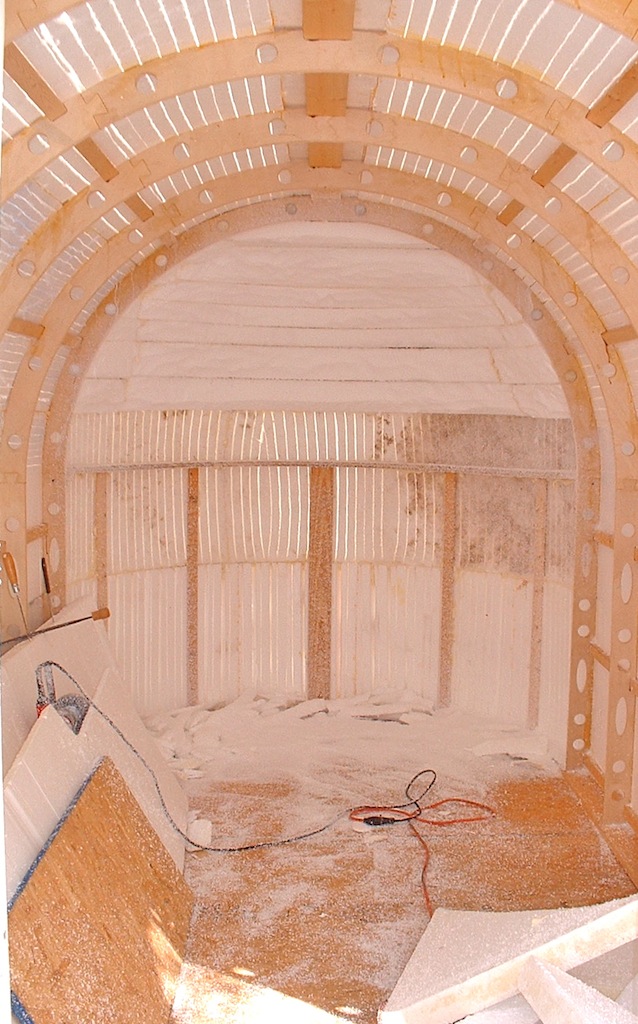

Mary , it’s the only time of day we can get some real work in without Toasting ... :oops: But still it’s coming along ... ;) Rained today ... again ... :roll: But managed to get inside the nose and do some inner carving with a coarse rasp ... less messy than the paint stripping wheel , but things are starting to round out nicely now ... The goal is to get something done each and every day ... no matter how small ... but then , little things add up eh !!! :D

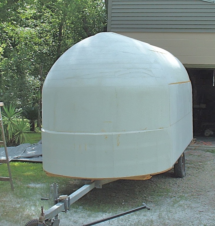

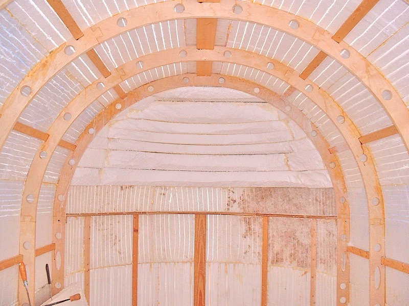

Postby GPW » Mon Jun 24, 2013 8:29 am
Got inside the nose this morning and did more rough carving inside ... with a drywall saw.... Easy to saw off big chunks at a time , much less messy . Starting to get somewhere now .... Maybe just use the wheel for the “finalizing “ of the shape (or as little as possible ) ... looking much better now :D
Re: FoamStream...
Postby GPW » Mon Jun 24, 2013 9:46 am
Got all the sanding done on the nose outside ... All smooth now , ready for covering after a good vacuuming... used "the wheel" inside to further blend the inner nose ... more mess... but much better :D
