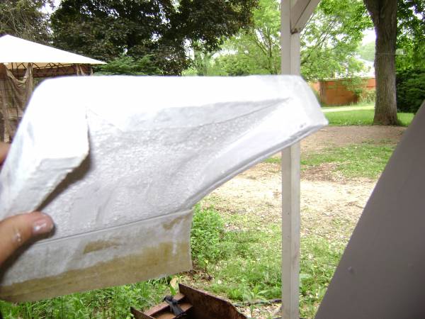

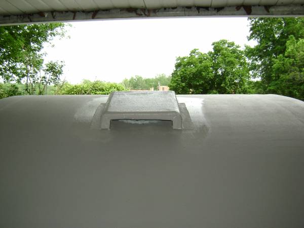

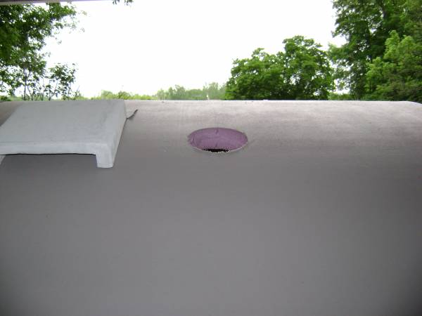

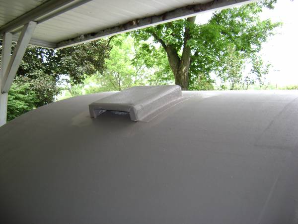

I made a simple vent in the roof of my TD by cutting a 5 inch hole in the roof with a hole saw, screening it, and installing a foam cover over the hole. I shaped the cover, very carefully on the table saw and installed it with fabric strips painted in, then pinned it through the foam from the inside with four 3 inch nails pushed through the foam at opposing angles. It stayed on perfectly for my 300 mile trip this past weekend to Slippery Rock Creek in Pa. below are a few pics.
I plan to add a computer fan to the vent hole and screen the opening at the bottom.

Postby elginrunner » Mon Jun 13, 2011 3:49 pm
Hey pat,
What size computer fan? 120mm?? How are you reducing the voltage from 12v down to 5v? (i'm assuming your using a 12v of course...)
That's a fine piece of sculpting by the way on that cover.

Postby pat g » Mon Jun 13, 2011 10:23 pm
elginrunner,
I plan to use a 12 volt battery so no reduction of voltage. As for the sculpting, just roughed out on the table saw and finished with a surform plane. There are 120 mm fans that should work or whatever my son has lying around.
