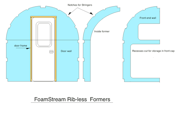

Mel, the big problem is Foamies are so much Fun to build , you just can’t have one .... I do rather enjoy the designing building part , and not requiring the expense , tools , skills , or time and Money as would be required to make a wooden one , it’s so easy to start another and have more FUN ... :D Now , admittedly, the wife still doesn’t quite appreciate my efforts , yet , but she’s getting used to the idea ... and because they’re not pricy to make , she’s more understanding .... sorta’ :roll:
Secretly , I think she'd like me to sell one before moving on to another ... which does make sense , because like building houses , the third one’s Free... 8) ;) :D

GPW wrote:Here’s some former designs ... all foam (save the door framing) ... Easy .. :D
GPW,
Why not construct scrap ply, pegboard, etc. temporary formers such as are used in building clinker-hulled boats ("lap-strake")? You could literally lay up the Foamstream plank style using foam for the planks.
Makes a good use for scrap and cuts down expenses...
Just a thought...
Tiredoldwhiteman
Sort of like this (photo at bottom-right of page):
http://www.grapeviewpointboatworks.com/ ... uild3.html

Postby GPW » Wed Sep 28, 2011 6:28 am
TOWM ... Just seems like too much work for me ... unless I was going to make a few of them ... The formers in mine will also act as walls / “room dividersâ€

Postby GPW » Thu Sep 29, 2011 10:24 am
TOWM , just thinking of trying to do the Best job I can on this one ... I learned all the RV wallpaper and moulding tricks for making them look Good inside ... hoping this one will replace the swiftly decomposing Jayco TT in my driveway ... Half the weight , half the Drag (or more ) better insulated , easy to maintain , and made to live outside ... That’s the Goal ... and at app. 16’ OAL X 6’ W X 6’6â€
