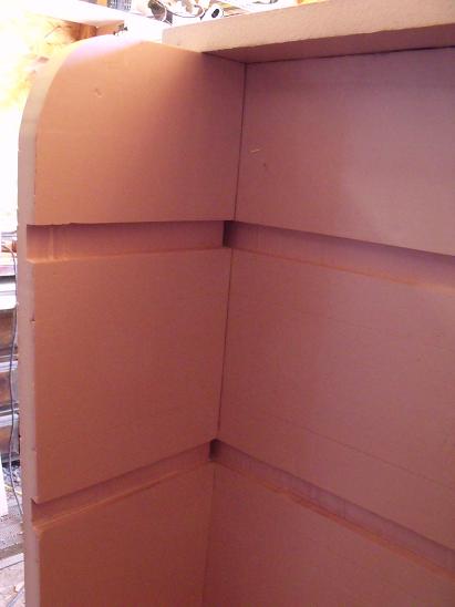

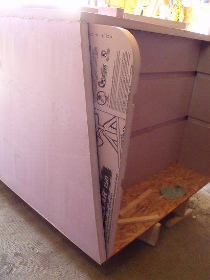

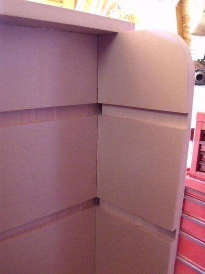

Postby ghcoe » Sat Mar 09, 2013 9:00 pm
Test fit of the galley sides showed that the channels did line up well.
Left side galley
DSCF1784 small.jpg (46.9 KiB) Viewed 3489 times
Right side galley
DSCF1785 small.jpg (48.08 KiB) Viewed 3489 times
Outer shot of galley
DSCF1786 small.jpg (55.08 KiB) Viewed 3489 times
George.

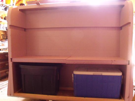

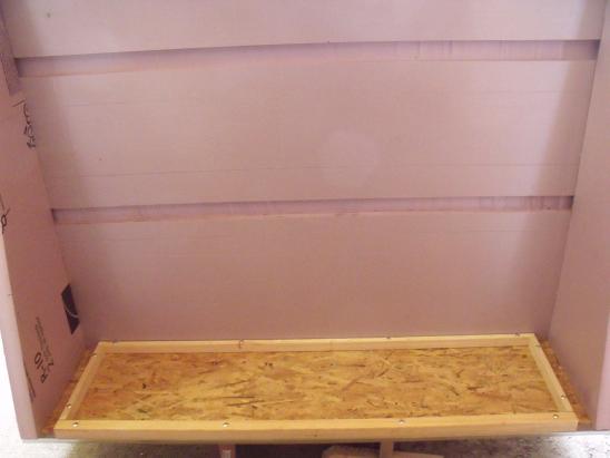

Postby ghcoe » Sat Mar 09, 2013 9:07 pm
Shelves made form left over foam from the roof panel. So far I have not had much foam scrap. :thumbsup:
Just did a test fit today before gluing it all up. Maybe tomorrow, still a few things to think about before I make it solid...
Lower galley shelf
DSCF1787 small.jpg (57.94 KiB) Viewed 3485 times

Postby GPW » Sun Mar 10, 2013 5:08 am
Really NICE how everything fits and locks together ... :thumbsup: 8) :D

Postby ghcoe » Sun Mar 10, 2013 10:04 am
GPW wrote:Really NICE how everything fits and locks together ... :thumbsup: 8) :D
Thanks! Really makes everything strong too. It is building in strength and is a lot easier than I was anticipating with the foam. :)
I am having a lot of fun with the hot wire. The shelves in back were gravity feed hot wired. Starting to get a technique down now. :thumbsup:
When I was planning on making a TD years ago I was planning on doing the dado build technique with ply or OSB. I think it makes it look cleaner and makes it stronger. :beer:

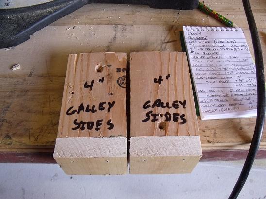

Postby ghcoe » Sun Mar 10, 2013 8:35 pm
Made some spacers for the galley frame rails today.
Galley spacers
DSCF1789 small.jpg (76.61 KiB) Viewed 3426 times

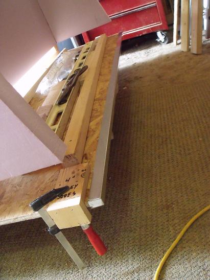

Found some trim I liked for the rear galley edge. Not sure if it is going to work out the way I want it to yet or not, but hey it looks good for now.
Spacers and rear trim
DSCF1791 small.jpg (70.74 KiB) Viewed 3426 times

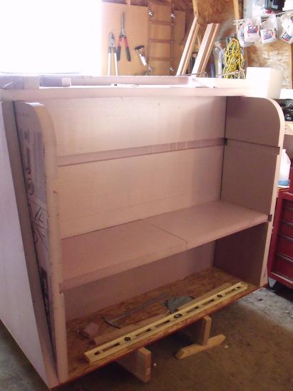

Got the last of the frame rails in place and lowered the body back down onto the floor.
Galley frame rails
DSCF1798 small.jpg (55.6 KiB) Viewed 3426 times

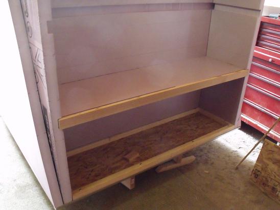

Postby ghcoe » Sun Mar 10, 2013 8:45 pm

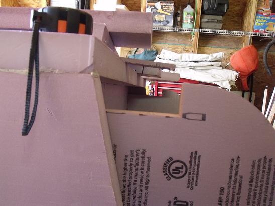

Next I test fitted the galley sides and cut the notch out for the sub roof.
Galley side notch
DSCF1800 small.jpg (67.62 KiB) Viewed 3426 times
Then made sure stuff fit ok. :thumbsup:
Test fit camping stuff
DSCF1801 small.jpg (58.38 KiB) Viewed 3426 times
And test fitted the shelf trim.
Shelf trim
DSCF1803 small.jpg (61.63 KiB) Viewed 3426 times
