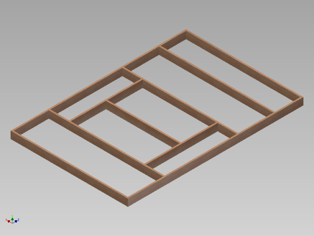

Okay, I needed to post about this, and I see you posted on my build journal already, covering some of my question. I pulled your quote here so that I'm not filling my build journal with questions though. You comment about brackets over the axle was:
KCStudly wrote:You could leave out the brackets at the axle mount. You have plenty of anchor points with the rest, the wood side rails will tie that xmbr in, and it will be bearing on the steel anyway. IMO, Skip it. :thumbsup:
However, before I saw this, as I was falling asleep last night, I realised I had done something wrong. The brackets I had not mounted almost directly over the axle where to hold another 1x4 to keep them at 18" center to center spacing. Look at these pictures and see if you can tell where I messed that up.
Fender (1) by jseyfert3, on Flickr
Fender (2) by jseyfert3, on Flickr
Yup, that's right. I forgot about the damn tires. :x Didn't help that I didn't have them mounted, if they had been mounted I think the problem would have slammed me in the face while I was measuring. I didn't entirely forget about them, I used the model, determined that the fenders would fit nicely between the 1x4s as planned...when I was planning 2' center to center spacing...
Therefore, I'm left with three options. First, move the brackets around. Second, put in a crossbeam over the axle, screwing it into only the brackets and the floor. This crossbeam would only be able to extend the width of the steel, so it would be a floor support only and would not support the edges and hence the TD, but that probably wouldn't be an issue. Third, put nothing there. I don't like that because that leaves a 3' span, which holds the bottom half of the bed. The bottom half of the bed is not where most of the weight is, but that's still a long gap.
I'm leaning towards option #2, I think the TD itself has plenty of support without the beam, so the beam would be just to support the floor there. It also will be needed to support the battery, which I planned to do an underslung mount just forward of the axle, and possibly my AC, which I'm still considering to mount in the same manner. Do you see any concerns with the beam over the axle just supporting the floor and being one of the battery/AC mounts and not running to the edge, and hence supporting the walls and the 1x4 that runs front to rear? I don't see that being an issue, I just wanted a second opinion.
What did I learn? Keep pushing forward, just make sure you measure when all relavant objects are in place or at least take into account there future presence. Good news is that this is a fairly minor mistake that shouldn't cost any money or much time. :thumbsup:

Postby Mary C » Mon Feb 10, 2014 2:07 pm
As my mentor would say Did you leave the bolts where the tire would come up and scrub against them?
106806
I put my bolts in from the underside so if I did hit a bump and the tire did bounce up it would not hit the extended bolt and blow the tire. Just a hint.
Mary C. :lady:
Mary C

Postby jseyfert3 » Mon Feb 10, 2014 2:20 pm
Mary C wrote:As my mentor would say Did you leave the bolts where the tire would come up and scrub against them?
106806
Mary C. :lady:
Thank you Mary, that's a very good point. :thumbsup:
I went out and measured, and there is about at least 3" of space between the top of the tire and the fender, and the bolts stick out a bit more then 1/2". But, the shocks can only compress about 2" before the top of the U-bolts hit the axle mount, which would stop the axle before the tire hit the bolts.
I was thinking that I may just attach the fenders to the floor of the teardrop with bolts in the corners of the flat area, that way the bolts are a long way from the tire, plus the fender brackets put the fender top about 4" off the top of the steel, it can't be more then 3.5" because that's the height of my 1x4's. Without the pointing bolts, I should be able to drop the fender at least an inch from stock to allow it to fit under the floor with 1/2" or so of insulation to prevent condensation on the inside during the winter.

Re: Newbie Looking Leaning Towards a Foamie
Postby KCStudly » Mon Feb 10, 2014 4:19 pm
Slow down a minute and think a little slower.
Let's recap: 1) you have several threads going all at the same time and it is getting confusing. There's nothing wrong, IMO, with asking for help in your build thread. If you don't get an answer, or one that makes sense to you, sure, ask in general or tips (either way, be sure to link them to make it convenient for the reader); 2) you are trying to build your floor flat with the ply supported just above the fenders; and 3) at 18 inches on center you have a xmbr that lands where the fender support and wheel are.
So I am assuming that you will use two (or more) partial pieces of ply to get the 57+ inch width with a seam 3x18=48 inches from the back, landing on one of the xmbrs and you want to extend the xmbrs wider so that the outer wooden rail passes by the outside of the fender.
Why not header behind the fender longitudinally along the frame rail on each side using the same 1x4 (...or was 1x3?), then 'T' the short xmbr into these headers. Like this...
This gives you the option of cutting the outside rail down or out completely in front of the wheel (remember that the wall supports the floor, not the other way around). That way you could change the shape of the wheel arch more to your liking and ditch the little fenders. just be sure to protect the inner fender well... well :roll: ... 'er... well.
BobHenry had a tire cut down by one of those bolts. Maybe he had the larger tires, but don't forget that in the real world there are dynamics involved that you can't measure statically; centripetal tire growth, load and impact deflections, perhaps other factors. I like the idea of moving the fender fasteners away from the tread, but the fewer holes you put in your box, the less likely you are to have water get in and rot. The wheel wells need special attention because they will be constantly abused by sand, pebbles and flung water trying to attack your attempts to seal.
