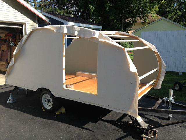

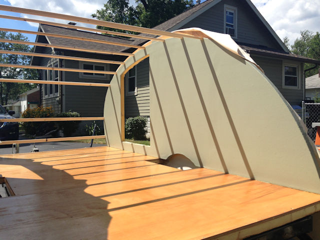

I trimmed the second side today, and glued the canvas edges down.
Here are the sides, finished with a few layers of TBII.
Also painted the insides with a color from Behr called aged eucalyptus...

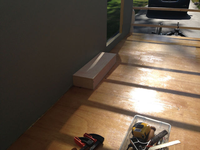

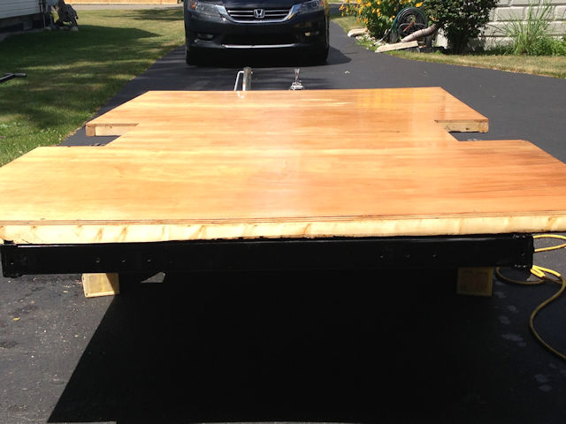

And put more poly on the floor; there's also the mix on the edges of the plywood floor, and certain important end pieces!!!
Re: The Mad Dash begins...

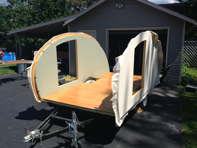

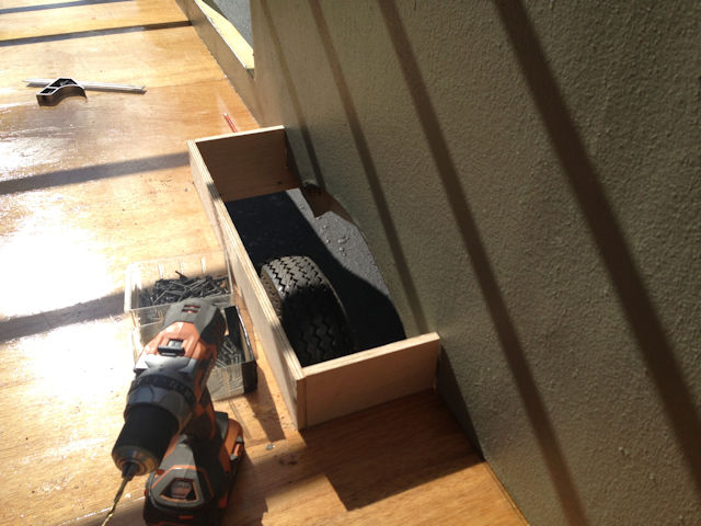

Postby mikeschn » Sat Aug 01, 2015 6:36 pm
Then I glued up the walls...
Glued in the spars
Built up some wheel wells
Covered the wheel wells
And installed the BAL trailer stabilizers, and started trimming the canvas on the bottom...
That's enough for one day. What do you think?

Postby redwing1967 » Sat Aug 01, 2015 6:59 pm
Looks very professional. Hope my first build looks half as good as that. :applause:
Not sure if I missed it or if you didn't mention....where did you get the canvas from? I don't see any seams. Special ordered?
And how far are you from Howell....would love to see this in person. :o
Postby mikeschn » Sat Aug 01, 2015 7:04 pm
Hey Redwing,
KC recommended Big Duck. That was a really good recommendation! :thumbsup:
viewtopic.php?p=1136754#p1136754
I'm in Lake Orion, not far from you. PM me when you are ready to swing by!
Postby KCStudly » Sat Aug 01, 2015 7:27 pm
Looks awesome, Mike, and really coming together fast. I don't seem to have that gene. :R

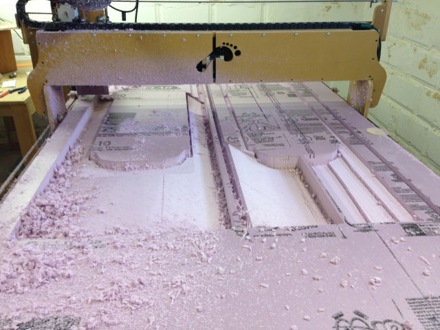

Postby mikeschn » Sun Aug 02, 2015 11:26 am
Thanks for all the comments. Unfortunately there won't be much to show today, as I am working on stuff that just takes time.

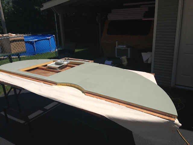

For example, I am cutting a roof panel, that is going to hold a window. Now THAT takes time!!!
What you see on the left is the outside half, on the right, the inside half...
