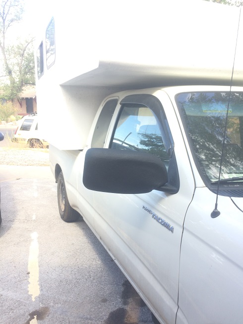

I put down 3 thin layers of cotton t-shirts and titebond on the mirrors and let them cure for a week. They were ROCK hard. When you tapped the unsupported part of the mirror (the cutout for the OEM mirror, where there is no foam backing) you could feel the whole mirror ring.
48 hours ago I painted them with Gripper.... Now they are very, very soft. They went from feeling like fiberglass to feeling like cheap cardboard. :thinking:
like I said, it is extremely noticeable because there is NO foam backing the PMF in the mirror cutout.
Has anyone else dealt with this?
I am planning on finishing them with spray truck bed coating: http://duplicolor.com/product/bed-armor-truck-bed-coating-aerosol

Postby GPW » Mon Jul 18, 2016 6:57 am
This stuff dries SLOW !!! Latex/Acrylic products require a good week of drying to fully harden .... be patient ... and support your PMF .... By itself it’s not so much , with backing , it’s SOLID !!! It’s like a system , a symbiotic relationship between old T-shirt , glue and foam ... ;)

Postby seanc » Mon Jul 18, 2016 10:39 am
GPW - I am moving in 6 days, so going slow is not an option! The mirrors stiffened up significantly when I moved them from outside (sunny, 100 degrees) to inside next to the A/C (70 degrees)...
Here they are with Gripper and a coat of truck bed liner. Honestly, they look a lot cleaner than I expected. I'm planning on gluing/sealing them with RTV silicone. They are already held on with a very tight friction fit. bumping/hitting them when walking by makes the entire mirror assembly collapse at the "elbow" without affecting the coupling of the OEM and tow mirror. :thumbsup:

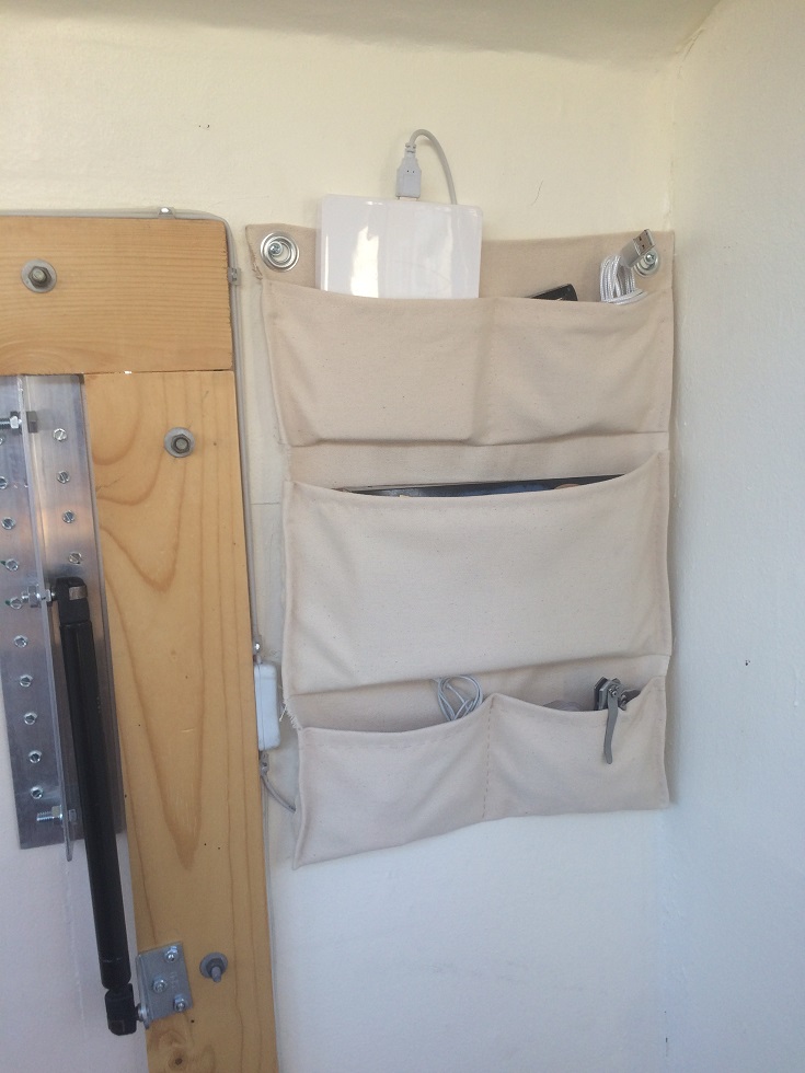

I sewed a little wall organizer to hold my 5v batteries, headlamps, etc. Turned out great! Next time i'll buy a sewing machine instead of doing it by hand :?

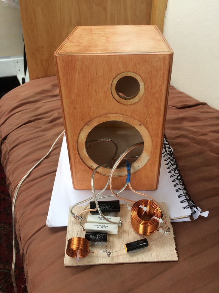

I built a pair of small two way speakers in the truck. All gluing, staining, soldering the crossovers, and final assembly took place in the camper. They're powered by a 12v, 50 watt 2 channel amplifier which is wired to the starter battery OR runs off of 8 AA batteries.

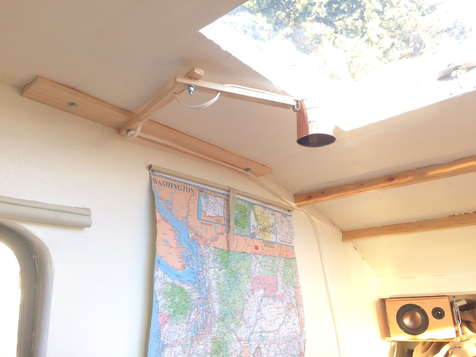

I built a pair of swing arm lamps out of pine and copper mugs from goodwill. They draw 5 watts each and are wired to the starter battery.

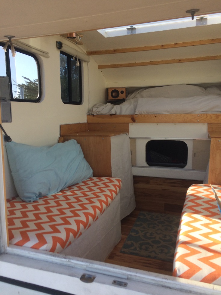

Here is a recent shot of the interior.
I installed a pergo floating floor, bought a sewing machine and reupholstered the cushions, and made "skirts"' out of drop cloth to hide the under cabinet areas.

Postby John61CT » Wed Mar 01, 2017 12:41 pm
Sorry if I missed it, how/where do you get full-length sleeping?

@john61ct - The middle of the sitting area fills in to make a bed that is approximately 6' by 4'. I am 5'10" and sleep diagonally.
