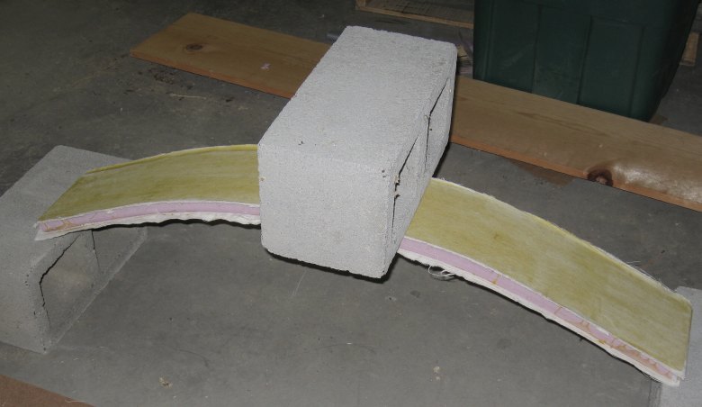

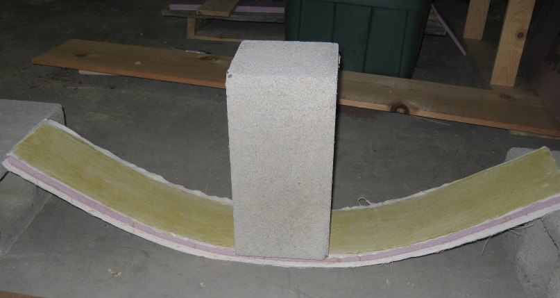

This is interesting. My PMF is exhibiting a huge level of CREEP! :shock:
As I reported earlier this panel initially sagged a little of over an inch under the weight of the concrete block. Just for fun I left the block on it (about 1.5days) to see what would happen, and it sagged all the way to the ground! I don't know what the temperature was in the garage, but it's been 30s to high 60s outside.
The panel doesn't appear to broken in any way though and seems to retain stiffness that is very close to what it had before. I flipped it over and it has no trouble holding up the block with minimal sag. I do expect that gradually creep and flatten out over time.
PMF certainly has interesting properties! You wouldn't want to put it in a situation where panels are constantly loaded, but so long as that is avoided this creeping behavior is just a curiosity.

Re: A more durable Foamie?
Postby rruff » Wed Feb 22, 2017 3:15 pm
Just went out and checked on it, and it was already past level. Maybe an hour? It happens pretty fast.
I put the FG panel in the same place but with 2 blocks to see what happens to it. I'm concerned that the foam might be creeping rather than the TB2.

That is interesting, but you might have just stumbled onto a way to curve foam without heat! :thumbsup: GPW has talked about this for some time trying to figure out a way to heat foam panels to make nice non-kerfed curved panels for foamies. This might need more testing with a full sized panel now. :twisted:
George.

Postby ghcoe » Wed Feb 22, 2017 8:57 pm
I am wondering if maybe the TBII is still not totally dry yet. :thinking:
George.

Postby rruff » Wed Feb 22, 2017 9:54 pm
ghcoe wrote:I am wondering if maybe the TBII is still not totally dry yet. :thinking:
It's had a long time. I haven't kept track but it's over a week.
If you google "titebond creep" you will get a lot of hits, so I think it's normal for this glue. I don't think it's a problem for a camper, so long as you don't put a big load on the roof.
Just checked the FG piece and it isn't showing any signs of creep.

Postby GPW » Thu Feb 23, 2017 8:20 am
... Just FYI , a wooden board will do the same thing with a proportional amount of weight on it ... plywood too ...

Postby rruff » Fri Feb 24, 2017 9:16 pm
GPW wrote:... Just FYI , a wooden board will do the same thing with a proportional amount of weight on it ... plywood too ...
I tried it with the FG sample with double the weight and it sagged ~1/8" after a couple days. Currently I have 3 blocks on a 48"x15"x1" piece and it hasn't sagged at all after 8 hrs. So if these do creep, it's a lot less with an equivalent load.
PMF skins certainly have interesting properties. I don't think creep is an issue unless you wanted to carry a load on the roof or something.
