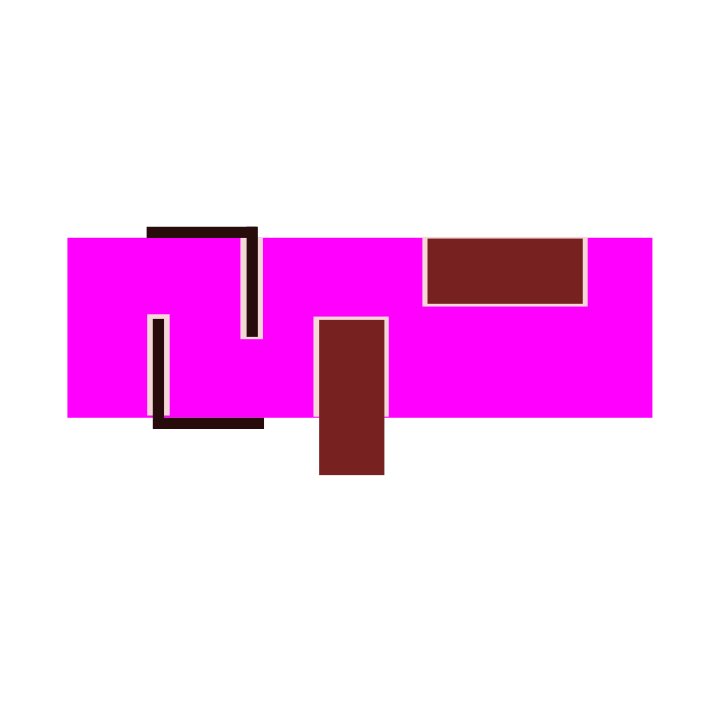

Slots or channels could be channeled into the foam for wood, aluminum, or steel to help with side to side, overhang support. With me a hot wire could cut out a channel for a 1"x2" or 2"x2" every so often. They could be channeled inside (for more protection) or outside. Installed with GG it would be rock solid in the foam. Also, a slot could be cut to accept one side of angled aluminum or steel. Just channel and glue in the angle.
Samples of methods. Not all used together like displayed.
Floor sample
Floor sample.png (3.99 KiB) Viewed 759 times

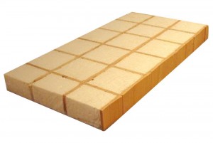

Something like this (but with top & bottom skins)?
http://singcore.com/product/structural-core
I think it's time to build another one...
Postby mikeschn » Mon Apr 10, 2017 12:25 pm
Exactly... a torsion box, filled with foam!!!
