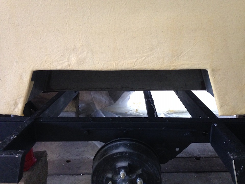

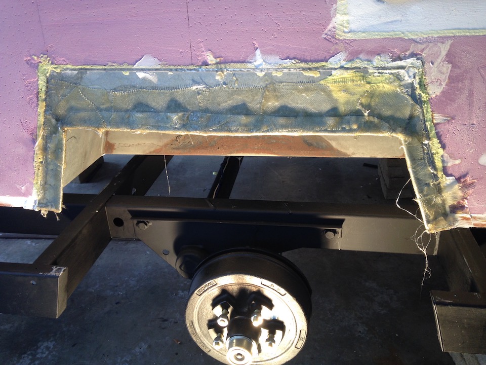

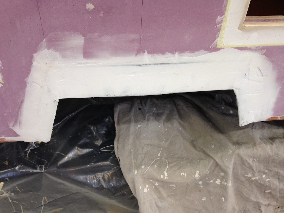

I wanted to put some more pics of my wheel wells up. I covered the wheel wells in fiberglass to prevent the sharp metal edges from cutting the canvas covering when it was applied. My fiberglass had rough resin edges of its own but I was able to grind those down and get relatively rounded edges. I then painted what exposed metal was left along with the fiberglass, I used Bonds Primer from Menards. It is comparable to Glidden Gripper. Then I filled in the top with light weight spackle and blocked that down until it was reasonably passable.
In the first pic you can see how I wrapped the wheel wells in fiberglass. Its ugly in this pic.
Second pic one of the wheel wells covered with light weight spackle and blocked down.
The third pic is of the wheel well covered in canvas. The canvas wraps right around to the other side. Turned out pretty good.
FYI:
I am soaking these huge sheets of canvas in a 5 gallon bucket full of tightbond and water before applying the canvas to the wall of the trailer. As you can imagine the canvas comes out of the bucket very wrinkly. In the third pic it looks like the applied canvas is wrinkled all over. While the wheel well spackling job was lacking and not entirely monolithic I just want to say all the wrinkles you can see are not really there. The canvas is flat. Its like you can see the memory of the wrinkle in the canvas even though it has been flattened out. I might have a wrinkle here or there on each side, but over all they all came out very flat. Up close you can see all the patterns of the wrinkles that were there before the canvas was applied.
Hopefully they will disappear under the paint.

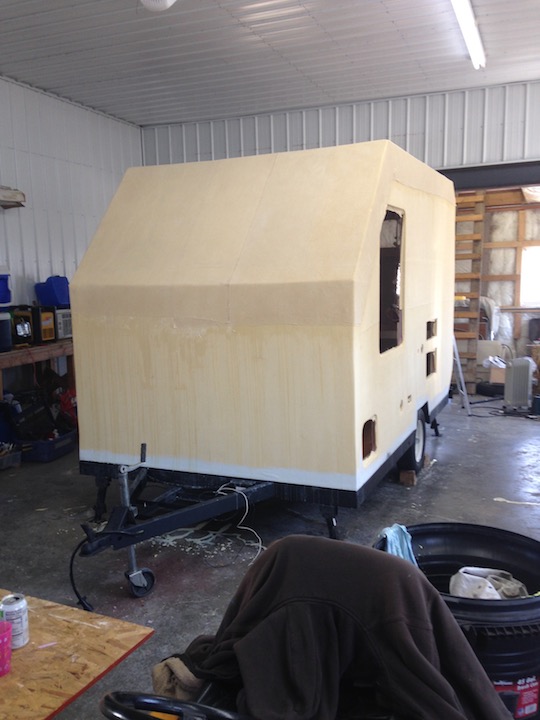

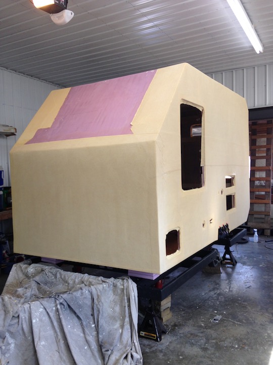

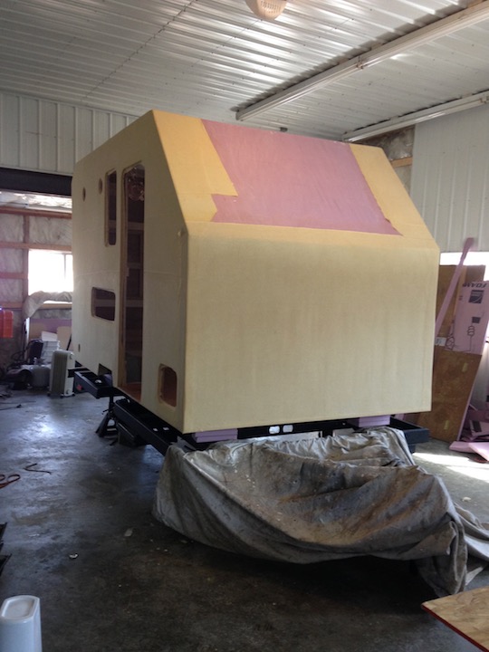

Here are the other two sides of canvas. The two long side walls were a bear. Most of the seams are still looking good to me. Next step will be to paint the bottom and then bolt this camper box to the trailer frame. After that I'll drop the frame real low and get busy canvassing the roof. Which I now understand should be easier and will be less messy and should go much faster.
8)
Every day is a step closer. :awesome:

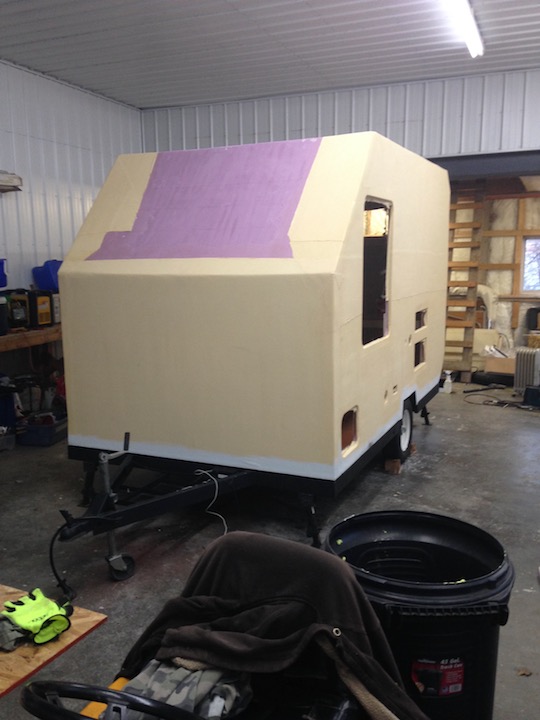

Thanks GPW! Yeah its rockin along. I'm sure it will work great. This thing is a tank. If something runs into it I think a corner will crush or a hole will form before the walls shift or collapse. Nothing like any other camper I have owned. Its also very light.
I put the camper box back down on the frame today. The canvas wraps around the bottom of the camper box at least 4 inches on every side. The bottom of the camper box was all painted with Rustoleum Oil Primer then Black Rustoleum Oil Paint. Nothing is getting through. I also drilled a few small holes to run my battery wires and my tail light wires up into the box. I sealed those holes with some water proof latex caulk. I was sure to punsh the caulking all the way through completely filling the hole and locking the wires in place. I dropped the camper down on the frame. With the camper on the frame I had to adjust it a little, even using the awkward hand holds I could find I was able to pick up a corner/side of the camper box and shift it around on the frame as needed. This camper box is lighter than a ave sized piano. I did find either my camper box or the factory made frame is just a tiny bit out of square. My guess is the box, I just split the difference. I doubt anyone will ever notice its maye 1/8 inch off diagonally. I got under the camper and used a drill and some finish nails to mark out four good attachment points for the box. This way when I got into the box there was no guess work I could just drill right between the two finish nails in each corner of the box and I hit dead center of every steel frame crossmember I was aiming for. (I did go back and fill the finish nail holes with caulking too, just in case) I used 4 1/2" thick stainless steel bolts and lock nuts (one in each corner) to bolt the camper box to the frame.
Below is a picture of the camper bolted to the frame, with the wheels on and lowered to the floor off the jack stands. Tomorrow the roof will go on. Friday we will start painting. Its going to be all Rustoleum oil paint. I'm going to try to get it tinted to match my tow vehicle (Blue Highlander), we're just going to paint the camper all one color and I'll stencil our family brand onto one corner.

The last pieces of canvas went on today. It feels good to be done slopping wood glue all over everything. Yes I posted another pic, lol.
Painting (with latex paint, oil paint melts foam :oops: ) will begin on Friday. I'm going to take the rest of today off. The weather is nice here today. Think I'll grill some chicken and we can all eat it out on the deck.
