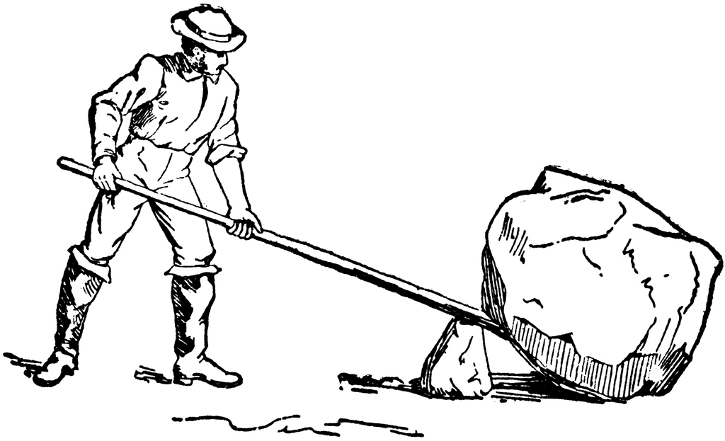

Goos, Cool illustration !!! Levers , looks like that’s the thing to do. I’ve participated in the lifting of a "shotgun house" in the past , using just wood and bottle jacks , so it is doable … but will take a long time … With Four guys it’ll take 5 minutes or less … Still thinking about this … and no, we’re not beyond using the Foamie Ballast idea , me&z … altough we’d consider that a Last Resort ... :lol:

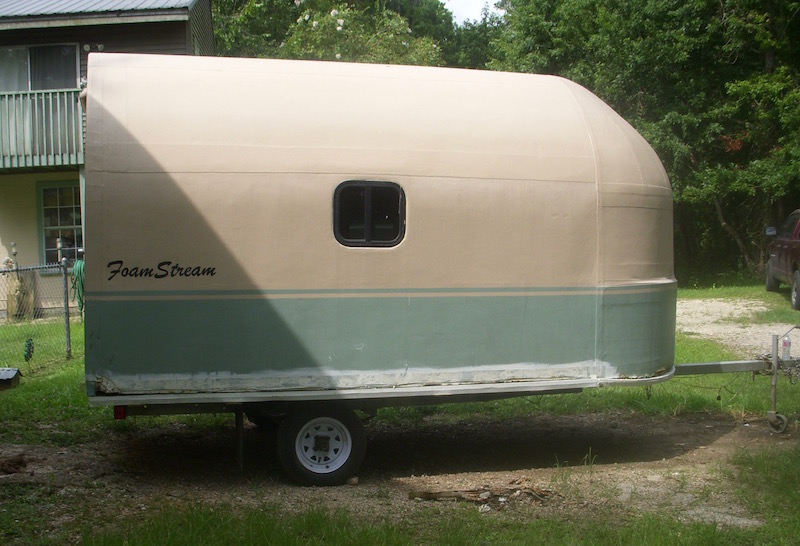

Postby GPW » Sat Jul 14, 2018 11:34 am
“ Well then , out of desperation and a patch of dry weather , My Assistant and I , recalling the ancient Egyptian methods and Goos’s illustration ^ , used a combination of blocks ( concrete ) and Levers ( 4X4 s ), and a floor jack ( not very Egyptian   :R ) ... to lift the cabin and then using PCV plumbing pipe , roll it onto the trailer … All Good now … And it gave me a chance to reclaim my Studio space , returning things to a somewhat Normal condition… for the time being …     It’s a quick job now to finish the repairs and re-canvas / paint the lower areas… The hard part is over … TG !!! “ It’s Miller Time “ … :phew:
