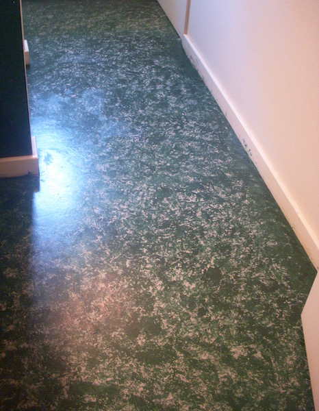

Postby GPW » Sun Sep 15, 2019 5:17 am
That paint trick works great, looks good … I used a similar method to re-do my bathroom floor ;)
Floor .jpg (117.94 KiB) Viewed 1691 times
