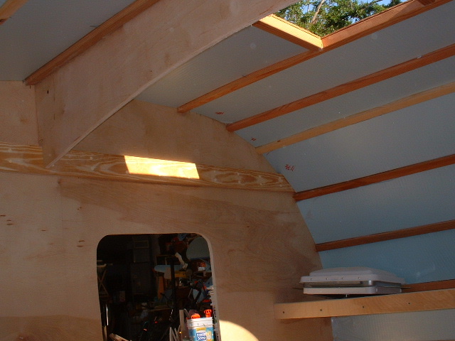

Here's a pic of the ply arch I used in my 6X12 X5H TD.. same principle Image

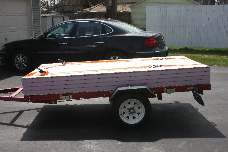

See what you made me do today...
Now I just gotta figure out what I am going to cut... :?
I found the 8 oz canvas at Home Depot. A 9x12' piece is $19. And the glue is $15 a gallon. I think you got me... hook, line and sinker!

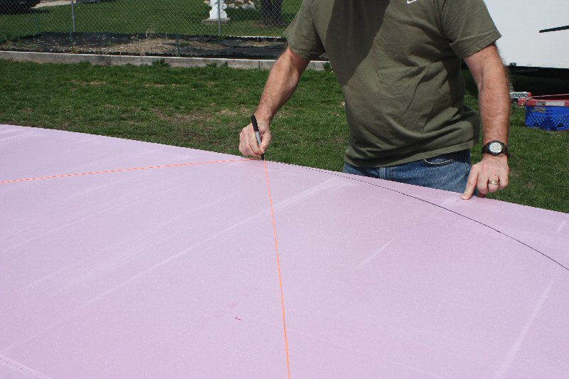

Laying out a design that Andrew did for me years and years ago...
Postby mikeschn » Sun Apr 24, 2011 4:05 pm
Cutting out some stuff!
Postby GPW » Sun Apr 24, 2011 5:07 pm
Gosh Mike , with your experience and a most competent helper , this should be a real Quickie build ... You done yet ??? :roll: :lol:

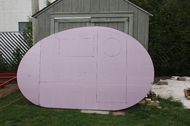

Here's what the wall ended up looking like...
I'm standing next to it to put the size in perspective.
and in this picture you can see the rest of the door and the window.
Postby GPW » Sun Apr 24, 2011 5:32 pm
WOW!!! That's BIG !!! :o Nice shape too .. 8)
