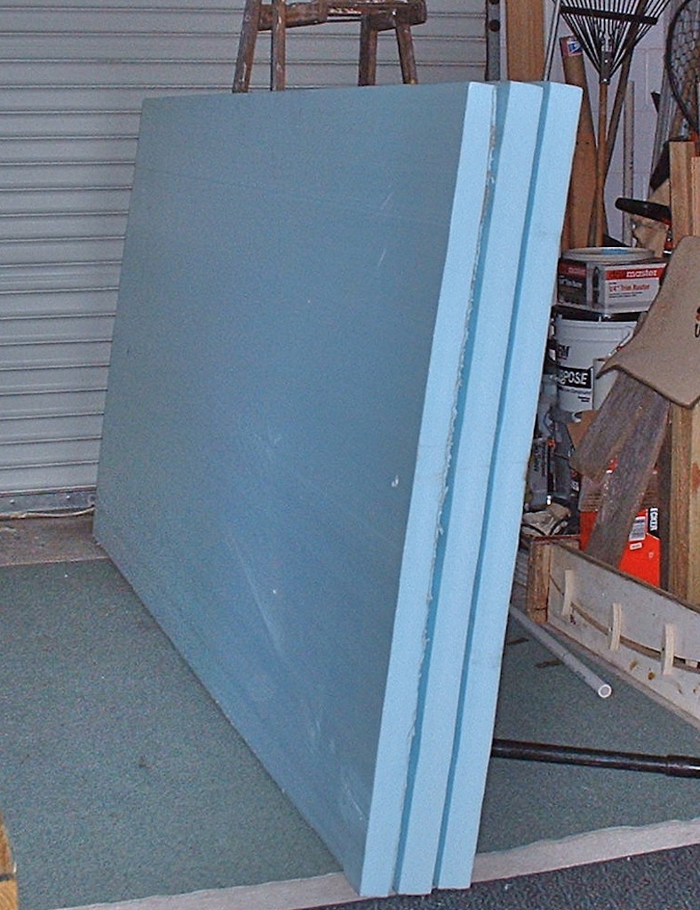

Aahhhh !!! FOAM SWEET FOAM !!! :D ... and at home :thumbsup: .... only needed two sheets but I got an extra just in case... This stuff is so extremely difficult to find around here (?), didn’t want to have to run out for more later ... :roll: And now , on to the back wall and door ... 8)
Re: FoamStream...
Postby Mary C » Tue Jun 25, 2013 1:32 pm
Looks like were moving right along. Great find on the foam it looks short to me in that pict. is it 4x8? Keep going!!!!!

It’s full size , I brought along a tape ... nice and clean too , no dents ... 8)

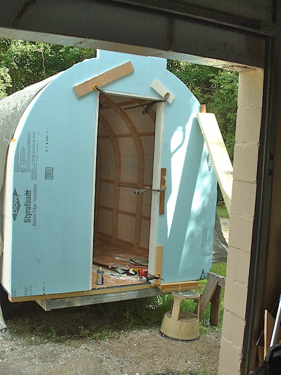

Got the two big pieces cut for the back ... found it easy to clamp too ... :D

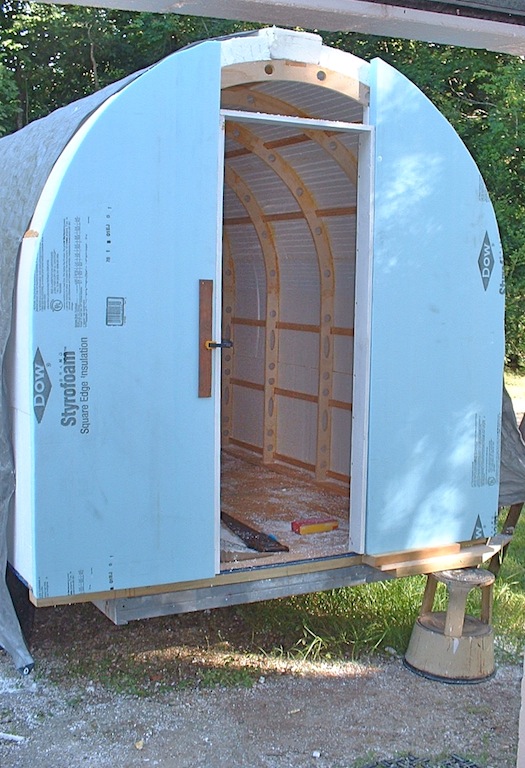

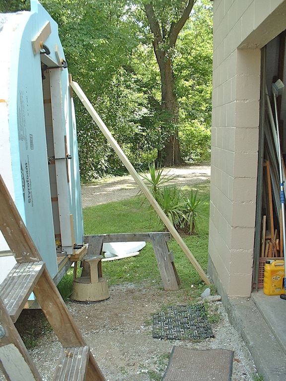

Thanks Eagle !!! Here’s the latest pics , all glued up and my somewhat “Crude” clamping system :oops: ... I must admit I broke with reasonable thinking and used the Great stuff to glue everything , which has worked well thus far , and we had a bunch of it , and it’s like a "Super Glue" for Foam... dries Very quickly in this 90F + heat ...
When the CAO (Chief Acquisition Officer) presented me with the grocery list , I told her there were so few things to get , it wasn’t worth it to drive the 30+ miles there and back again ... so the GG was out ... :o
