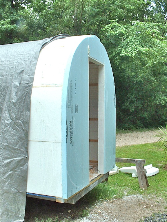

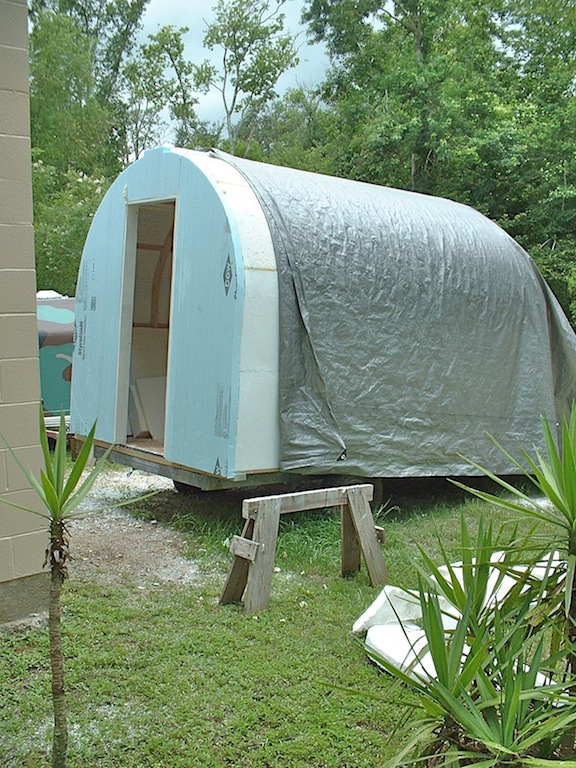

Top cut and trimmed to fit the keystone topper.... back rough sanded flush with the sides ... Almost done here...everything solid as a Rock ... Now on to the door ... :frightened:
Ps. just thinking it would be Nice to have a little porthole style window right next to the door in the Mini Galley area... The door would have a window too ... naturally ... :thinking: Just a little more natural light for cooking /food prep ...finding the Beer opener... :lol: :lol: :lol: :beer:

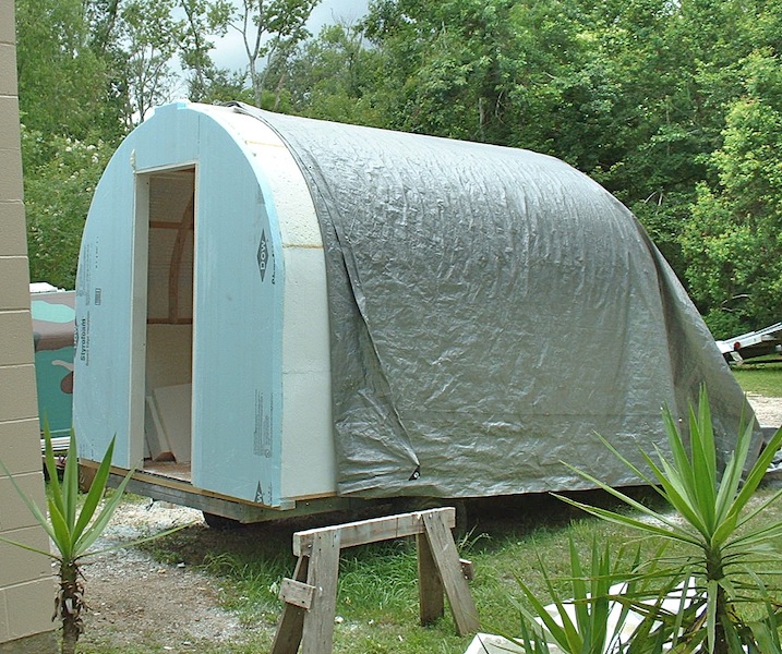

How 'bout more pics, like a stand-off quartering rear view?
Mike

Re: FoamStream...
Postby GPW » Wed Jun 26, 2013 12:03 pm
OK, give me a few minutes to cool down first ... plenty HOT today ... :sweaty:
Re: FoamStream...
Postby GPW » Wed Jun 26, 2013 12:21 pm
Mike , this is about the best I could do without moving the trailer forward , which frankly isn’t going to happen on those flat old tires... :roll: Which brings up another question , Tires, rims and fenders ??? :thinking: No idea what to do about that yet ... :NC

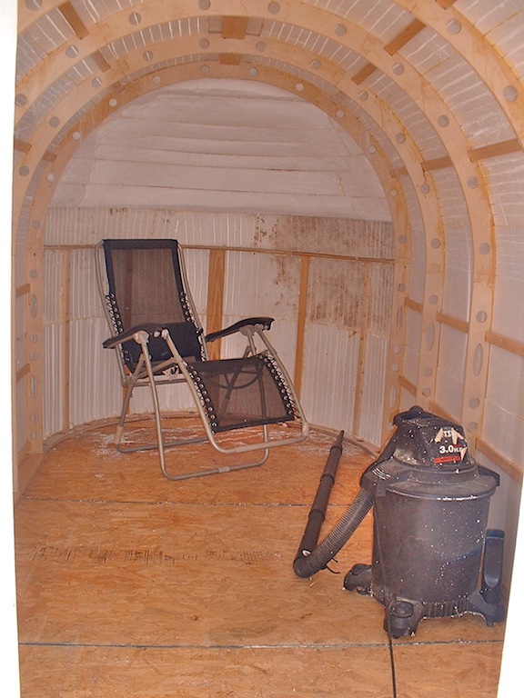

Thnx, that's great. I'm trying to visualize the interior space. Could you maybe put something inside of it to give it scale, maybe camp chairs or something? Are you building the door, or do you already have something?

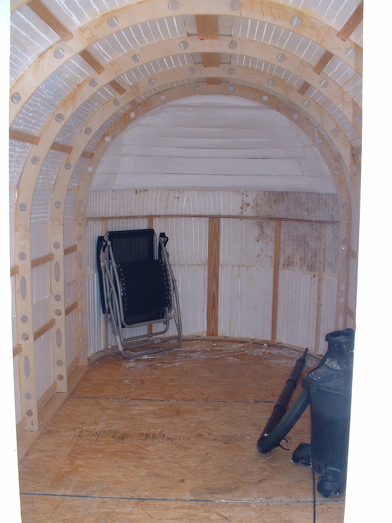

Here’s a shot with one of those Cloud 9 folding recliners everyone has ... and a shop vac...
Please note the interior nose rounding is almost done too ... Just a little more shaping and sanding by hand ... ;)
And yes , I’m building the door , just not today .... time for a little rest ... :relaxing:

The pics helps me a lot. You could just about sleep in those chairs :-)
