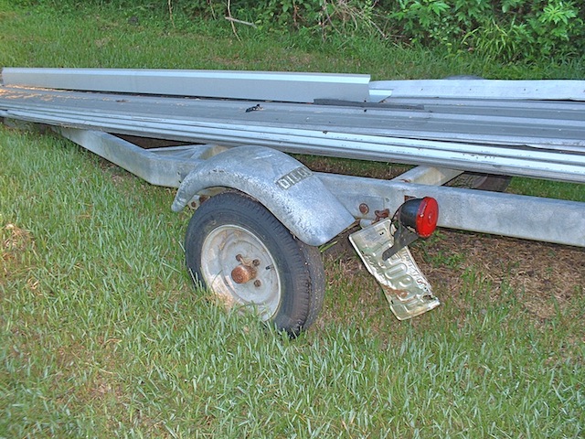

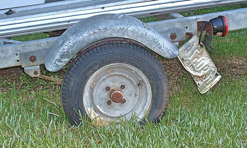

Just for a reference , here’s a pic of the trailer as I got it ... all cleaned up now but the geometry is still the same ... those are the 13” tires ... 93912

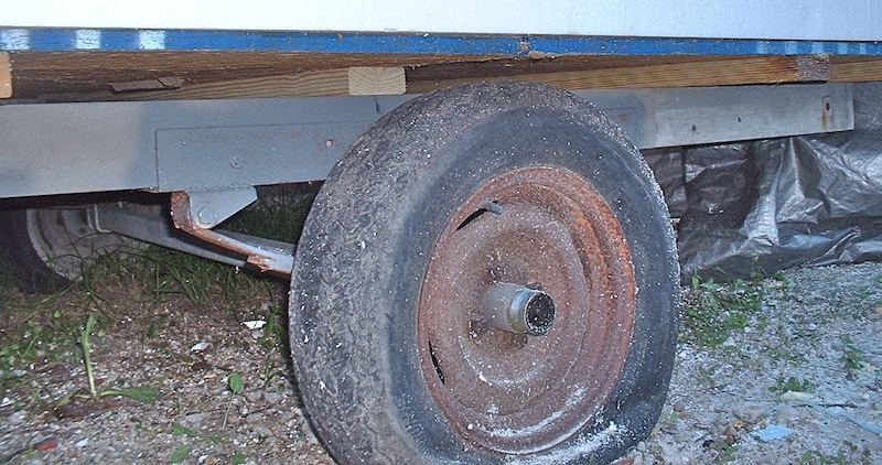

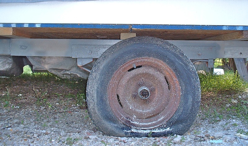

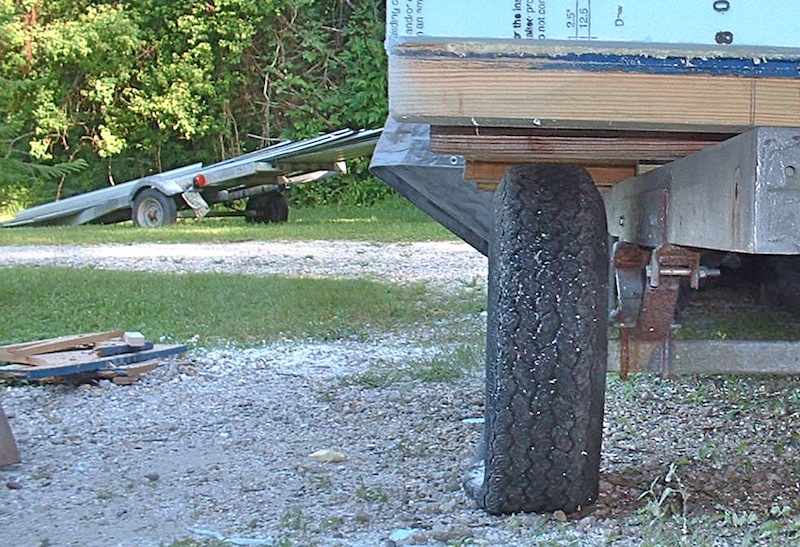

And here’s what we’ve got right now .... Yet to add the black nasty stuff till the canvas is glued under... You can see how Nasty that tire is ... :frightened: Note the small clearance between tire and floor ... :o

Postby Wolffarmer » Thu Jun 27, 2013 7:19 am
Hmmm. Does not look like you will have much clearance there. And the axle is already below the springs. Might have to consider having a spacer welded on to the axle and longer u bolts. Even going down to 12 inch tires will not give much more room. And really I would stay away from "pop Up " trailer wheel/tire set up. Just something about those tiny wheels is just wrong to me.

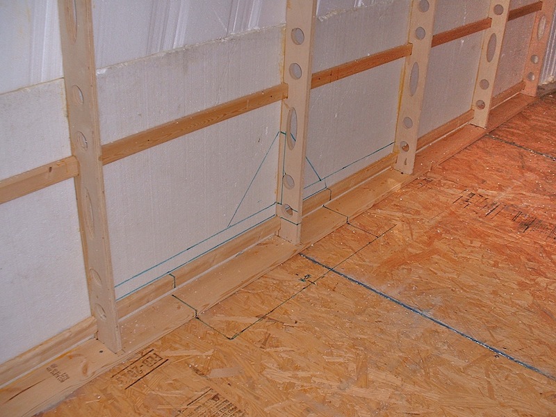

So I went inside and marked off the Rough dimensions of how a wheel well would fit .. giving a generous measure to the width (24” , wider than the tire ) and all the way to the trailer frame , and drawing in some suggested bracing for when this is cut away ... Not really that big or intrusive , doesn’t interfere with the Mini-Galley .. and we gain another 4.25” + the inch we already have ... That should be plenty huh ?
