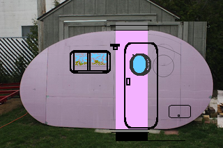

GPW wrote:sorta' like this ???? Image
May be possible to use a standard trailer door ... another possibility , solves a few problems and you get a screen door too .. :thinking:
While that is certainly an option, I was hoping to get a little smaller than the one I have now. So if I leave it at 10' long, and just squish the height down to 5'... well I have to draw that up in cad to see if I like it.
Postby GPW » Wed Apr 27, 2011 5:19 pm
Mike , I thought it was Cool like it was.... but we have to keep the wives happy ... :roll: I fully understand how that is ... ;)
Always interested in what you come up with ... :thumbsup:
