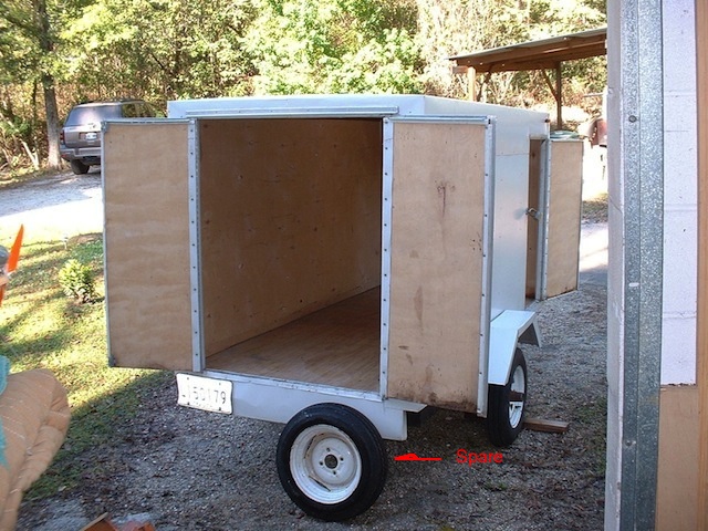

Postby GPW » Thu Jun 27, 2013 5:28 pm
Looks like I found a spare tire too :dancing .... The CT is still sitting ... doesn’t need a spare tire if it doesn’t move ... ;)

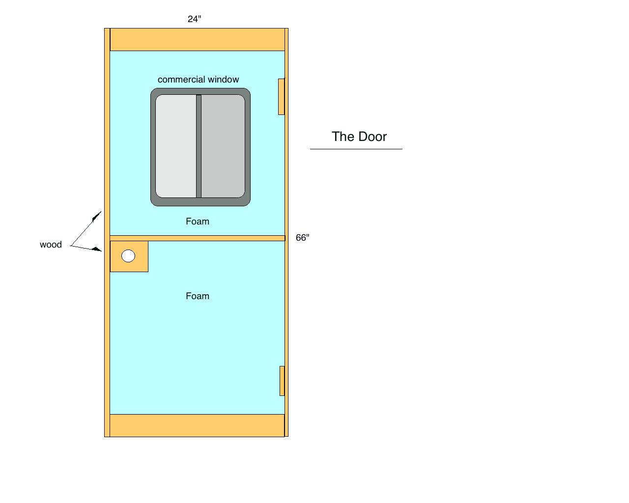

Postby GPW » Thu Jun 27, 2013 5:48 pm
The door plan ... Maybe I posted this before .... my brain is fried !!! Out in the Hot sun too much ... :sweaty:
Have to run over to Vinnie’s to rip some exact 2” wood ...
Ps. the door will get a canvas skin too ... ;)
