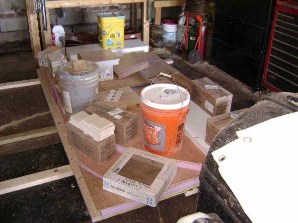

Here are pics. Frame was a few days ago and the rest of the work was today.
[img][img]http://www.tnttt.com/gallery/image.php?image_id=78335[/img]
End of day one.
Pat G

Postby stomperxj » Thu May 05, 2011 10:48 pm
What kind of glue did you use to bond the wood and foam board?

what size and type of wood are you attaching to the foam? is that just for the inside and planing the canvas/glue "skin" on the outer as discused in the foam construction thread? or are you using the wood on the outer?

Postby pat g » Fri May 06, 2011 7:34 am
The glue is titebond II. The plan as of this minute is that the assembly will be mechanically attached to the floor with screws and glue. I am thinking of using a few spars to stiffen the structure. The outside will be covered with canvas, ala Eagle, glued and wrapped under the floor to create a monolithic structure as has been discussed on the thrifty thread. Underside will be protected from the elements with asphalt fence paint from Tractor Supply.

Postby eaglesdare » Fri May 06, 2011 7:45 am
are you plannning on a galley? we used a 1/2 wall (wood), that 1/2 wall really makes the 2 sides sturday. we also used a few spars, and there is a strip that runs down from front to back, that is screwed/glued to floor. and the foam is attached to the wood. just letting you know how we did mine.
the reason i am mentioning this again is just to reinforce the issue about some wood supports. when the guys came out to do our build, they showed me how flimsy it was with just foam. they showed me how sturdy it was with those small amounts of wood. you won't need a lot, but some here and there makes a whole lot of difference.
great to see the canvas being used. once your tear is wrapped in that you will see just how strong it is. i can't wait to hear what you have to say about this.

Postby swampjeep » Fri May 06, 2011 12:32 pm
eaglesdare wrote:the reason i am mentioning this again is just to reinforce the issue about some wood supports. when the guys came out to do our build, they showed me how flimsy it was with just foam. they showed me how sturdy it was with those small amounts of wood. you won't need a lot, but some here and there makes a whole lot of difference.
just curious, when these guys showed you how "flimsy" the structure was, did yu ahve the outer skinned already, remember "the strength is in the skin" LOL
I'm actually thinking that when (or if) I get to build mine, I will try using 2" foam for the galley walls too, I bet that would stiffen the sides alot even before adding the skin, but I will add the skin too. I'm even thinking of a foam core floor, I had a trailer frame last summer that still had the flooring of the original camper, it was 3/4 or 1 " foam, with an aluminum skin on the bottom, and a 1/4" plywood on top, the flooring was plenty strong to stand on. I want to do this for insulation, I do some fairly cold weather camping a couple times a year.

Postby swampjeep » Fri May 06, 2011 2:05 pm
well, I have no doubt that just the 2 outer walls attached to the floor would be flimsy, and that looks like where they were when they talked Eagle into adding the wood wall for support. That is based on this pic (below)
please don't get me wrong, I don't see anything wrong with that, but I do think a foam wall would have added enough support to stiffen it up, especially once the skin is done.

Postby pat g » Fri May 06, 2011 9:41 pm
Hey Swampjeep,
Wonder what your brother would think if he came for his trailer and it had a teardrop sitting on it.
I think you are right about how stiff the foam can make a structure.
Today I attached the sides to the floor and added about half of the roof. I decided to try out the construction adhesive made for foam by Locktite. Seems OK but the Gorilla glue might have been better. I'll let you know how well it holds after it is completely cured. I'll be adding more pictures tomorrow or Sunday. The point is, with just half of the roof added, the structure is starting to feel rigid without the benefit of the skin yet.
