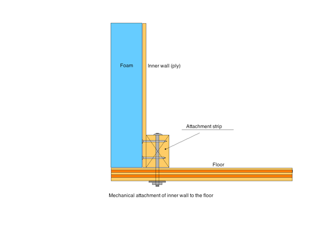

W2, I was thinking of something like this as an alternative ... lots of mechanical fasteners...

Postby Wobbly Wheels » Thu May 19, 2011 5:09 pm
That would indeed be a pretty skookum way to attach the walls, given all that glue area between the foam and ply to spread the loading.
For better or worse, I'd like to eliminate fasteners wherever possible and incorporate the floor into the monocoque rather than having the shell attached on its own to the floor. I'm going to be pulling it up logging roads with my 4cyl Ranger, so I don't want to be hauling anything extra in the trailer....especially if I'm packing camping/hunting gear for a week's boondocking as well. Overnight trips are fine
I think I'm going to build a SIP-style floor (foam with cladding) and build the shell off the trailer - and if it's light enough I can just keep rolling it over to get 'er done !
That will let me start making foamie 'snow' AND keep using the donor tent trailer through the summer. Woohoo, win-win for me !
I figure I'll either miter or lap the floor/wall joint to maximize the foam-on-foam gluing area, then do the layup as tabs in and out and sheathing over everything on the outside. Once the shell is complete, I think the interior tabbing would become redundant...but they don't weigh anything so it's ok.
