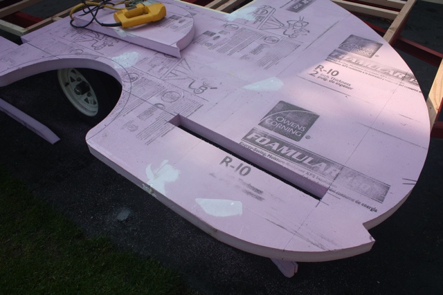

Postby mikeschn » Sun May 22, 2011 12:58 am
Sometimes it good to sleep on these things. I now have a new idea for mounting the walls to the floor, that puts the walls into compression.
I'll start by gluing a 2" key to the sides of the subfloor. Then I'll cover the subfloor with 1/2" plywood. Next I'll cut a hole in the sidewalls equal to the size of the key and plywood. I'll slip the sidewalls over the keys and set them on top of the floor. Voilà! Compression!!!
P.S. If you can't picture that, swing by later, when I have some photos for you to look at!

The way i see what you are doing sounds good, basically you will be making 2" slots in the foam and putting 2" keys on the floor. Maybe you 2" keys could also be cut at differing angles so the act like dovetails. Angles one way screwed to the frame first with a matching slot and then others angled the other way screwed on after the foam is on into thier matching slots. It would still need a lot of slots so most of the forces are compression but the whole thing could key together nicely.

Here's the key on the side of the subfloor...
and here's the hole in the foam for the key...

Great cutting Mike, that may well work

That key and slot is pretty ingenious!!! :thumbsup: do you plan on covering the inner wall first ? Seems that would only make it stronger spreading the load ... Great solution Mike !! IMHO...
