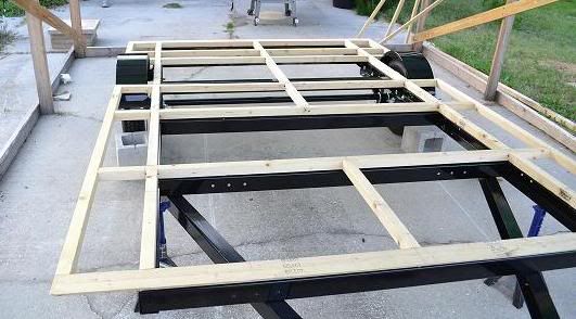

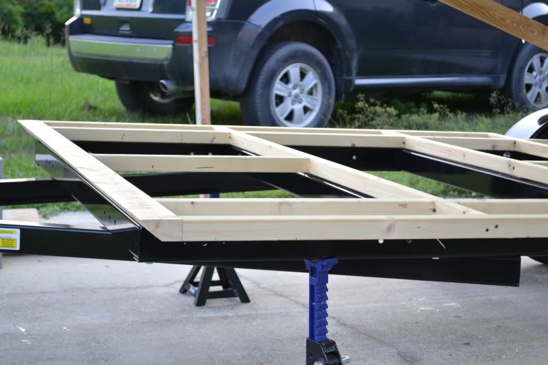

Most of the stuff that we have done so far is the trailer and floor build. I won't bore you with a bunch of pictures of that. We should start on the foam today so I will post more pictures as we progress on that.
Here is a few of the floor.
Sub Floor

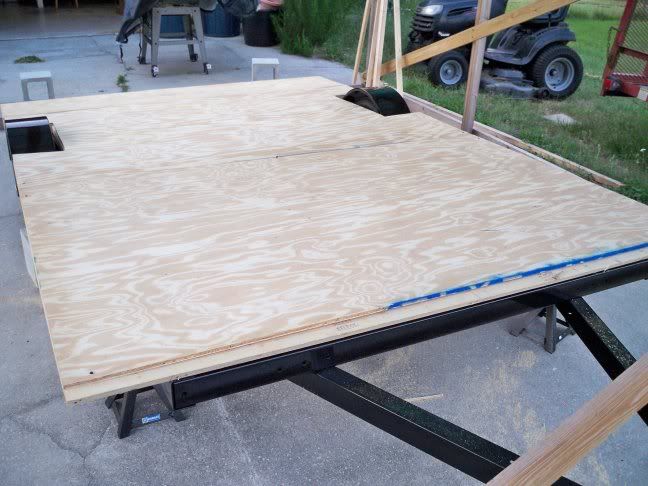

Both the front and back has an angled cut to match the angle of the foam.
The Floor

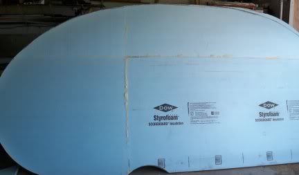

Postby Anita Rae » Thu May 26, 2011 7:21 am
I snapped a quick pic of the sides before I head off to work today. Here ya go!

Postby eaglesdare » Thu May 26, 2011 7:24 am
ahhhh i like the shape. you make me laugh, i had the same problem cutting my lines also. i end up cutting the top line, i figured i could always sand down to the correct line. :lol:

Postby Anita Rae » Thu May 26, 2011 3:52 pm
eaglesdare wrote:ahhhh i like the shape. you make me laugh, i had the same problem cutting my lines also. i end up cutting the top line, i figured i could always sand down to the correct line. :lol:
:lol: Yeah! I know! :lol: We talked about it last night and decided to cut it down to the lower line. It looks a little flat on top. We are using a pattern (Terra Cruiser) that we fond here on the board but we made a few minor changes to make it fit the floor that I messed up the measurements on. Anyway, that is close to the final shape. I still have some trimming to do and I have to make all that glue disappear that seeped out under my tape. Then we can move on.
