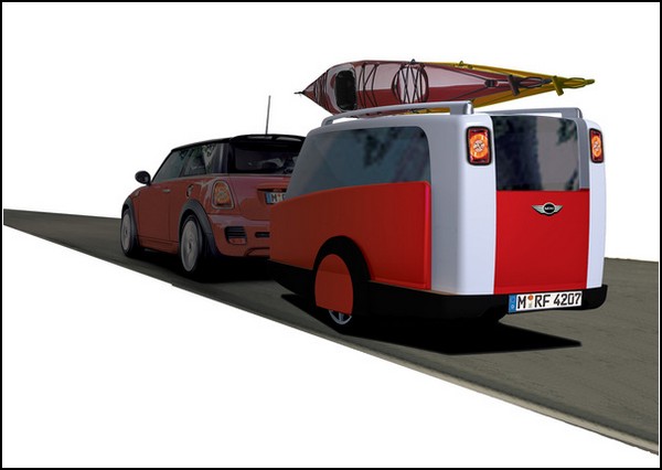

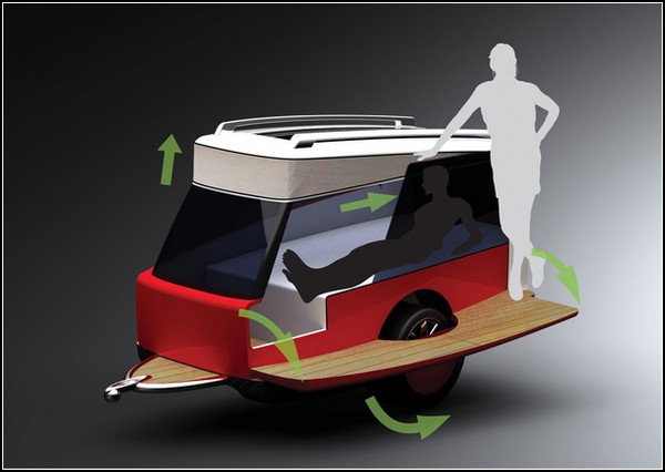

[img]http://www.tnttt.com/gallery/image.php?image_id=79233[img][/img]
