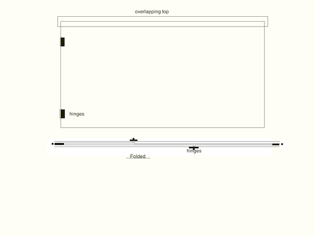

Squatch , I still think you’re on to something here and should experiment further ... I can see (visualize) some hinged walls , and a top as you’ve shown ... Better to think more about it than throwing Money at it ... :o
Here’s an idea ... FWIW Image
From what I can see the diagonally opposed hinges would have to be , two inside and two outside , depending on your hinges ...
