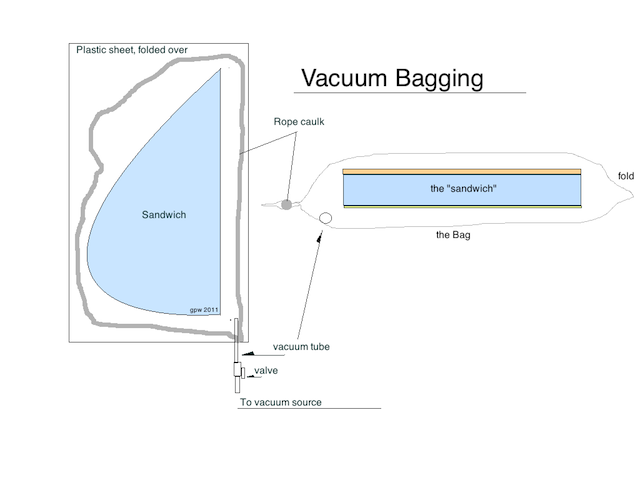

Postby GPW » Fri Dec 16, 2011 9:10 am
OK, I couldn’t help myself and made a drawing of simple vacuum bagging setup we’ve done in the past for airplane wings and small boat hulls ... Pretty Easy , very secure bonding all over ... :thumbsup:

Ok, now I want some more info on the vacuum bag thingie. Would a regular shop vac work for the compression? I had thought about using the meat tenderizer with compression to press the GG into the foam for a better bond. Would there need to be some sort of release layer to keep the plastic from sticking to the sandwich.
Inquiring minds want to know. Oh, and how long is long enough to leave the thing compressed?
A tutorial would be great! :thinking: :thinking: :thinking:

Bonnie , ever see those “Space Bags “ on TV , vacuumed by a shop vac... same principle ... Once you get a good vacuum , just close the valve and let it sit and cure ... usually overnight with epoxy ... the vacuum does NOT run all night ...
Gorilla glue should work fine if not watered too much ... :roll: a simple vacuum gives an enormous amount of pressure .... Even pressure all over , where buckets and weights do not ... ;)
We were taught vacuum bagging by a gentleman who made the large fiberglass figures for the Disney hotels in Orlando ... some time ago ...

Vacuum bagging is easier than you think and it works great:
All you need is a shop vac, packing tape and some 4mm plastic sheet. I wouldn't use gorilla glue as it takes too long to dry. Titebond 2 has a 30 minute clamp time so we ran the vacuum for 60 minutes. Just use packing tape to make the bag.
