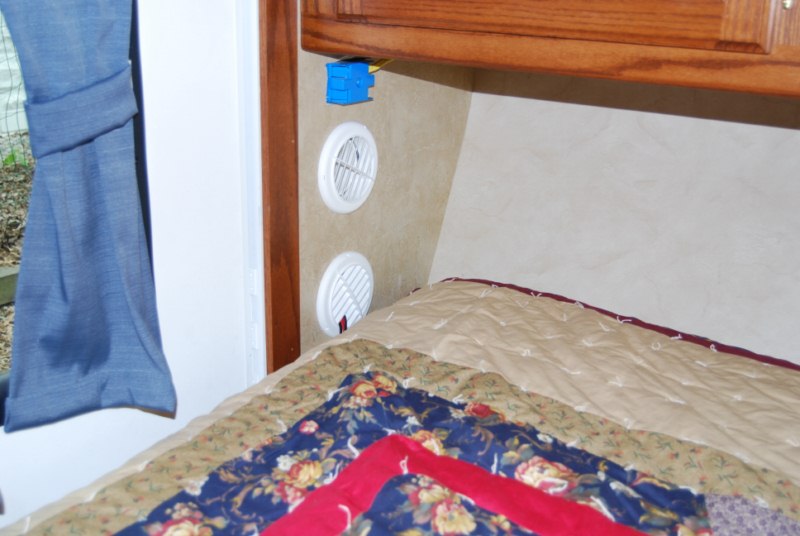

I used the original thermostat, removed and installed in a small Radio Shack project box along with an on off switch. The control wires go through the outlet hose. And yes it is almost silent even with the bilge blower.
Yes a water proof hatch can be made for direct mounting or you could use a marine deck hatch. The advantage of ours is it is two 4" holes and the AC unit has withstood a rain storm with no problem and no leakage.

Nice install. Do the 4" external duct plugins connect to any interior ducting, or just terminate through the interior? I hope my question is clear.
I wanted to look for possible RV ducting that has more of a flat shape so that it could be sandwiched between the walls. Haven't researched this yet, but was curious about your install.

Yes there is no additional ducting on the inside, I used a conventional Rv louver on the inside, you can see the control wire sneaking through the lower one.
This in conjunction with the vent fans with vent closed circulate the coolth nicely.
There is a short length of pipe coming from the RV duct flange that actually had to be shortened to mate with the deck plate and I silicone caulked the slight mismatch in size so there is a seal. I used PVC pipe fitting that just fit inside the hose and wall opening and used some closed cell neoprene glued to the outside of the PVC reducer that inserts into the camper to give it an air/water tight seal.

Thanks for the photo of your interior outlets! Wonderful!
